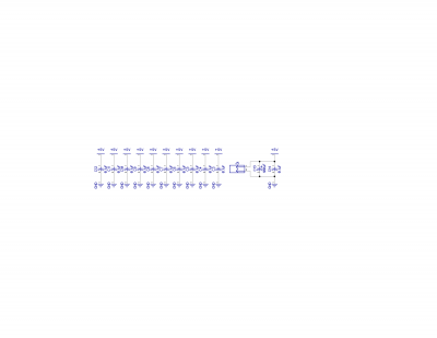

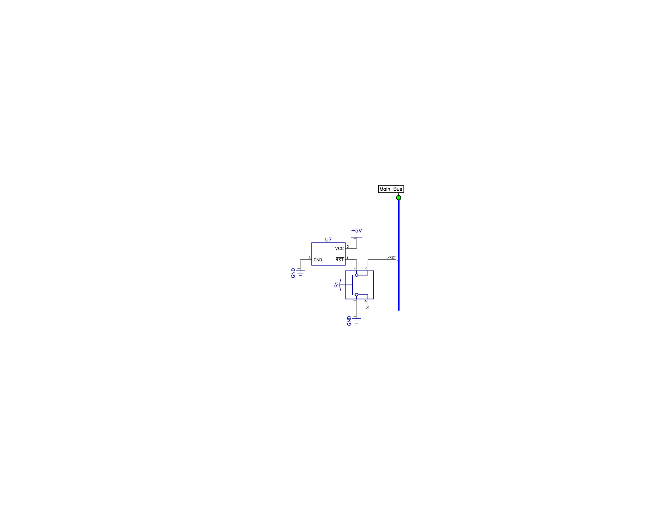

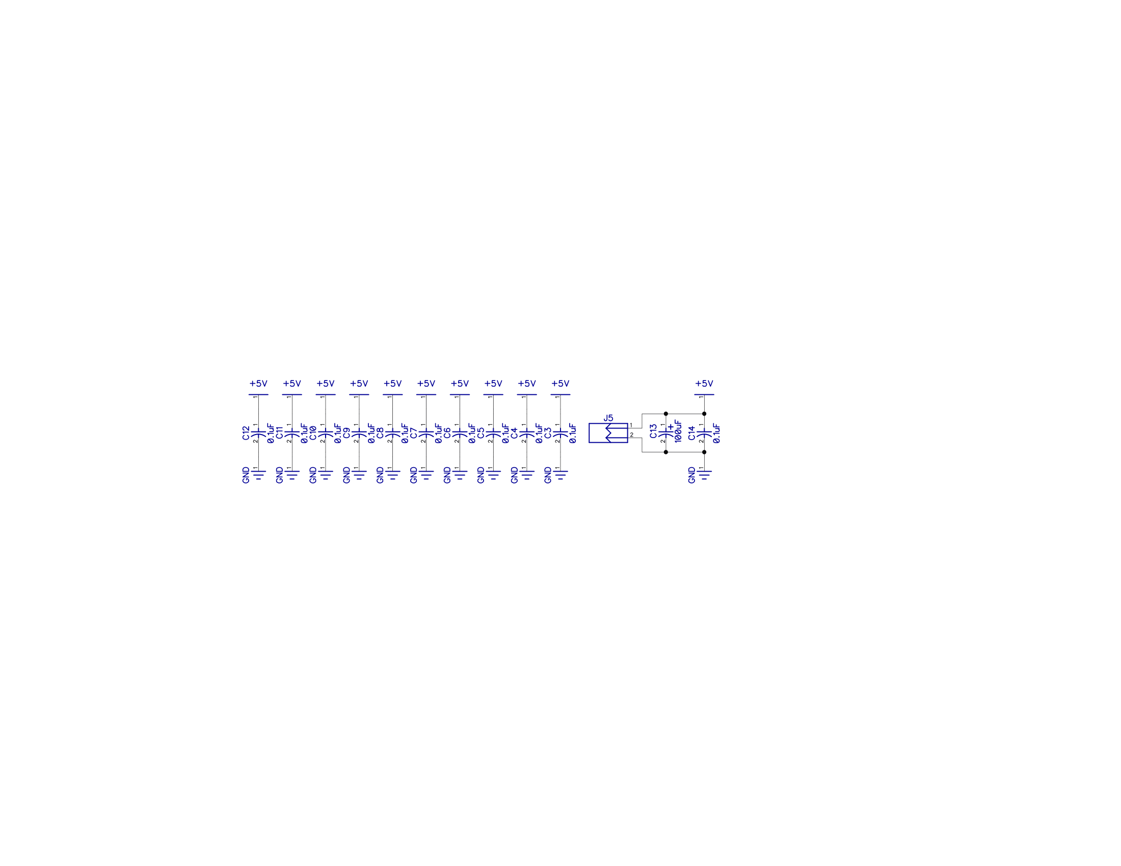

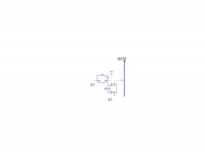

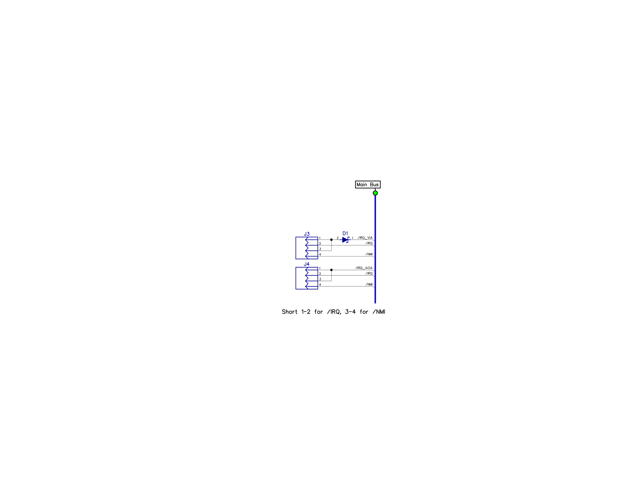

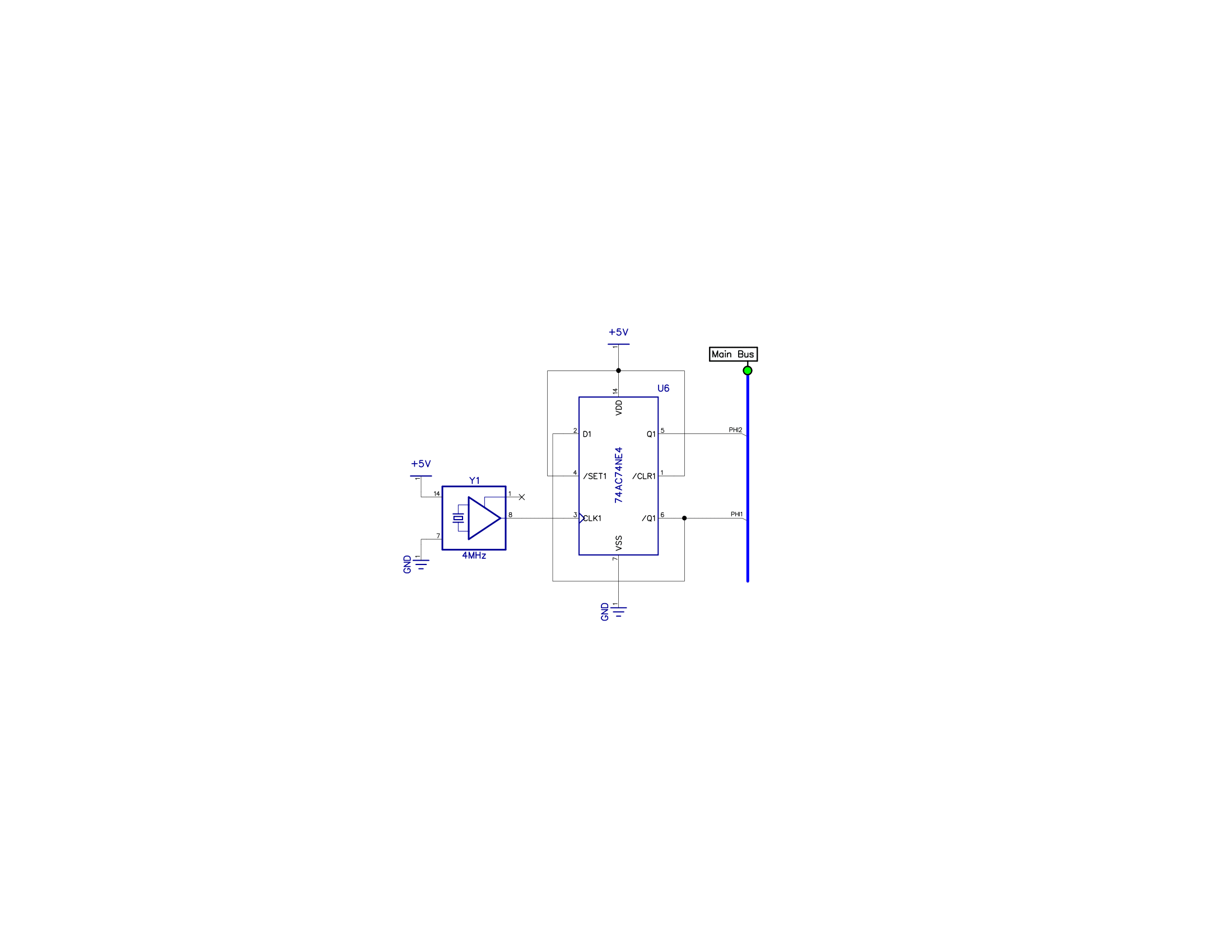

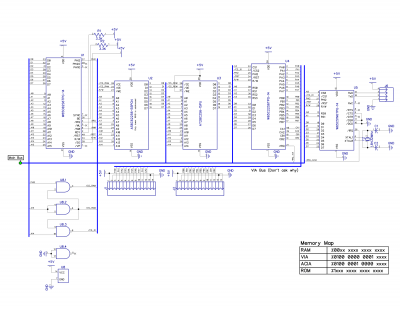

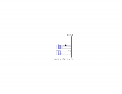

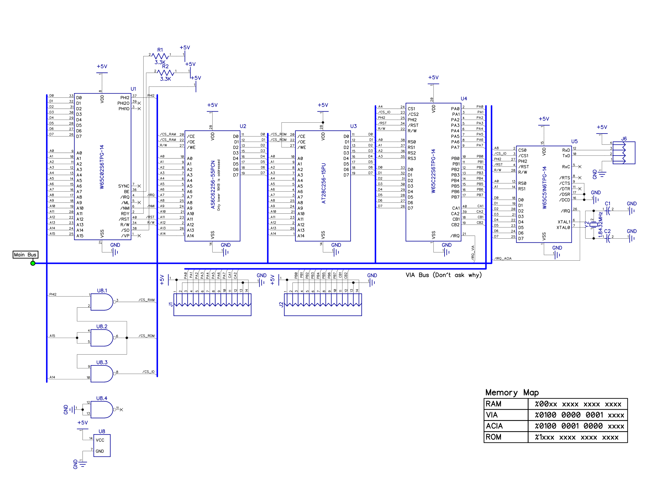

I have finally finished my first presentable schematic (all the others looked even worse)!
I am going to present the design to my mom and dad (who are CS and EE majors respectively) later but I would love input + criticism (especially criticism) from anyone who has time.
Main Schematic:
Clock Gen:
Reset:
Interrupt:
Power + Bypass:
- Billy

Posts: 8774
Re: Finally starting the schematic for my first W65C02 SBC
The OE\ of the RAM needs to go to A14 so the RAM won't output data when you're trying to read I/O.
WDC recommends adding a 1M resistor from pin 6 to pin 7 of the ACIA.
With a short look of a few minutes, I don't see any other problems.
billylegota
Posts: 60
Joined: 31 Mar 2016
Location: Austin, Texas
Post by billylegota »
Ahhh, the logic I had only checked to see if A15 was low (/CS and /OE was (A15' & PHI2)') so I need to connect A14 to /OE.
On that note, won't I need to do something about /WE on the RAM as well? As it stands /WE on the RAM is connected to R/W on the W65C02, which if I am correct will allow the RAM to be written to when A15 is low regardless of the state of A14 (unless I am wrong and /OE and /WE must be low in order to write). This really doesn't matter right now because it would be writing to the upper half of the memory (which can't be read) but I do have an extra gate on my 74AC00 which I could use to prevent this.
- Billy
Posts: 8774
Writing to the upper half of the RAM when you're writing to I/O is fine. You're not using that portion of the RAM, so overwriting it is ok. It doesn't even add any extra load to the bus. It's not a problem and there's no need to fix it.
Posts: 9428
Future note: gating chip selects (e.g., /CS on the ROM) with Ø2 is not a good idea if performance matters. The address bus becomes valid during Ø2 low on all 65xx MPUs, at which time chip selection should occur. The idea is to have the device ready for access as soon as Ø2 goes high. Commensurate with that is that /RD and /WD should be gated by Ø2 so those signals don't go true (low) until Ø2 is high. If using a 65C816, it is essential that no device be allowed to write to the data bus during Ø2 low, as that is when the '816 drives the data bus with the bank bits (A16-A23).
In the case of 65xx peripherals (65C22, etc.), Ø2 from your clock generator should be directly connected to Ø2 on each 65xx peripheral, RWB on the MPU must be connected directly to RWB on the 65xx peripherals, and chip selection must occur during Ø2 low and be maintained until the next fall of the clock. A failure to meet those conditions will result in a failure to operate when access to a 65xx peripheral is attempted.
WDC recommends that all timing be relative to the Ø2 clock, and that the Ø1 out and Ø2 out signals (pins 3 and 39, respectively) not be used. Here is their advisory on the matter (page 10 in the data sheet):
  • An external oscillator is recommended for driving PHI2 and used for the main system clock. All production test timing is based on PHI2. PHI2O and PHI1O were used in older systems for system timing and internal oscillators when an external crystal was used.
Ø1 out and Ø2 out exist primarily to allow a 65C02 to be fitted to a system that was designed with an NMOS 6502. Both signals slightly lag Ø2 by an unspecified amount, which in a high speed system, may result in difficult-to-resolve timing issues. WDC neither tests or guarantees the timing of those signals.
