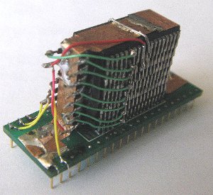

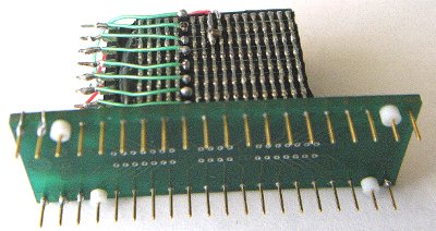

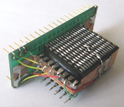

Oneironaut wrote:
Once you solder the 4 bent legs, the IC is pretty well affixed since it seats nice in the socket.
Have you had any trouble with legs breaking off when you "straighten" them? They always seem to be pretty fragile.
My first effort at a 4Mx8 SRAM module was to straighten out the SOJ pins like a DIP's pins and stack them, as shown below. I was careful of course but sensed no tendency for them to break. (This one had a '138 stuck on the end.)
The module I actually ended up with takes even less board space.
banedon
Posts: 742
Joined: 08 Sep 2013
Re: Speed & EEPROMs
Post by banedon »
Does the wide metal strip which goes length ways over the entire stack function as the common ground?

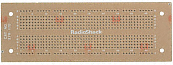

Re: Speed & EEPROMs
Yes, it's adhesive-backed copper ribbon I got a roll of at a swap meet many years ago, cheap, that I use to hold the ground inductance to a minimum. It's not for shielding. I also put it down the length of solder-type breadboards like this one,
down the middle, on the solder side, between the ICs' rows of pins, since that area is usually empty, to give them a shorter connection to ground than they would get by going out the the strip at the edge, and to give them a lower inductance in the ground connection between ICs even at opposite ends of the breadboard, if it's a kind of circuit where it would matter.
6502.org wrote:
Image no longer available: http://demandware.edgesuite.net/sits_pod26/dw/image/v2/AASR_PRD/on/demandware.static/Sites-radioshack-Site/Sites-master-catalog/default/v1425184152678/images/02760170_00.jpg?sw=350&sh=350&sm=fit
I thought it might be something like that (rather than for shielding) - definitely a good idea. I'll have to have a mooch around Farnell or Mouser to see if they have any.

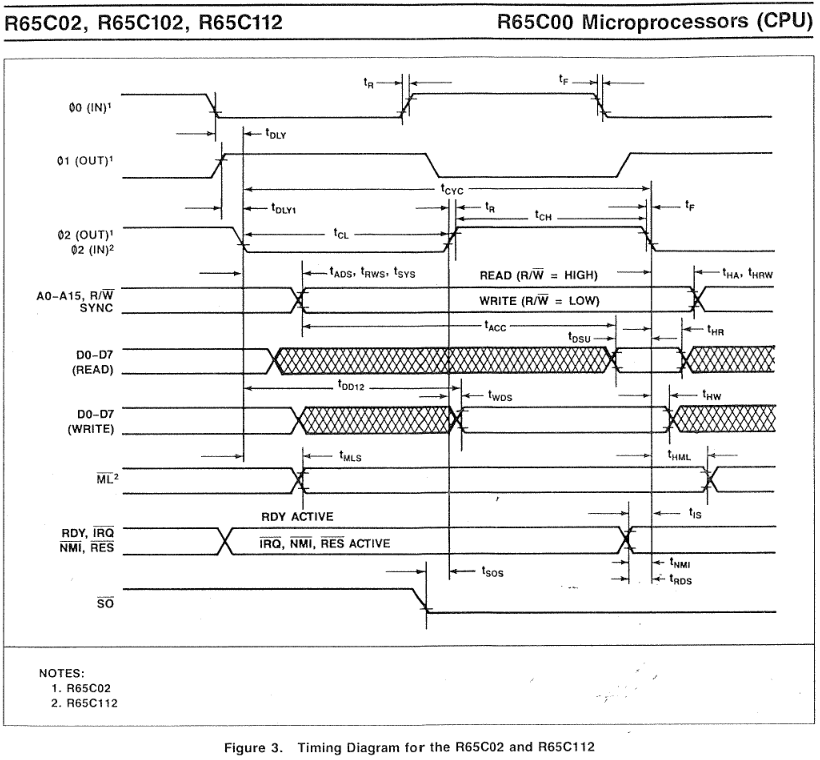

ttlworks
Posts: 1464
Joined: 09 Nov 2012
Re: Speed & EEPROMs
Post by ttlworks »
Sorry for unexpectedly bumping in: I just noticed an old posting about PHI2 and WDC parts
when following Jeff's link in the Newbie's section of the forum:
In other words, WDC does not recommend the use of PHIO1 and PHIO2 in new designs.
You should also consider the fact that PHI1O and PHI2O lag Ø2 by an amount that is not specified.
To be more precisely:
In the datasheets of most of the 6502 manufacturers, bus timing is specified relative to PHI20,
the PHI2 clock output of the CPU.
Maybe the delay from PHI0I to PHI1O and PHI2 is mentioned, maybe not...
For instance, the Rockwell R65C02 datasheet, page 12:
http://archive.6502.org/datasheets/rock ... essors.pdf
Now to take a look at a W65C02 datasheet from WDC, year 2000, page 25:
http://archive.6502.org/datasheets/wdc_ ... r_2000.pdf
In this datasheet, the bus timing is relative to "PHI0I", the clock input of the CPU,
which went renamed to PHI2 by WDC somehow...
BTW: the datasheet from 2000 says max. 22ns propagation delay from clock input to clock outputs,
in the W65C02S datasheet from 2013 this little remark about the delay is missing on page 26.
http://archive.6502.org/datasheets/wdc_ ... 7_2013.pdf
At 20MHz, 22ns would be nearly half a clock cycle.
Conclusion:
For non_WDC CPUs, use the PHI2O output.
For WDC CPUs, you better stick with the clock input to avoid trouble.
Depending on the chip manufacturer, "PHI2" ain't always 'PHI2'.
