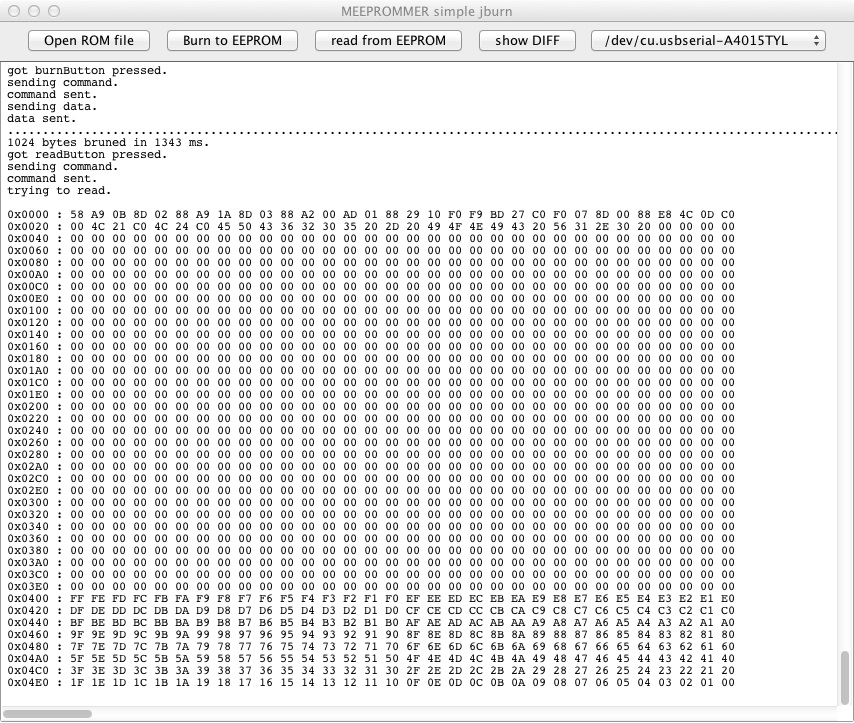

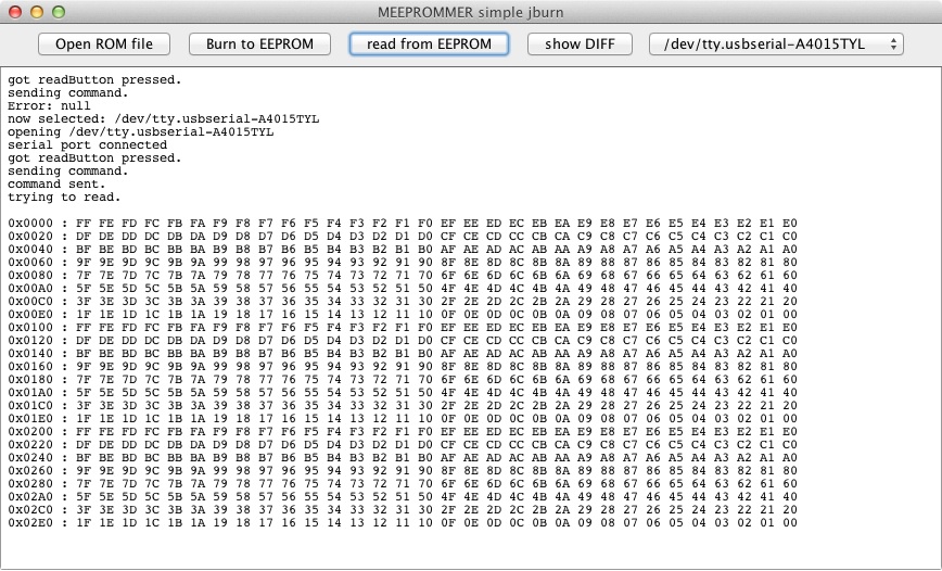

The next small step is done. I have a small Java GUI client to that is able to talk to the programmer:
At the moment I can
- load a ROM file (max. 32k) into the GUI client
- burn the first 1024 bytes of the loaded data to the EEPROM (hard coded)
- read and show the data from the EEPROM
- select the serial interface that should be used
I'm working with a fixed baud rate of 19200. There is no code to send several "chunks" of data to the programmer. So only 1024 bytes can be written from 0x0000 to 0x03ff at the moment, because it's hard coded on the GUI and also on the Arduino side. But it takes only 1.3 seconds to send and write the 1024 bytes to the eeprom. Increasing the baud rate it could be even faster (tested with 57600, it runs with 980ms). So the complete 8k of my current ROM image can be written in about 10 seconds.
The second picture shows the content of the first 1024 bytes of the eeprom after writing my ROM image. All bytes are correctly written ( a lot of zeros at the moment), because all old bytes of my test data (counting from 0xff to 0x00 every 256 bytes) are replaced by the image content.

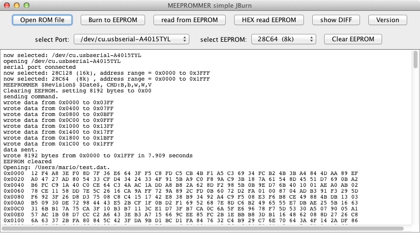

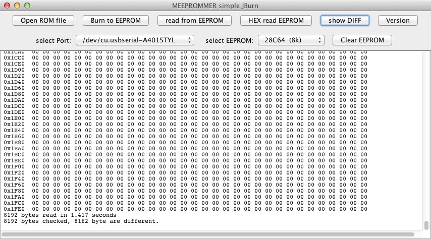

Here's a short collection of screenshots from the GUI:
GUI after start, selecting different EEPROM types, getting Version String, clearing EEPROM and loading a 8k ROM image:

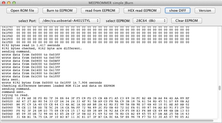

GUI after making a diff between the cleared EEPROM and the loaded 8k ROM image, showing all 8192 bytes as different:

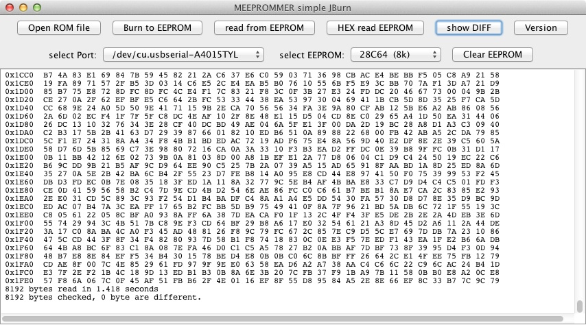

GUI after writing the ROM image to the EEPROM and then making a diff again.
Now showing that all bytes are equal:

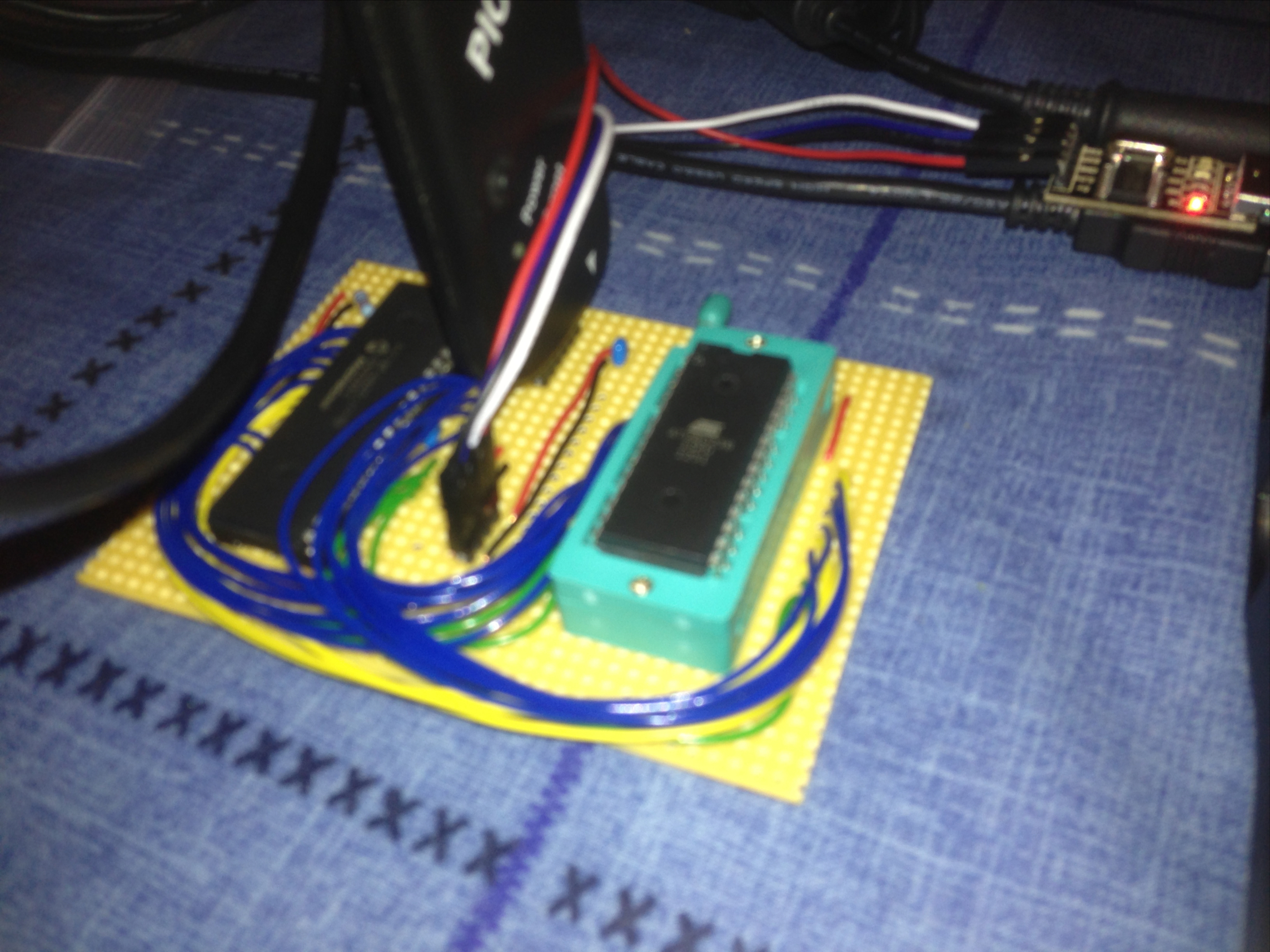

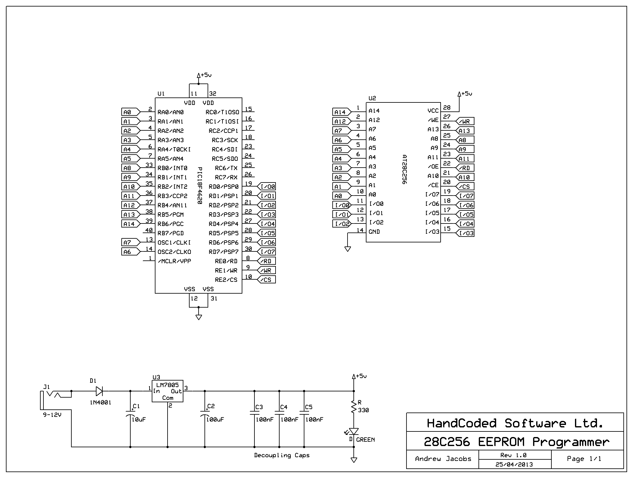

I've not played with EEPROM devices since my first job so I thought I'd go but using my customary PIC chip so I knocked up this big mess of wires.
PIC EEPROM Programmer
It's just a 18F4620 with three 100nF decoupling capacitors. I'm using a PL2303 based USB CDC module to power the board and connect to a PC.
I'm going to knock up a little adapter to allow me to convert an AT28C64 to a 27C32 socket so I can use it to finish writing and testing the firmware for my R6501 SBC.

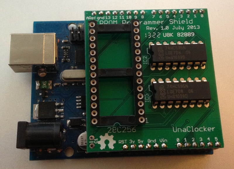

Mario, your work is awesome. I used the schematic you posted to create a shield for a standard Arduino, as I have a bunch of those, and the Nano is obsolete (replaced by the Micro).

Sounds plausible to me but I'm more software than hardware. I've attached my circuit and code. Feel free to use and abuse.
EP-28CXXX (18F4620).zip
The code
(29.32 KiB) Downloaded 608 times
Schematic
Schematic

Got my shields made. Ended up cutting the size of the shields down to get it under the 5cmx5cm limit at SeeedStudio, to keep the price low. I'll test it out this weekend and see if I got it right. If anyone wants the EagleCAD files, let me know, I'd be happy to share.

Really cool. Thanks for your effort. Can you post the Eagle files here? I would like to include them in my MEEPROMMER page. Maybe thre is enough room for a ZIF socket instead of the normal IC socket.

Yeah, there should be plenty of room there for a ZIF socket, I just used what I had laying around when I assembled it. Attached are my eagle files, as well as the gerbers I submitted to have the boards made.
After I confirm this thing works, I'll toss the extras up on Tindie.com for a very low price in case anyone wants to just get one of these that I made.
