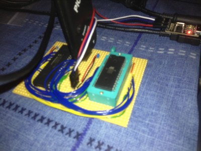

I've not played with EEPROM devices since my first job so I thought I'd go but using my customary PIC chip so I knocked up this big mess of wires.
File comment: PIC EEPROM Programmer
It's just a 18F4620 with three 100nF decoupling capacitors. I'm using a PL2303 based USB CDC module to power the board and connect to a PC.
I'm going to knock up a little adapter to allow me to convert an AT28C64 to a 27C32 socket so I can use it to finish writing and testing the firmware for my R6501 SBC.

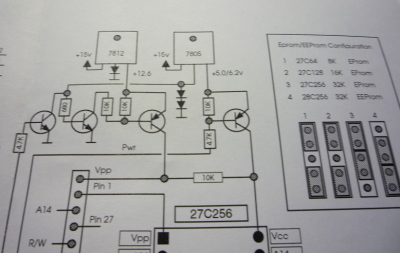

Andrew (BitWise):
It occurs to me that I could duplicate your approach and implement a 12.5v VPP boost circuit, like that on the PICKIT2, and replace my old 68HC11 EPROM/EEPROM burner (27C64, 27C128, 27C256, and 28C256 devices) with a Windows version that runs on a single 5v supply. What do you think?
Cheerful regards, Mike

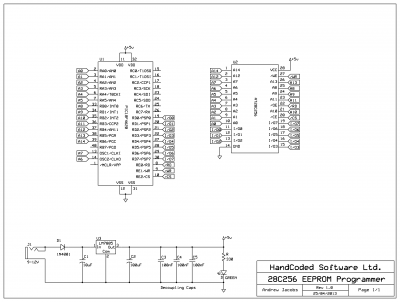

Sounds plausible to me but I'm more software than hardware. I've attached my circuit and code. Feel free to use and abuse.
File comment: The code
EP-28CXXX (18F4620).zip [29.32 KiB]
Downloaded 592 times
File comment: Schematic
