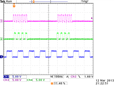

Working on SPI flash interface for CPU now. I'm making a very simple CPU interface with a memory mapped data register. Writing to the data register causes a byte to be shifted out over the SPI interface, and another byte to be shifted in at the same time. Later, I'll also add a read-only register that will cause $FF to be shifted out, and another byte to be shifted in, just by reading the register.
I'm using a 24 MHz SPI clock (main clock divided by 4), and because the CPU clock is 8 MHz, it takes less than 3 CPU cycles to shift a byte in or out. So, basically, the CPU can read serial flash data just as fast as it can access SRAM. Of course, you still need to set up the starting address, but as long as you read, say, 256 bytes at a time, that's not going to cost much.
Here's a picture from the scope (top=data, bottom= clock), as a result of this code:
ldx   #$55
ldy   #$aa
stx   $b110
sty   $b110
A write to $b110 causes the SPI byte to be written, and it's no problem to do back to back writes. I could even map the register in zero page.

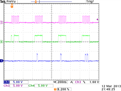

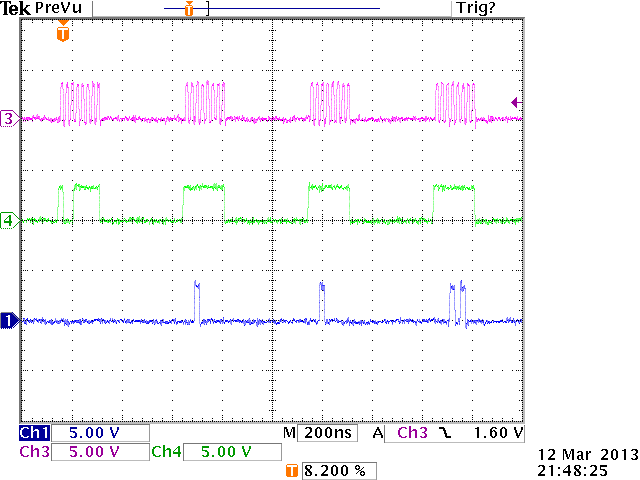

Here's the same thing, but now running with 48 MHz SPI clock. I've added the PHI2 signal for reference. Of course, when the 65C02 is driving the SPI interface, the higher speed is pointless, but it could become useful when the FPGA is driving the flash directly.
Flash is responding to read ID command:
Top trace is clock, middle is MOSI, bottom is MISO. Flash responds with $20, $20, $14, as stated in datasheet. I don't have a CPU interface for read data yet, so this is just hand decoded from the scope screen :)

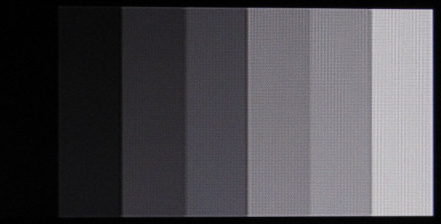

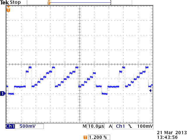

For a quick hack, I've added a simple video output to my existing board. I'm using 3 resistors attached to 3 GPIO pins, and combined the signals into a single output. This signal can be fed into the composite input (or the Y input of the component input), resulting in simple grayscale video. In theory, this could also be used for crude color, but I'll just keep it grayscale.
Of course, it's no substitute for a real video output, but it's good enough to test some designs, including an SRAM video interface. It is also good enough to support some retro graphics/text modes.
Here's a test with grayscale bars.
And the signal on the scope:
As you can see, the steps aren't spaced evenly. I just used a 330 Ohm, 680 Ohm and 1.2k resistor (all 5%), and tried different combinations of '0', '1' and 'Z' outputs to get a few usable levels between 0.3V (black) and 1.0V (white), as well as 0V for sync.

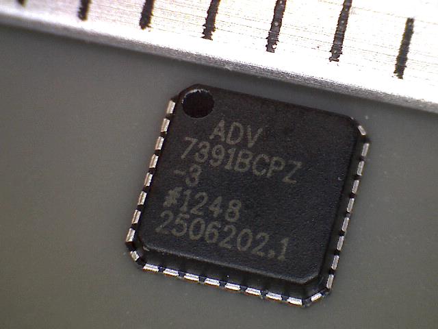

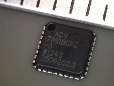

Yes, but it's got a little 'lip' around the side. The leads are accessible from the side, but are also visible on the bottom of the package. I ordered a sample, and took a picture. Behind the chip you can see a ruler with 1/16" markers.
Since the leads extend to the side, it should be possible to hand solder this thing. The only worry would be the possibility of solder bridging two leads on the bottom side of the IC.
Edit: there's also a big ground pad on the bottom of the IC, but I could make a big plated hole under the part so it can be soldered through the PCB. Reflow soldering is also an option, but that would require a stencil. No problem for a small batch of boards, but it makes a single prototype a bit expensive.

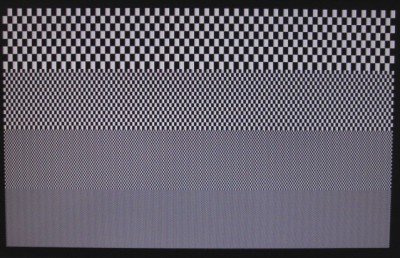

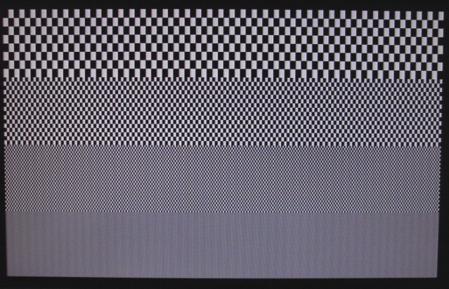

Here's a full screen picture with different checker board patterns.
Resolution is 640x256 pixels, which results in about 2:1 aspect ratio for individual pixels. This is equivalent to the old Amiga high res, non interlaced mode. On an old TV, the bottom band with 1x1 pattern is solid gray. On my new LCD monitor/TV, the individual pixels on the bottom can still be discerned, but you can also see some banding patterns over the screen, probably because the LCD TV is all digital and uses a sampling frequency that's not identical to my pixel clock, resulting in moiré patterns.
For a monochrome bitmap, it would take 20kB for this resolution, which is getting close to what an 8 bit CPU can handle.
