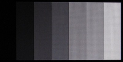

For a quick hack, I've added a simple video output to my existing board. I'm using 3 resistors attached to 3 GPIO pins, and combined the signals into a single output. This signal can be fed into the composite input (or the Y input of the component input), resulting in simple grayscale video. In theory, this could also be used for crude color, but I'll just keep it grayscale.
Of course, it's no substitute for a real video output, but it's good enough to test some designs, including an SRAM video interface. It is also good enough to support some retro graphics/text modes.
Here's a test with grayscale bars.

As you can see, the steps aren't spaced evenly. I just used a 330 Ohm, 680 Ohm and 1.2k resistor (all 5%), and tried different combinations of '0', '1' and 'Z' outputs to get a few usable levels between 0.3V (black) and 1.0V (white), as well as 0V for sync.
