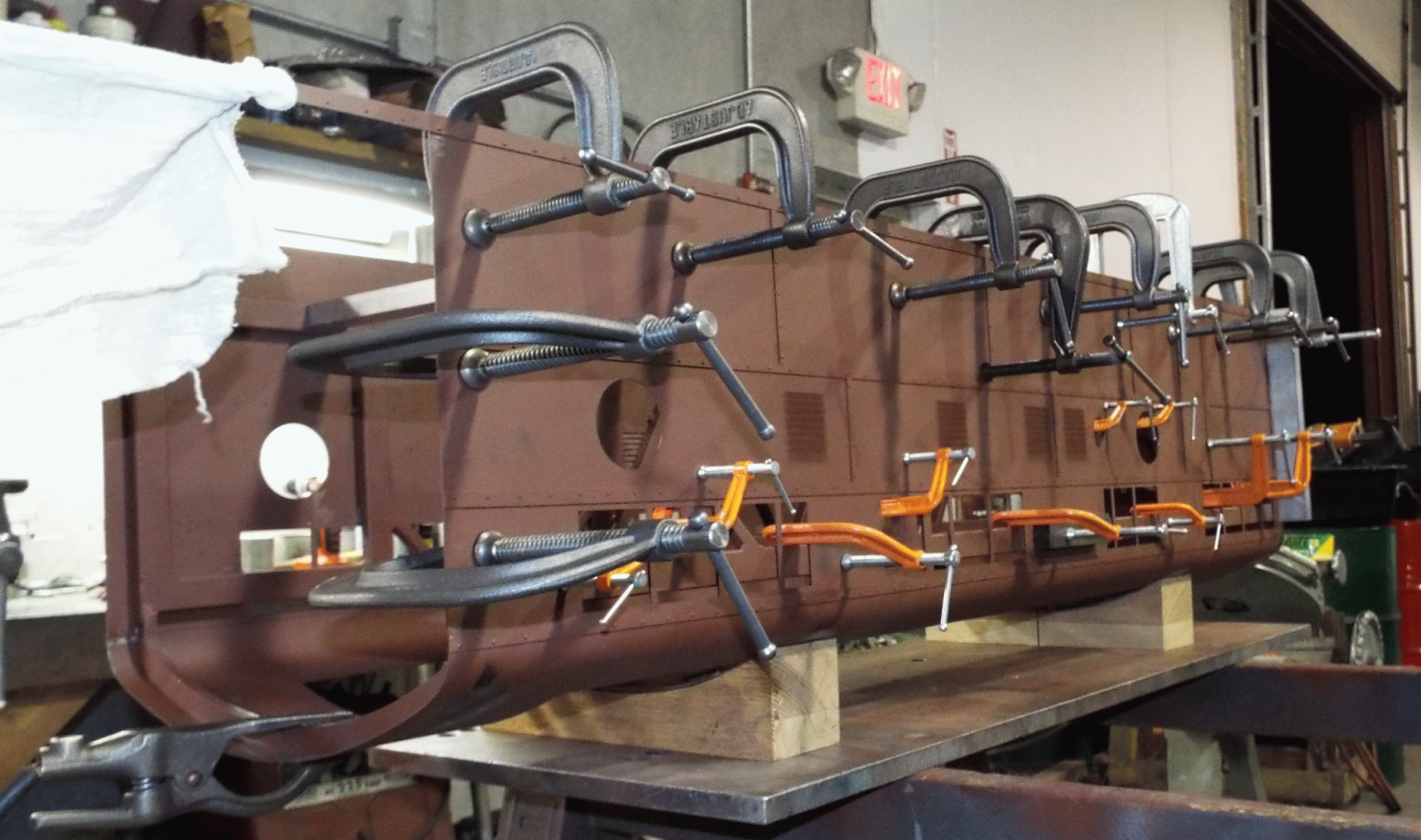

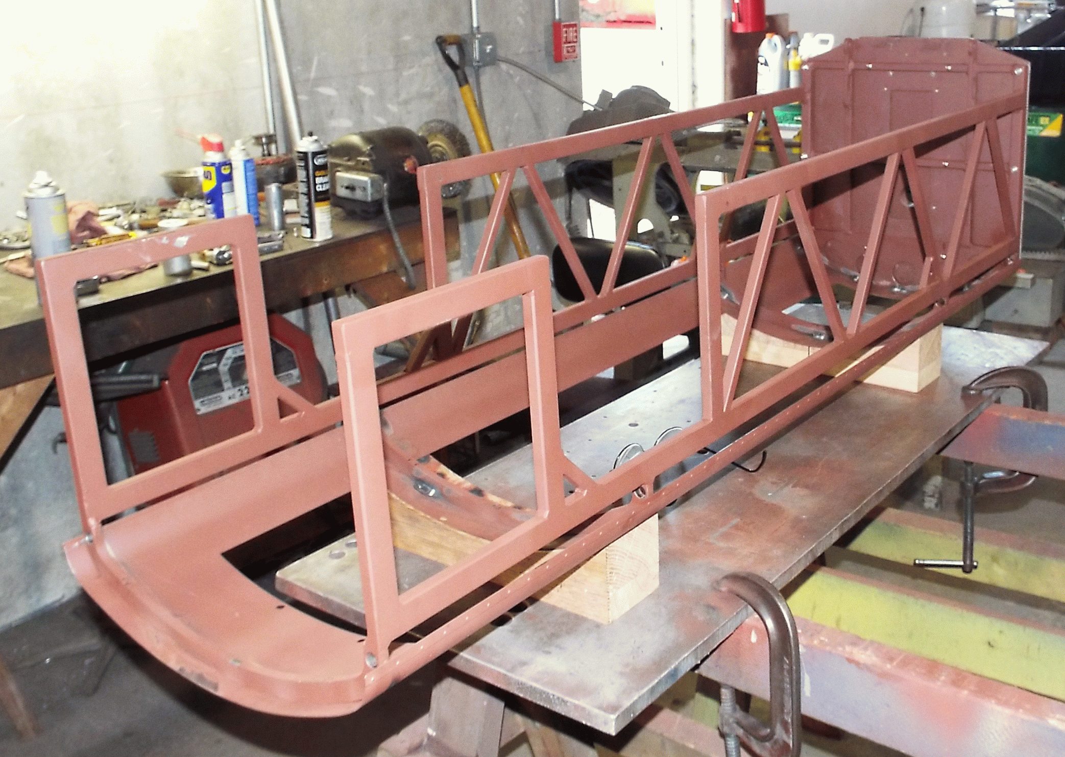

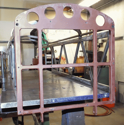

How was the body made BDD?
Posts: 9426
Re: TAKING A BREAK
no traction motors to overheat and burn out
No, but instead the transmission oil heats up and can decompose if it gets too hot.
Yes, that can happen. Modern synthetic oils can better tolerate the heat, but there are limits.
Roughly speaking, a torque converter peaks at about 80% efficiency and a fluid coupling peaks at about 90%;
Actually, a fluid coupling can achieve even higher efficiency. The General Motors Hydra-Matic transmission, which used a fluid coupling and a four-speed gearbox, was claimed to achieve 96-97 percent efficiency in fourth gear. The manufacturer of the fluid coupling in my locomotive claims 95 percent efficiency when running under maximum rated loading and RPM (however, I intentionally overload the coupling to better simulate the behavior of Diesel-electric operation).
The efficiency of a fluid coupling inversely and exponentially varies with the input-to-output speed differential, as well as the absolute input speed—this characteristic is explained here. In contrast, the efficiency of a torque converter resembles an inverted U. Once a torque converter comes out of stall, efficiency rapidly rises until the input-to-output speed differential reaches 80-85 percent. At that point, the return oil flow from the turbine (driven member) to the pump (driving member) significantly diminishes and the stator imposes parasitic drag. Practical converters mount the stator on a one-way clutch so it can rotate with the pump during light loading. The clutch, of course, prevents contra-rotation during the torque multiplication phase.
You'd think that cooling that oil would be easy in, say, Finland, but the ubiquitous Dv12 locos here are restricted to only short periods of heavy shunting duty, interspersed with long periods of cooling off.
Oil-to-air heat transfer is never very good. I've seen solutions in some industrial installations in which the oil is passed through a water-cooled heat exchanger and the water, in turn, is cooled by a conventional radiator. Such an arrangement isn't very practical with a locomotive.
The most obvious solution to the power-handling problem is to increase the number of transmissions involved, directing only some of the total engine power to each.
That, of course, adds complexity and doesn't actually do anything for the efficiency issue. It merely distributes the losses, versus concentrating them in a single unit.
Where hydraulic transmission *does* have an advantage is in power to weight ratio.
At least in North America, that is a secondary design consideration, especially in freight locomotives. As the old saying goes, weight is your friend in a locomotive. The factor of adhesion is strongly bound to the total weight on the driving wheels. Given what we expect from our freight locomotives, builders design to use the maximum possible axle loading that the track can tolerate, typically 70,000 pounds (31,818 kilograms) per wheelset on 141 pound rail.
The bottom line is electric power transmission continues to be the most efficient way to get the prime mover's output to the wheels.
Chromatix
Joined: 21 May 2018
Re: TAKING A BREAK
Post by Chromatix »
You're right, increasing the number of transmissions does nothing for efficiency, but it *does* allow installing more power in a single locomotive than a single transmission can handle.
On the other hand, most European railways have moved to electric traction (with overhead wires and so on) instead of building ever bigger diesel locos. American railways are a weird outlier in that respect.
Posts: 9426
Re: TAKING A BREAK
Along with everything else in the locomotive, I built the body in my shop.
The main part of the body is made from laser-cut sheet steel, with an internal "skeleton" to give it structural integrity. Welded construction is used wherever steel is joined to steel. Here's a picture of the skeleton right after I finished welding and cleaning it.
Body Skeleton
Body Skeleton

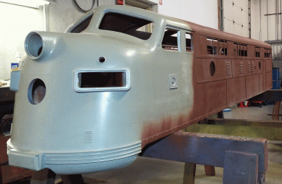

The nose assembly, which is essentially everything from the cab doors forward, is a one-piece Alumilite casting. It is bonded to the rest of the body with PC-7, a high-strength epoxy. Here's a picture of the casting.
Alumilite Nose Casting
Here's are some photos in which I am building up the body in my shop.
Roof Attached to Skeleton
Side Panels Attached to Skeleton
Built-Up Body
Built-Up Body

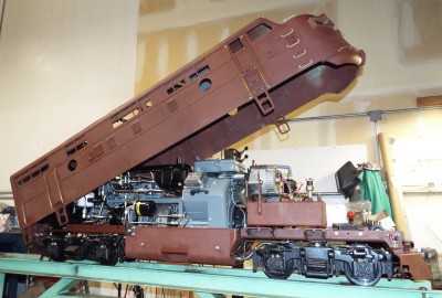

The below photo shows the body mounted on the chassis and opened. As the body weighs around 110 pounds, I used a pair of industrial gas springs to lift and support the body in the open position.
Body on Chassis, Opened

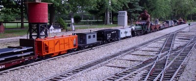

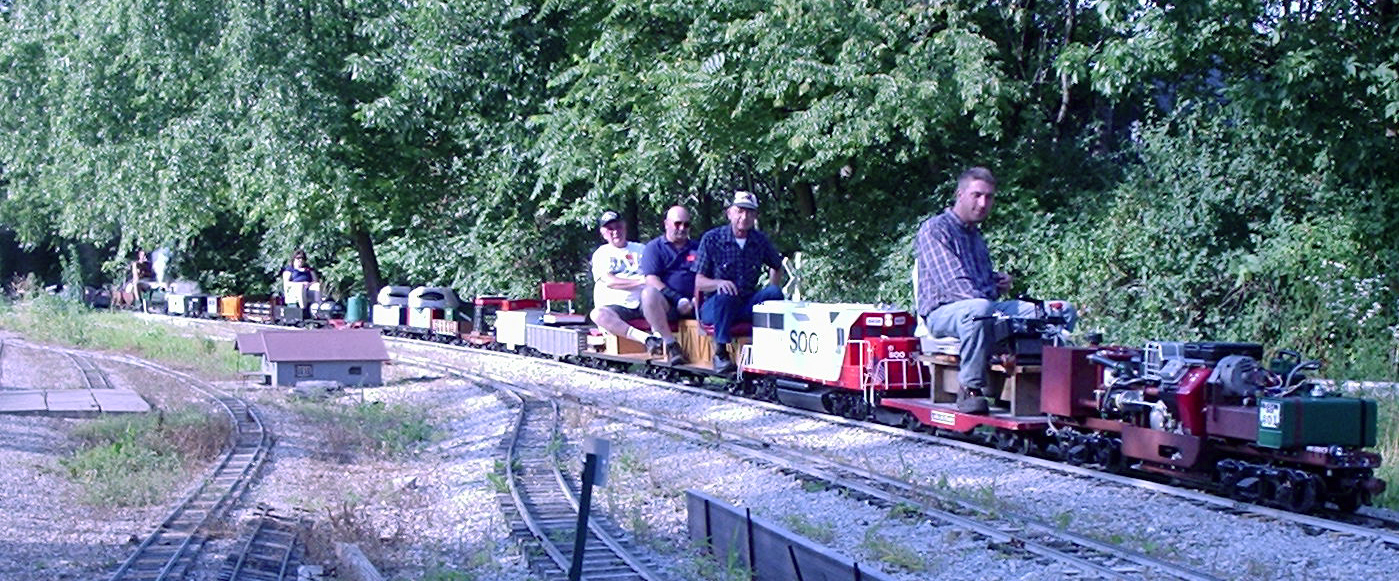

Not yet! :D However, during initial proof-testing the design I did haul a pretty long train, which also had several dead locomotives in the consist to add weight. We calculated the total train weight to be 7800 pounds, which is quite a bit to be hauled by a locomotive producing about 16 horsepower. The ruling grade at our railroad is 2.7 percent, so it got interesting as the train ascended the grade.
Long Test Train
Long Test Train
Long Test Train
Long Test Train
In the above photos, note the position of the orange covered hopper car, which will give you an idea as to how long a train this was. That car is visible in the first picture in the same field of view as the block signal on the other track.
Long Test Train Climbing 2.7 Percent Grade
I took the above photo as the test train was about to crest the 2.7 percent ruling grade.
