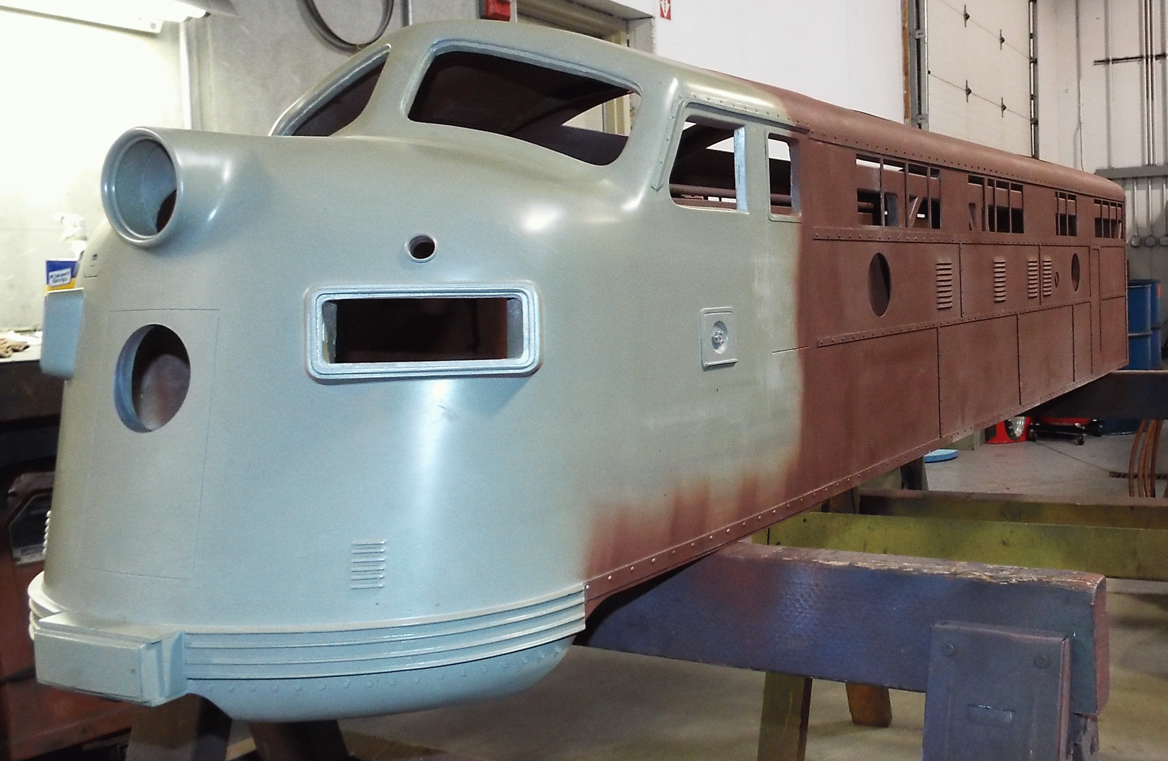

How was the body made BDD?

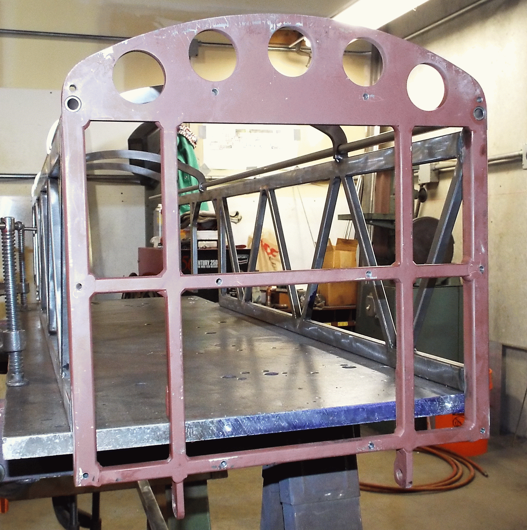

Along with everything else in the locomotive, I built the body in my shop.
The main part of the body is made from laser-cut sheet steel, with an internal "skeleton" to give it structural integrity. Welded construction is used wherever steel is joined to steel. Here's a picture of the skeleton right after I finished welding and cleaning it.
File comment: Body Skeleton

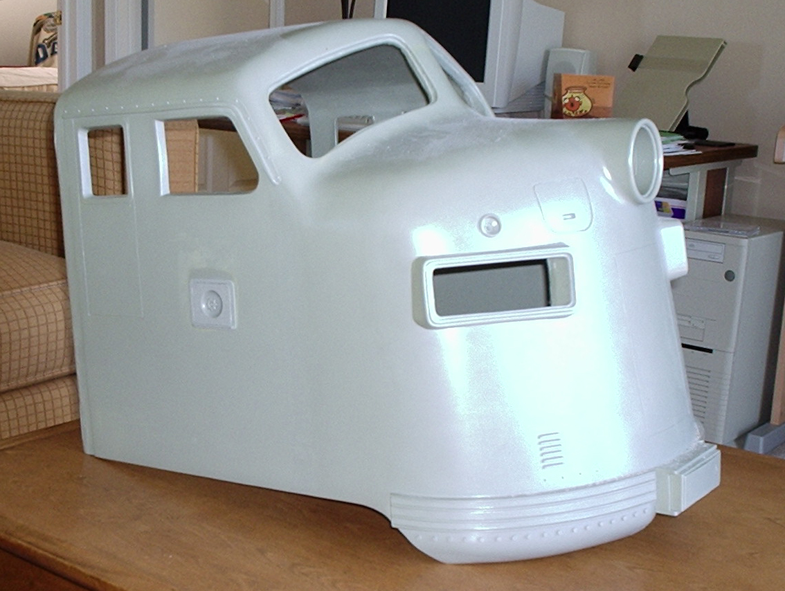

The nose assembly, which is essentially everything from the cab doors forward, is a one-piece Alumilite casting. It is bonded to the rest of the body with PC-7, a high-strength epoxy. Here's a picture of the casting.
File comment: Alumilite Nose Casting

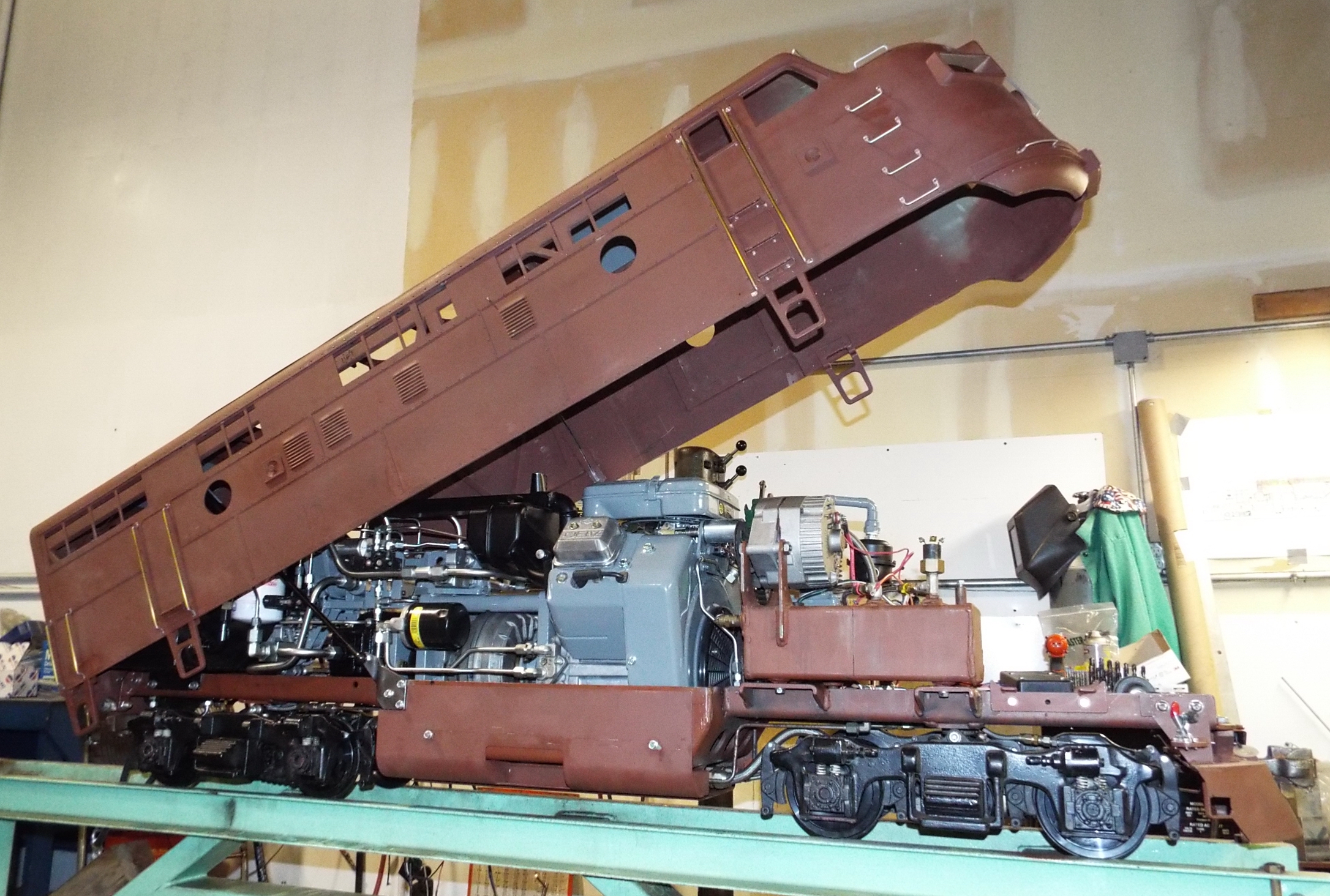

The below photo shows the body mounted on the chassis and opened. As the body weighs around 110 pounds, I used a pair of industrial gas springs to lift and support the body in the open position.
File comment: Body on Chassis, Opened
Did you make the casting, or was this a piece you purchased?
I purchased it.

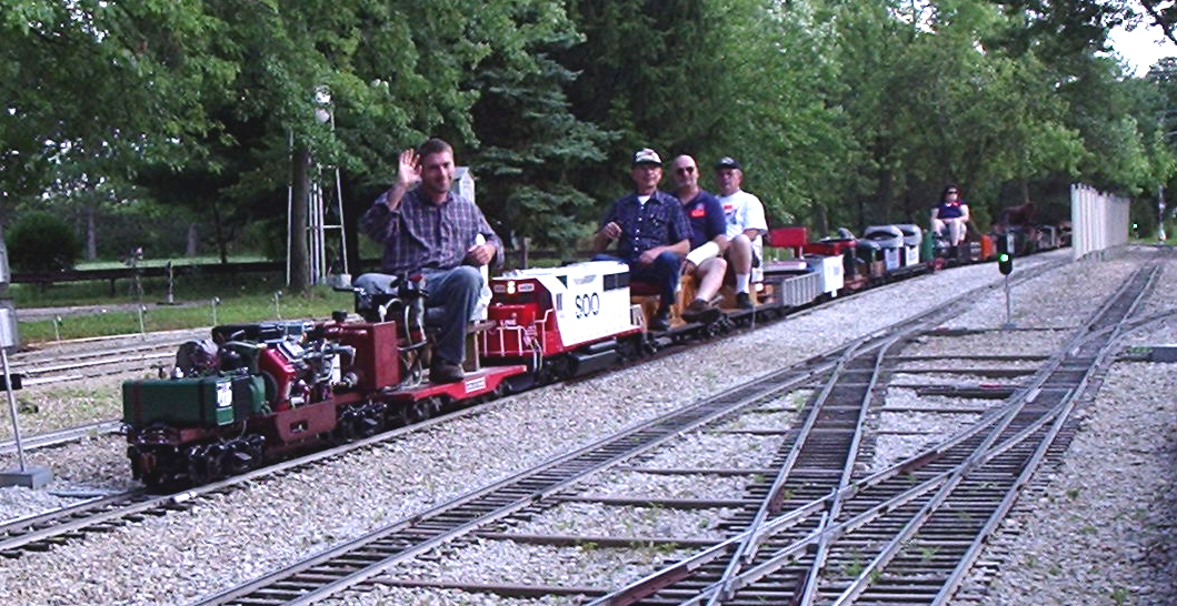

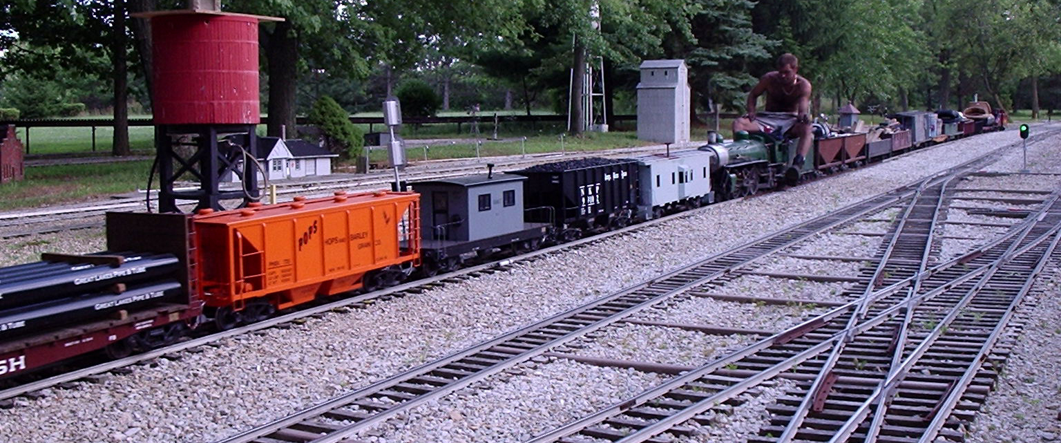

whartung wrote:
You're right, increasing the number of transmissions does nothing for efficiency, but it *does* allow installing more power in a single locomotive than a single transmission can handle.
Obviously, models like BDD aren't necessarily this way, but they're not hauling a 100 cars up a mountain pass either.
Not yet! :D However, during initial proof-testing the design I did haul a pretty long train, which also had several dead locomotives in the consist to add weight. We calculated the total train weight to be 7800 pounds, which is quite a bit to be hauled by a locomotive producing about 16 horsepower. The ruling grade at our railroad is 2.7 percent, so it got interesting as the train ascended the grade.
File comment: Long Test Train
In the above photos, note the position of the orange covered hopper car, which will give you an idea as to how long a train this was. That car is visible in the first picture in the same field of view as the block signal on the other track.
File comment: Long Test Train Climbing 2.7 Percent Grade
I took the above photo as the test train was about to crest the 2.7 percent ruling grade.
