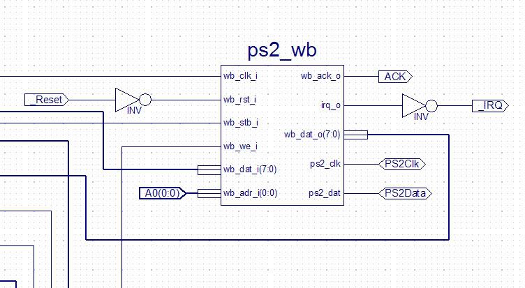

Man was that easy!
I did a "quickie" test with a simple loop that reads wb_dat_o (wishbone data out) and writes the same value to the R, G, & B for the display. So it will only display black for 0,0,0 and white for $FF,$FF,$FF. Typing on the keyboard produced expected shades.
The PS2 core info on opencores.org states that it was based on info from this site:
http://www.beyondlogic.org/keyboard/keybrd.htm
Although the core is written in VHDL here is what the wishbone symbol looks like:
wb_clk_i is the 20MHz Phase 2.
wb_stb_i is an active high chip select.
wb_we_i is write enable.
A0 selects the data register or the status register.
irq_o can be set to be active on different conditions by the status register.
wb_dat_o is the latched data. Last key pressed remains on the bus.
Sending data to the keyboard doesn't seem to be working yet. Trying to light up num lock, caps lock, and scroll luck, by sending #$ED, then #$07.

Today I was able to update a few critical routines I had written for the old 320x240 display for the new 640x512 display. Routines like 2-digit 8 bit hex to 3 digit decimal conversion (thanks to 6502.org!), and character plotting. Character plotting is MUCH easier with this new display. Now that I'm checking out Newhaven's site for the link, I see they have a new 7" 800x480 display for $86! $20 cheaper with the same controller. Same controller means just a few simple variable changes... Very tempting!
So anyway, I made a simple routine to monitor the keyboard, and mapped a table for keystrokes, and displayed the decimal value for keystrokes and the resultant character.
Turns out Daniel Quintero's PS2 core has not been completed. It's good for translating all keypresses into individual codes. But it does not activate LEDs, and there's no way to do a momentary shift + keypress for a capital letter or the symbols above the numbers. One big positive is that the code is very short and I may end up still using it as I really only need very basic input for assembly input (eventually).
Another core I found today in opencores.org SVN repository was made by John Clayton and Miha Dolenc. It's documented very well, says it supports turning on LEDs, has "shift trapping" and more...
I hope it fits into the XC2S15. Will find out soon!

I'm going to stick with Daniel Quintero's PS2 keyboard Core... It's very simple and it works, and especially since I hit my limit trying to fit an I2C core into the same XC2S15.
I'll try to use the status register to "trap" the shift keys...
