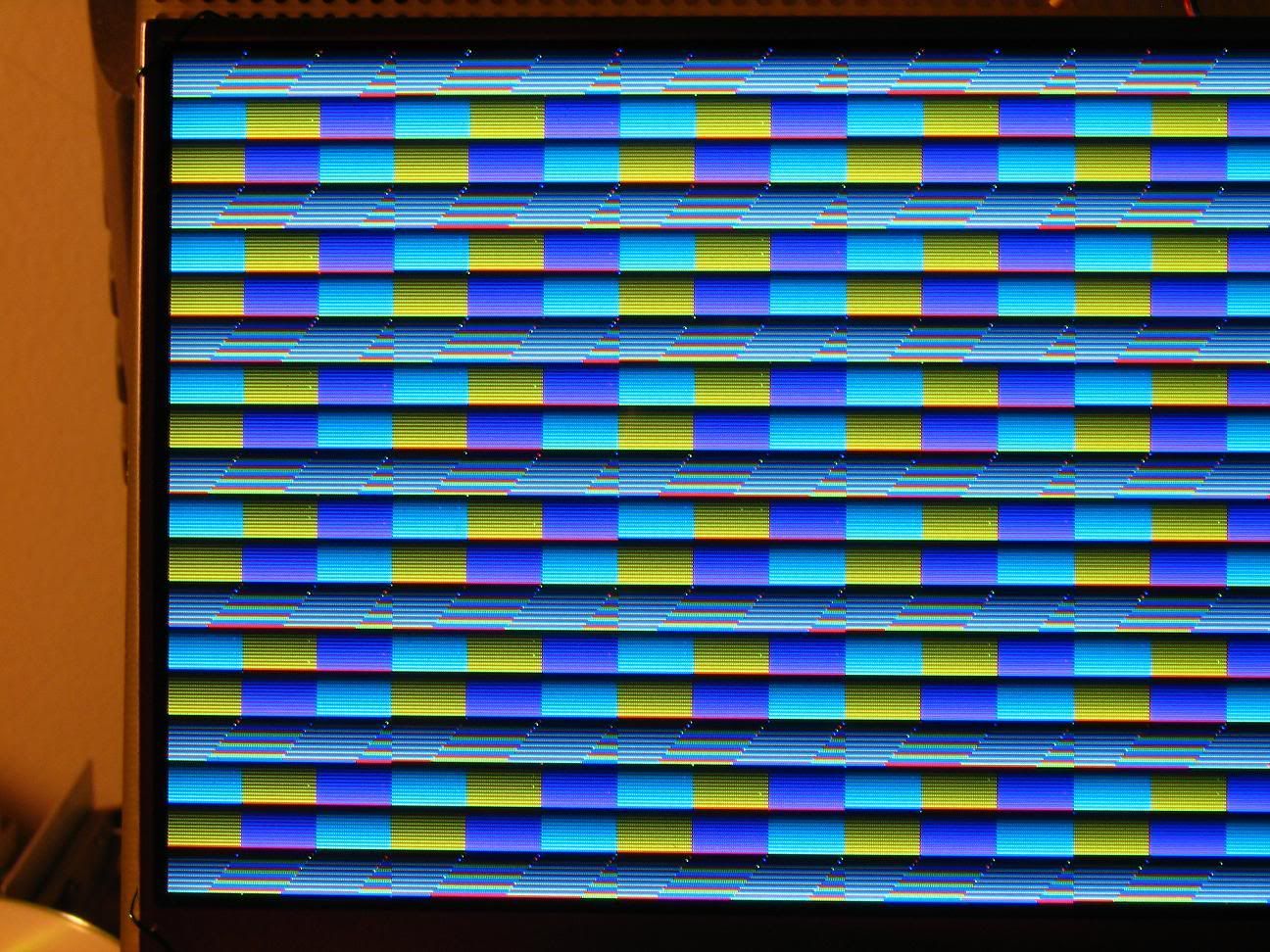

I found out why I was addressing a small window, instead of the entire 640x480 display. Apparently an STZ to display registers is not sending correct data. Although the data is consistent it was not a zero value. I found this out this morning before heading to work. I was experimenting with the display init values and decided before changing some values, that I would rewrite the code to do an LDA, STA to make it easier to just change a few values. SO starting with LDA #$00, STA displaydata, instead of STZ displaydata, it worked! as it should have from the beginning?... I know it's not a speed issue, as I've tried running from SRAM down to 2.5MHz (same as EEPROM copy speed) and have seen the same result.
So although I m pleased with this progress, I seem to be regularly making 2 steps forward, 1 step backward (sometimes even 1 step foward, 2 steps backward)...
Also I have learned alot about using symbols in the Xilinx ISE 10.1. It was about a 2 week struggle to get my custom symbols (symbols=schematic reduction)to work like the original schematic without symbols. Symbols in ISE are chunks of a main schematic, similar to making your own custom IC. I found it necessary because my original single schematic was growing beyond the limits of ISE's largest setting. Initially, I divided it into 3 symbols. 1 for memory decoding , 1 for banked address decoding, and 1 for the phase 2 switching circuit. Made sense to me, but not so easy... ISE 10.1 software was optimizing out my memory decode symbol. It saw bank address decode as priority, and negated wherever else the Address bus went. I realized this after synthesis errors... After combining the address decode and bank address symbols into 1 symbol, which both use A8-A15, the circuit worked as the original... I'm still learning. Maybe one day I learn VHDL.
Anyway, I once again have a working circuit within the FPGA with the W65C02 running @20MHz. My address decoding is still leaving alot to be desired...

Here's a clearer pic of what I've got so far. SRAM is reliably being written to and read from @20MHz and sent to the display, but not as desired. I'll post the software loop tomorrow:
