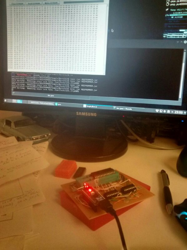

Thanks Arne and others for the help. Really apprciate it. My meeprommer is finally working!
These are the steps I followed for debbuging:
1) Test wiring.
2) Test address bus with led array on the bus. Helped me found a wiring issu I hadn't detected in (1).
3) Nevertheless writing data to eeprom was still failing. Data polling failed.
4) Hookup a few lines of address bus and data bus to read data. Rest of the lines with 10K resistor to ground.
Set up an address and read data from the bus. Data was correct.
But still writing data to eeprom was failing. Writing data to sram seemed to work.
5) As it turns out, my eeprom at28c256 (apparently legitimate from atmel) was locked. Sending the unlock sequence seems to have work.
Now to enjoy saving eeproms. Thanks for the help guys.

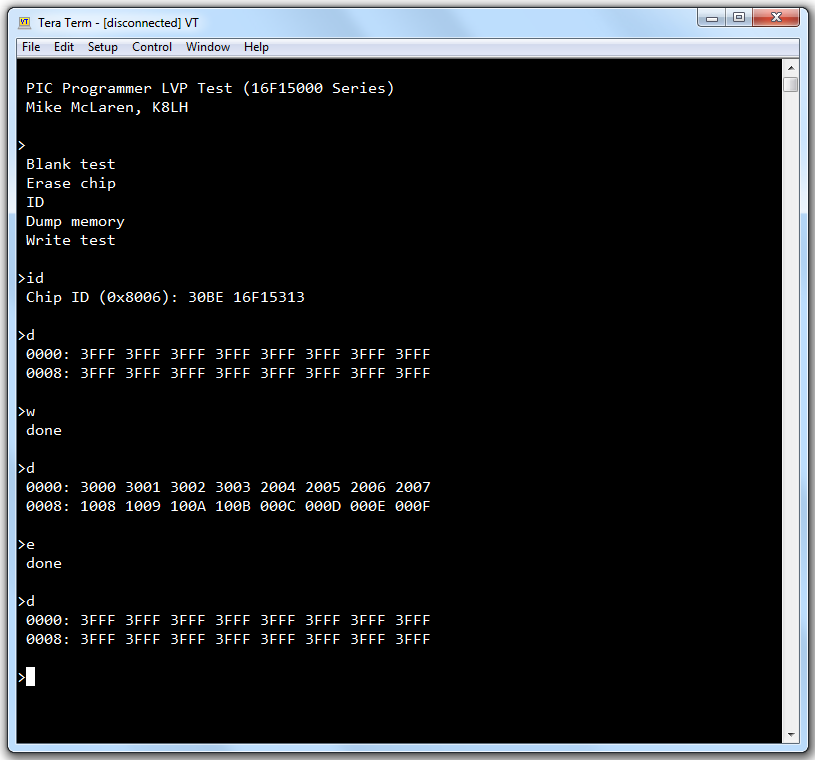

I just discovered I can program recent generation 8, 14, and 20 pin PIC chips by turning them around 180° in the socket on my Flash Programmer Shield (see below) and using an LVP (Low Voltage Programming) algorithm in the Arduino program/sketch. I believe this would work with MEEPROMER designs too as the important 'data' pins on the ZIF socket are common between the designs.
I'm geeked because I'd like to share projects using 16F15xxx , 16F18xxx , and 18FxxQ43 series PIC devices without having to force users to buy a $66 PICKIT 4 to program them. Is there anyone in our group who doesn't have a $4 Arduino Uno clone?

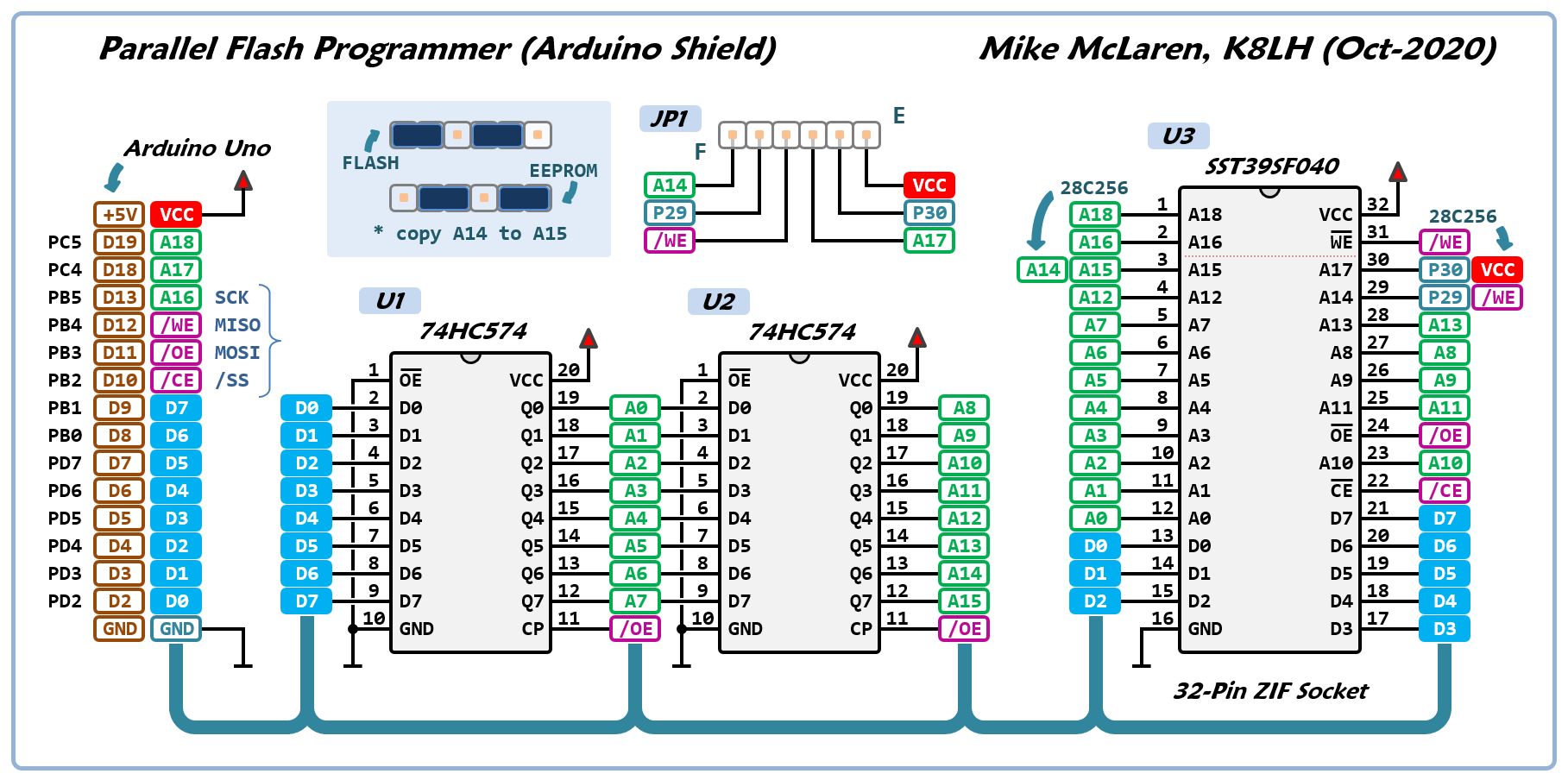

Re: 28Cxxx EEPROM Programmer
FWIW, I just started a related topic, "(E)EPROM/flash programming algorithms.
