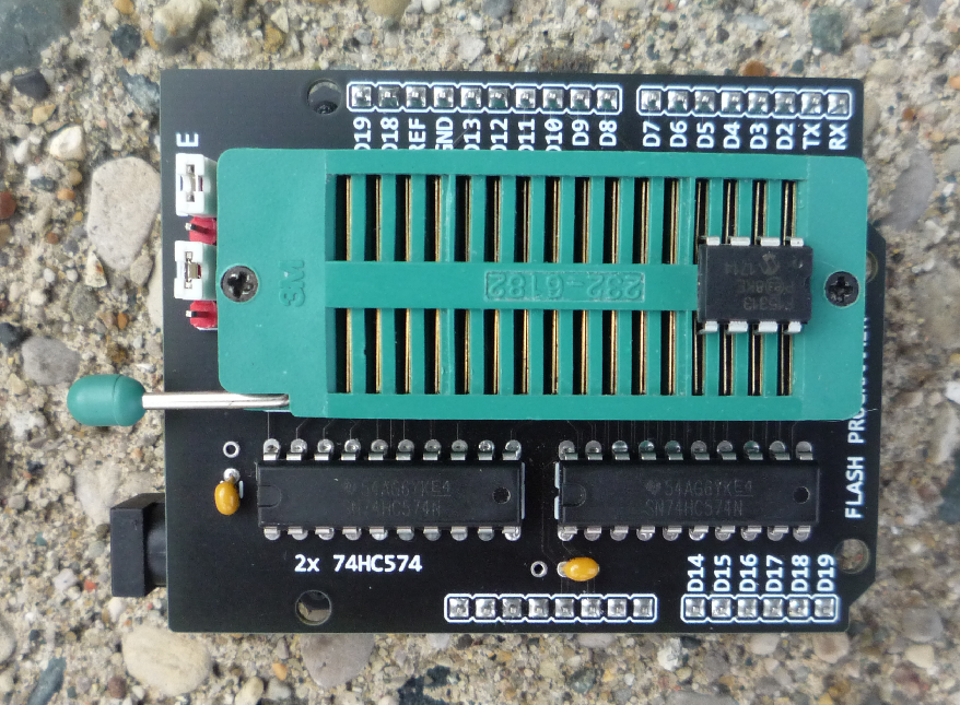

I just discovered I can program recent generation 8, 14, and 20 pin PIC chips by turning them around 180° in the socket on my Flash Programmer Shield (see below) and using an LVP (Low Voltage Programming) algorithm in the Arduino program/sketch. I believe this would work with MEEPROMER designs too as the important 'data' pins on the ZIF socket are common between the designs.
I'm geeked because I'd like to share projects using 16F15xxx , 16F18xxx , and 18FxxQ43 series PIC devices without having to force users to buy a $66 PICKIT 4 to program them. Is there anyone in our group who doesn't have a $4 Arduino Uno clone?
