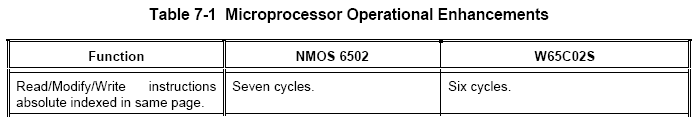

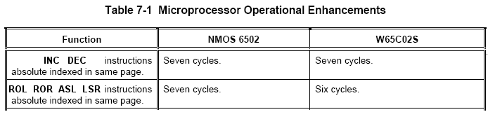

I'm only mildly surprised that you observed $8000 on the address bus in the cycle preceding the write. Can you tell us what happens if you alter the code so the page crossing is guaranteed to happen (rather than guaranteed NOT to happen)? In case of a page crossing I expect the CPU will re-read the last instruction byte (rather than the unacceptable alternative of putting a partially-formed address on the bus).
It's true the CMOS '02 introduced changes that address the NMOS '02 problem of partially-formed addresses appearing on the bus during indexing; and yes one tactic is to place PC on the bus during the "dead" cycle in question. But that's not to say you'll see PC appear in every case where an unused bus cycle occurs.
The fixes are not as predictable as all that, and there are irregularities not described in the doc. For example, dclxvi reported the anomaly summarized here. As shown in the original and amended charts below, there are inconsistencies even between almost-identical instructions! :shock: This pertains to a different NMOS bug that got fixed in the 'C02, but it illustrates that corrections aren't necessarily uniformly applied.
Table 7-1 excerpt (original).gif (6.04 KiB) Viewed 1849 times
Table 7-1 excerpt (corrected).gif (8.17 KiB) Viewed 1849 times
you may have discovered new errata in the 65C02.
Yup. We know there are irregularities. And irregularities are alright as long as they're benign (like the one Drass reported). It's comparatively harmless to read a byte you're about to write to -- there's less risk of trouble with that (as compared to the nasty NMOS behavior of perhaps reading an unrelated byte located $100 below the intended address :shock: ).
