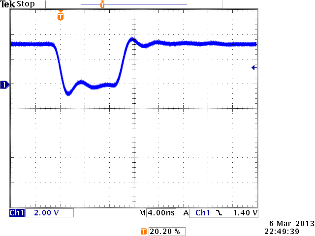

On my SRAM, I'm getting the best results with DRIVE = 4. See picture from scope with top trace = OE, and bottom trace = D0.
PS: the edges are probably not really accurate due to limited scope bandwidth (200 MHz), but with DRIVE=6, there are more jiggles after a transition, and with DRIVE=2, the edges are clearly slower.

Arlet
Joined: 16 Nov 2010
Re: Concept & Design of 3.3V Parallel 16-bit VGA Boards
Post by Arlet »
Same OE pulse, but now with 12mA drive strength. Doesn't look like it would cause problems, though...
