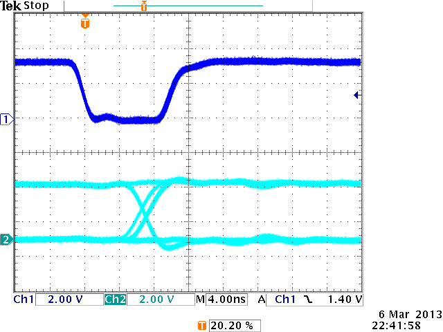

In cycling through the 16 colors with a large software delay, (C64 style) that I'll be using for the font attributes, and painting the entire screen there is a problem with white. The screen is flickering bad. Then as soon as I power off, even before the picture fades, the flickering disappears. I thought it was a software or core issue at first, but then I changed the program to paint the screen white only, and it flickers. Hopefully bypass caps will help stop the effect. If not I'll experiment the FPGA output 'DRIVE' and 'SLEW' constraints. Currently 'DRIVE' is @12mA and 'SLEW' is slow.

This isn't just flickering. This is major noise in the form of thick bands of incorrect color scrolling vertically up, and it was preset with yellow '1111111111100000' for about 10 seconds until the system warmed up then disappeared, but was still plainly visible when '1111111111111111' was painted no matter the length of time. I'm pretty sure it has to do with bypass cap's. I've just been lazy to solder all those 1mm things in. There's at least 20 I have to solder in. I've been settling for a light grey for my software development today.
I really should track this down though in order to be thorough. I'll try adjusting the FPGA drive strength first and observing some signals on the scope for the rest of today.

Observations:
The noise disappeared after dialing the FPGA drive current to the SyncRAM pins down to 6mA.
The circuit still worked even after going all the way down to the lowest setting of 2mA, which is where I'll keep it for now.

On my SRAM, I'm getting the best results with DRIVE = 4. See picture from scope with top trace = OE, and bottom trace = D0.
PS: the edges are probably not really accurate due to limited scope bandwidth (200 MHz), but with DRIVE=6, there are more jiggles after a transition, and with DRIVE=2, the edges are clearly slower.

PostPosted: Wed Mar 06, 2013 8:58 pm
Interesting!
For comparisons sake, what does your scope see with a drive strength of 12mA?
PostPosted: Wed Mar 06, 2013 9:00 pm
Same OE pulse, but now with 12mA drive strength. Doesn't look like it would cause problems, though...
