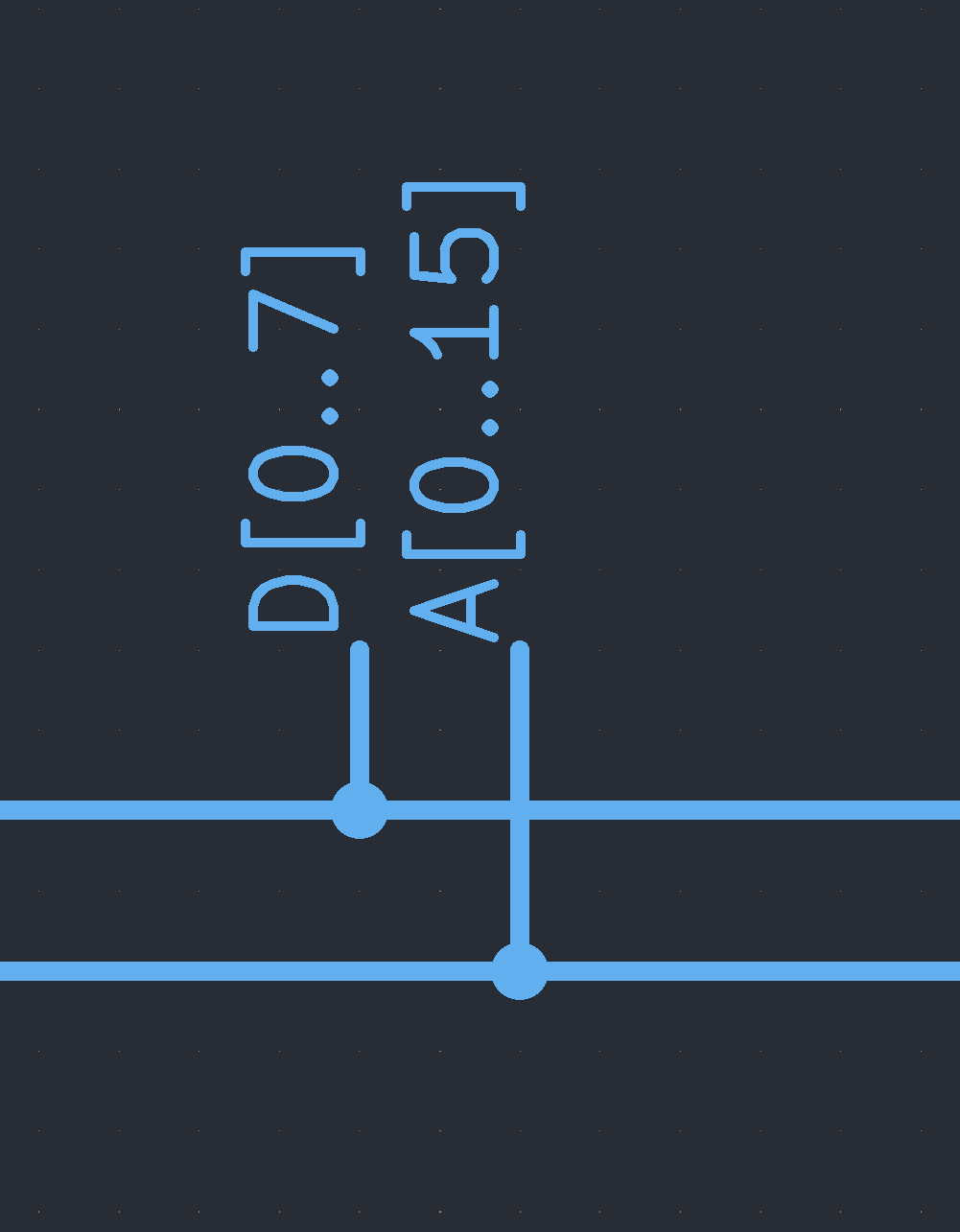

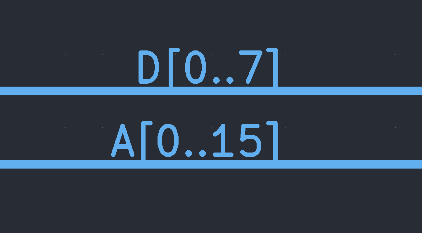

This is not exactly on topic, but...

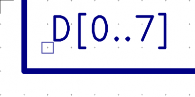

I'm out of town for a couple of weeks to play a show, so I thought this might be a good time to learn how to make schematics with KiCAD. I can see it is a powerful tool. Alas, the UI is frustratingly bad, at least the MacOS version. (When I say "UI" I mean things like having sane default behavior for basic stuff, like what happens when you click a button, zooming / scrolling with the touchpad, and so on.)
I'm trying to connect a data bus between a 6502, SRAM, and flash ROM. There are a couple of youtube tutorials for this that I've found, so I've gotten to the point where I can actually make the bus. However. Once you give labels to all the pins that are supposed to connect to the bus, you have to give a label to the bus itself so that it knows those pins are its members. There's a little "create label" tool that looks like an A with a line under it. When you use that tool, you get a label that looks like this:
The little box in the lower left is how you connect the label to the bus (the blue line). I can't for the life of me figure out how to change the location of the actual text in relation to that box. The default arrangement makes it so that the label OVERLAPS the bus line. I want to move the label text further away from the bus line, and also I want to move it UNDERNEATH the bus line. Is there a way to do this? I may delete KiCAD in a fit of rage...
It's a funny UI for sure, and nobody would accuse it of being intuitive - but in some respects it's quite efficient as a lot of things are keyboard-driven.
The v7 release unified things a little bit between the schematic editor and PCB editor (which are quite separate programs, hence the discrepancies) but it still feels much the same to me, i.e. fine as I'm used to it but surely quite hard for newcomers!
R will "rotate" things and it changes the location of the text with respect to the anchor, but not a great deal. I think the anchor will always be under the text for horizontal text but you can make it be on the left or the right. I haven't noticed it overlapping bus lines before, but can't be sure that it doesn't. Maybe there are some global settings somewhere that you could change to move labels further from their anchors - or you could position it where you did and draw a little extra bus line from the anchor to the bus.
Also to some extent the bus label is not super important - the matching labels at the end of the bus actually link the pins even if you don't draw the bus line in, or don't label it! Correctly named buses are important for cross-sheet links though. The modern KiCad actually has better support for these things than the old one, I think you can more centrally define the buses as well instead of it being so dependent on the label like that.

Eh you just kinda get used to KiCad's jank after some time.
I can't count the amount of times I have encountered missing functionality for things I would consider pretty basic, only to forget about it a while later because I wanted to get finished with the schematic/PCB and can't waste time being mad.
Looking at my own SBC's Schematic, I simply placed the bus label directly on the line. it's still fully readable so it didn't really bother me.
If you do care about the aesthetics of the schematic then you could try something like this:
or maybe sideways.
or be like me and just go "screw it, it's readable" :lol:
(note that i reduced the text size to 1.0, though even default work without poking out the bottom)

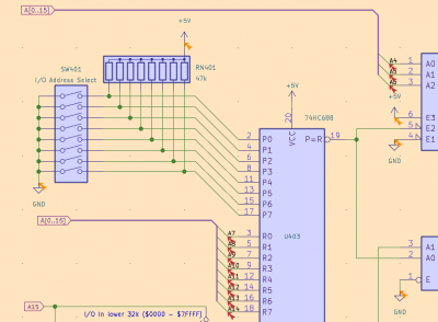

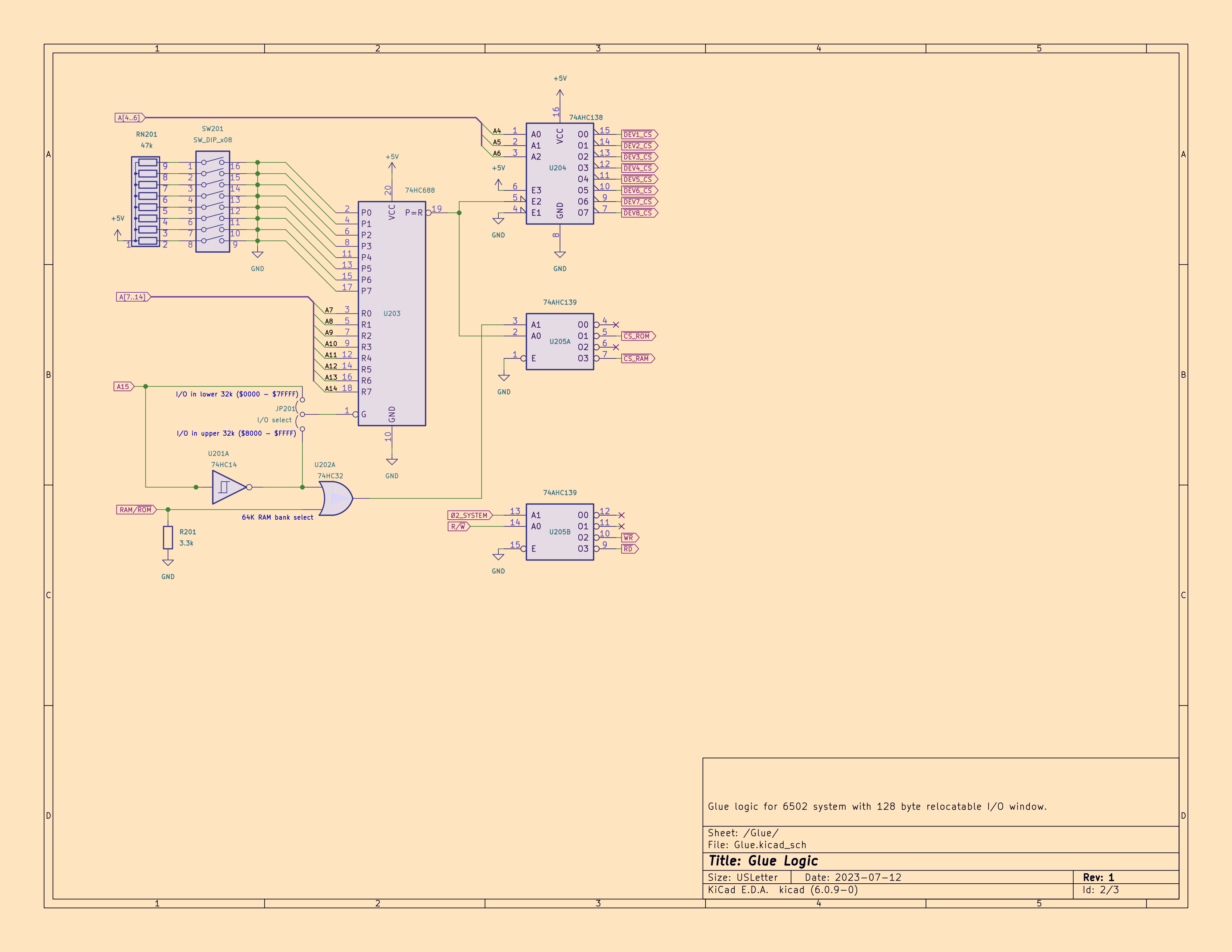

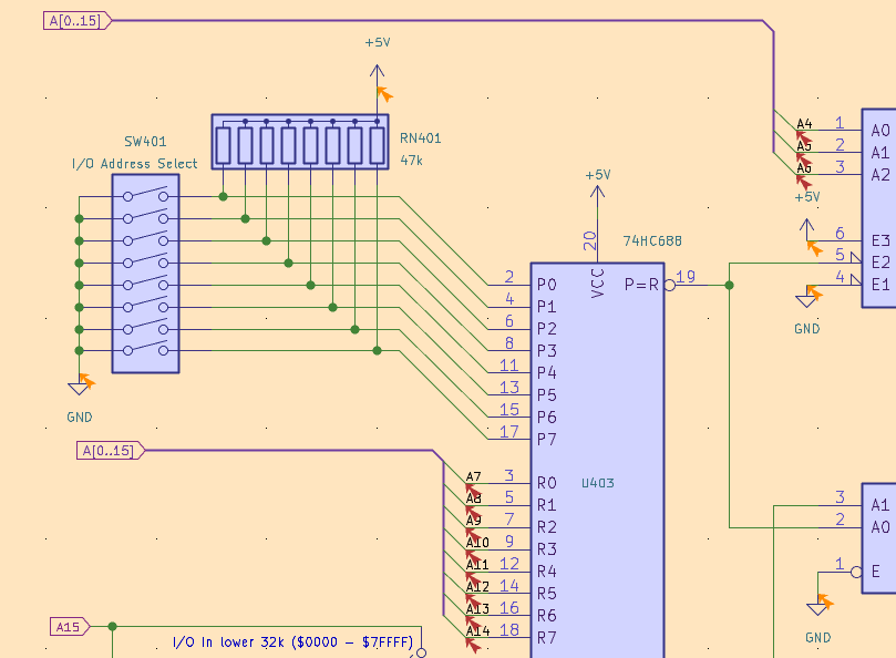

Nice. I would flip RN201 so that the "+5V" comes out at the top but it's not a big deal. There is a problem though as all the "P" inputs to U203 are shorted to ground...
Paganini
Posts: 516
Joined: 18 Mar 2022
Re: Blue April - RC6502 Project Space
Post by Paganini »
Good idea! Done!
LOL, I just noticed that. I also swapped the resistor network and the DIP switches! Here's what it's supposed to look like:

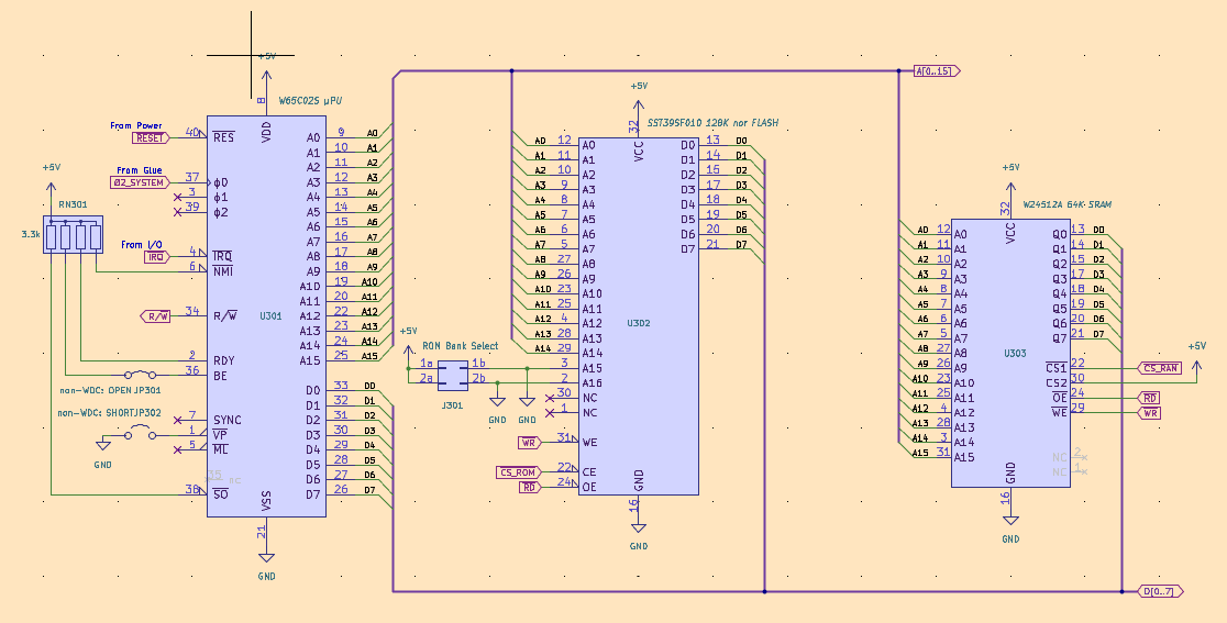

Here's today's KiCAD headscratcher. I wired up the CPU, RAM, and ROM like this:

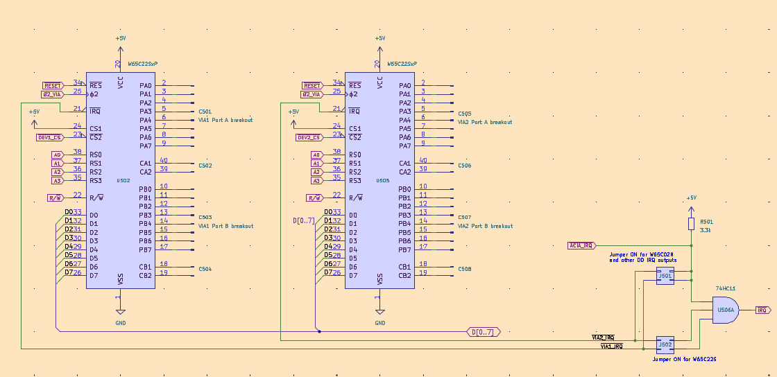

I created global labels A[0..15] and D[0..7] for the address and data buses, then unfolded the connections for each line where it connects to the various ICs, just like you see in the picture. When I run the error check, there's no complaints on this sheet. Over on the I/O sheet I wired up the VIAs like this:
You can see I created the same data bus, then broke out its individual lines. I also broke out individual address lines to connect them to the VIAs' register select lines. Again, no problems. On that same page I also broke out D0 to create an output "register" to control RAM/ROM banking:
That also worked OK! So the concept I'm working from is that creating a bus with the X[Na..Na+z] syntax creates all the individual labels (Na, Na+1, Na+2, etc.) and makes them available for individual connections. However, over on the glue logic sheet, where I did exactly the same thing for the address bus, I get a bunch of errors saying "label A4 is not connected to anything," "label A5 is not connected to anything," etc., for every address label that I fanned out from the address bus.
I'm stumped!

Post by Proxy »
hmm, only difference i can see is that on the second image, you have the Data bus defined twice, once locally (next to U505) and once globally.
while with the address bus in the last image, you only use the global label.
so to me that seems like the global labels aren't actually working and the only reason the data bus one didn't throw an error is because of the local label attatched to the same bus.
