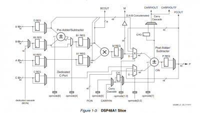

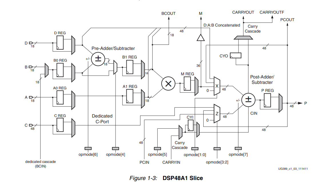

I was wondering if there was any merrit in exploring an ALU design that makes use of the DSP48A slice? Or is this obviously a non-starter? https://www.xilinx.com/support/document ... /ug389.pdf
Clearly the BCD path would need to be seperate, and this may be the stumbling block. But in the C02 there is an extra cycle available for BCD anyway, isn't there?

Yes, the new C02 uses an additional BCD cycle. I think a bigger problem is that the DSP block doesn't do logic operations (AND,OR,EOR) which are currently integrated in the adder. You might get a little faster carry, but that's probably wiped out by the extra layer of logic.
