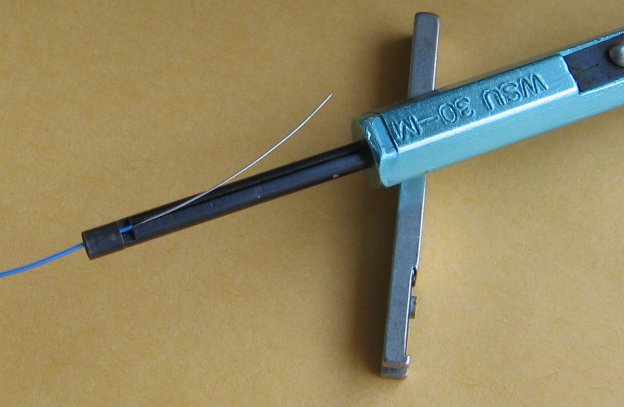

Also, I haven't written off wire wrap, but I'm not very interested either. Show me where I can get quality tools and supplies inexpensively, and I'll be closer. But really, I want a PCB in the end.
I have a web page answering WW questions and doubts, at http://wilsonminesco.com/6502primer/WireWrap.html . I use the OK Industries WSU 30-M tool shown here
which I expect is still available at lots of distributors. As WW has lost the economy of scale in recent years, the price of sockets has particularly become a bit of a monster, and to a lesser extent, the wire has. The tool is something you only buy once, so I'm not so concerned there. WW allows you to get the sockets shoulder to shoulder across the board, minimizing connection length so the AC behavior is better, unlike a two-layer PCB which needs room between sockets to route enough traces. A WW board can also be added onto or modified later. It was definitely king before the prices of PCBs came way down. There is perfboard available with a ground plane. Twin Industries' index to them is here. They also have perfboard with a plane on each side, here. These both have plated-thru holes.
