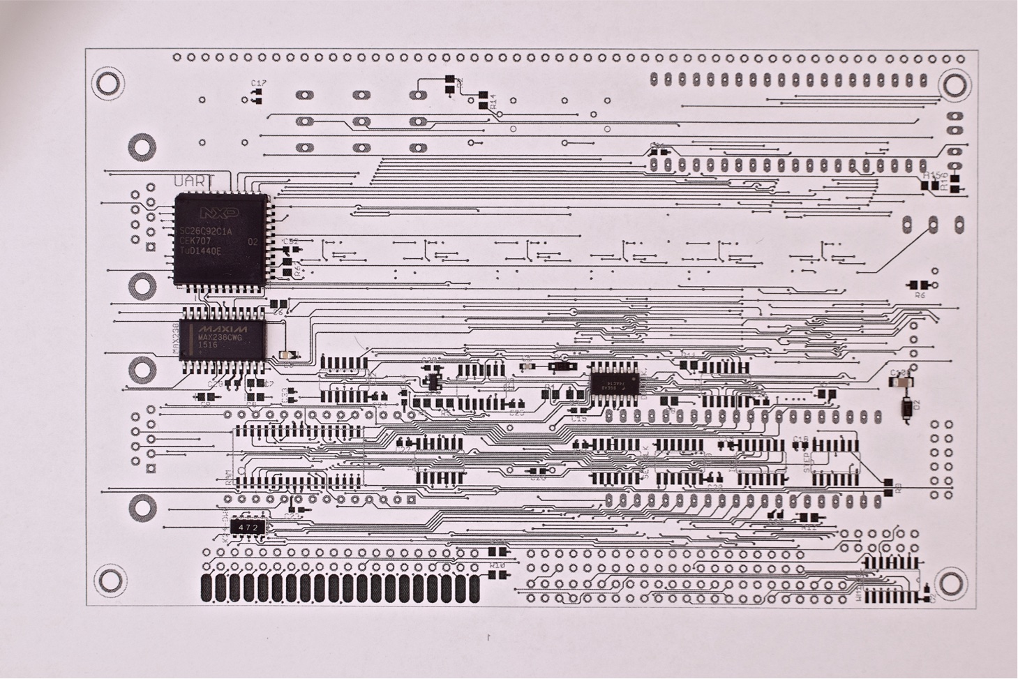

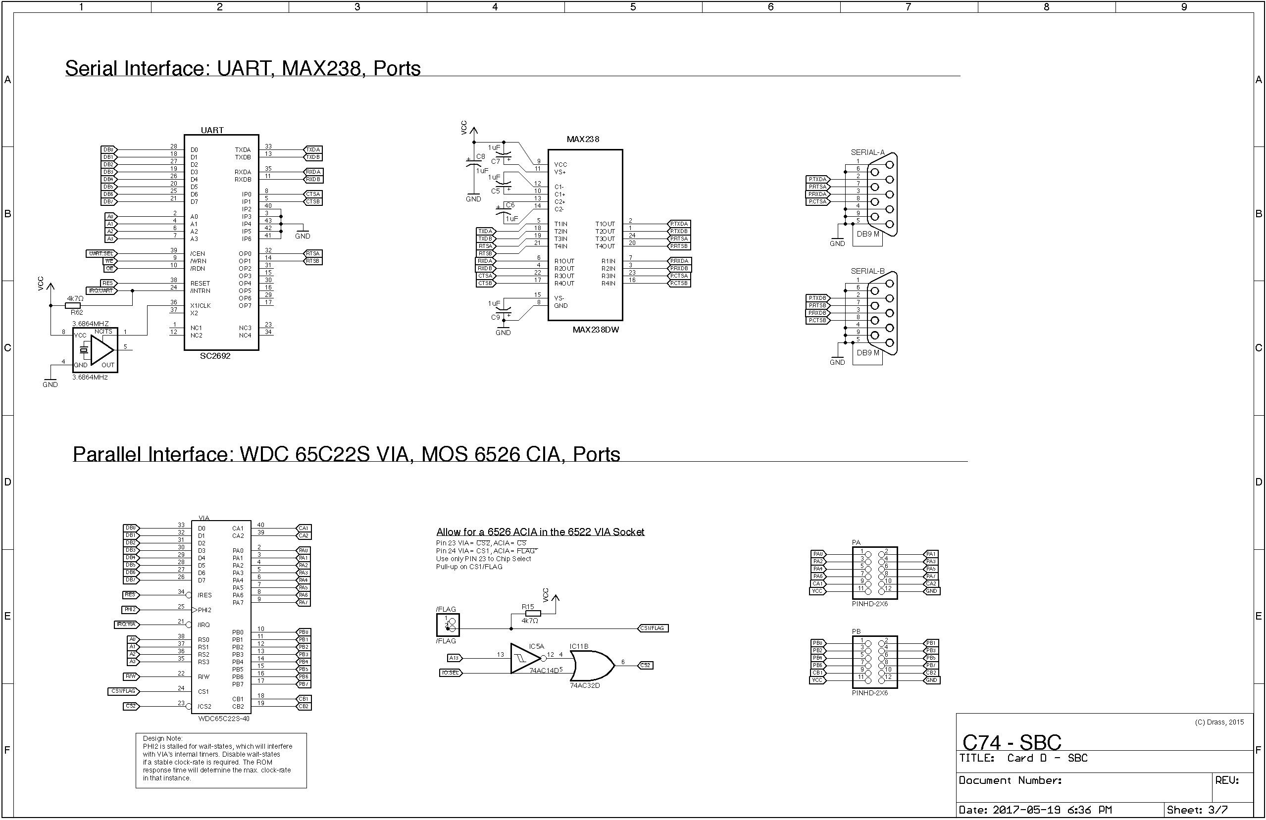

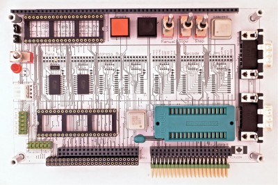

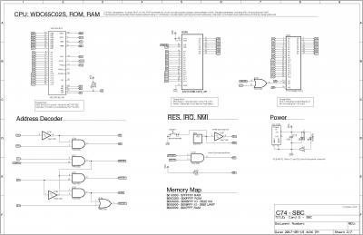

While validating the ROM cycle-times on the SBC, I noticed an unfortunate side-effect of my implemetation of wait-states. Rather than using RDY to pause the CPU (as I had seen in other designs), I opted instead for stalling PHI2 for a cycle. It seemed the simpler option, and allowed RDY to be reserved for the Single-Step clock. However, the SBC has an on-board VIA which relies on the clock, so pausing PHI2 makes real-time processing with it all but impossible. Something as simple as a regular IRQ from the VIA will have variable timing, depending on whether a wait-state happens to be triggered by, say, a ROM access. Thankfully, the SBC can disable wait-states with a jumper, or by switching to the SLOW (Div 2) clock under software control. That will do, but in truth I would have preferred the more elegant RDY-based wait-state design.
On another note, I stumbled upon Garth’s WM-1 memory expansion module, which seems a very fitting way to put the TTL CPU’s 24 bit address bus to work. After a quick chat with Garth, I added a WM-1 pin-header to the SBC, and thereby equipped it with an optional 32Mb RAM expansion card - nice! A freshly made WM-1 module is on it’s way and it's going to be a lot of fun to get that going with the TTL CPU once built. Thanks Garth!
Beyond that, there were a few more changes: I swapped the 70ns DIP ROM for a faster 45ns one and the 128k RAM chip for the same 512k variant Garth uses in his memory module. I also had to move the DIP VIA from the underside of the board to the top layer as it would bump up against the microcode-ROM PLCC socket on the Registers Card below when mounted on the TTL CPU. And finally, I was able to tidy up an issue with the STEP clock which would have caused problems at faster clock rates. Naturally, all that meant lot's of re-routing of traces :roll:
I think that may be it for changes. The PCB mockups look pretty good now: :D
The two 40-pin receptacle headers shown above actually go on the bottom layer and will connect with the TTL CPU below. The glue logic and UART are on the bottom layer as well, and those footprints check-out nicely:
Taking a look at manufacture: I decided to go back to OSH Park since I’m not panelizing and it looks like PCBWay.com may have a challenge with the vias I’m using (10mil drill, 4mil annular ring). I can probably make the SBC work with larger vias, but certainly not the other cards, so I’m sticking with them for now. (Not sure I like the purple OSH Park PCBs though - what’s wrong with the standard green?)
OSH Park takes Eagle BRD files directly, which is nice, but I also tried to generate the Gerber files. I’m not sure that’s working correctly as the gerber viewer (Pentalogix ViewMate) shows all the pcb data miniturized on the bottom left corner of the pcb while the remainder is blank. Some sort of scaling issue which I’ll have to sort out. If anyone has run into something like this with Eagle, please let me know.
Latest schematics, and what I hope may be the final layout attached. (Incidentally, I added some additional parts to the schematic and put in sourcing info so the BOM is complete. As it stands, the BOM Eagle generates uploads directly to Digikey, which is nice)
Cheers!

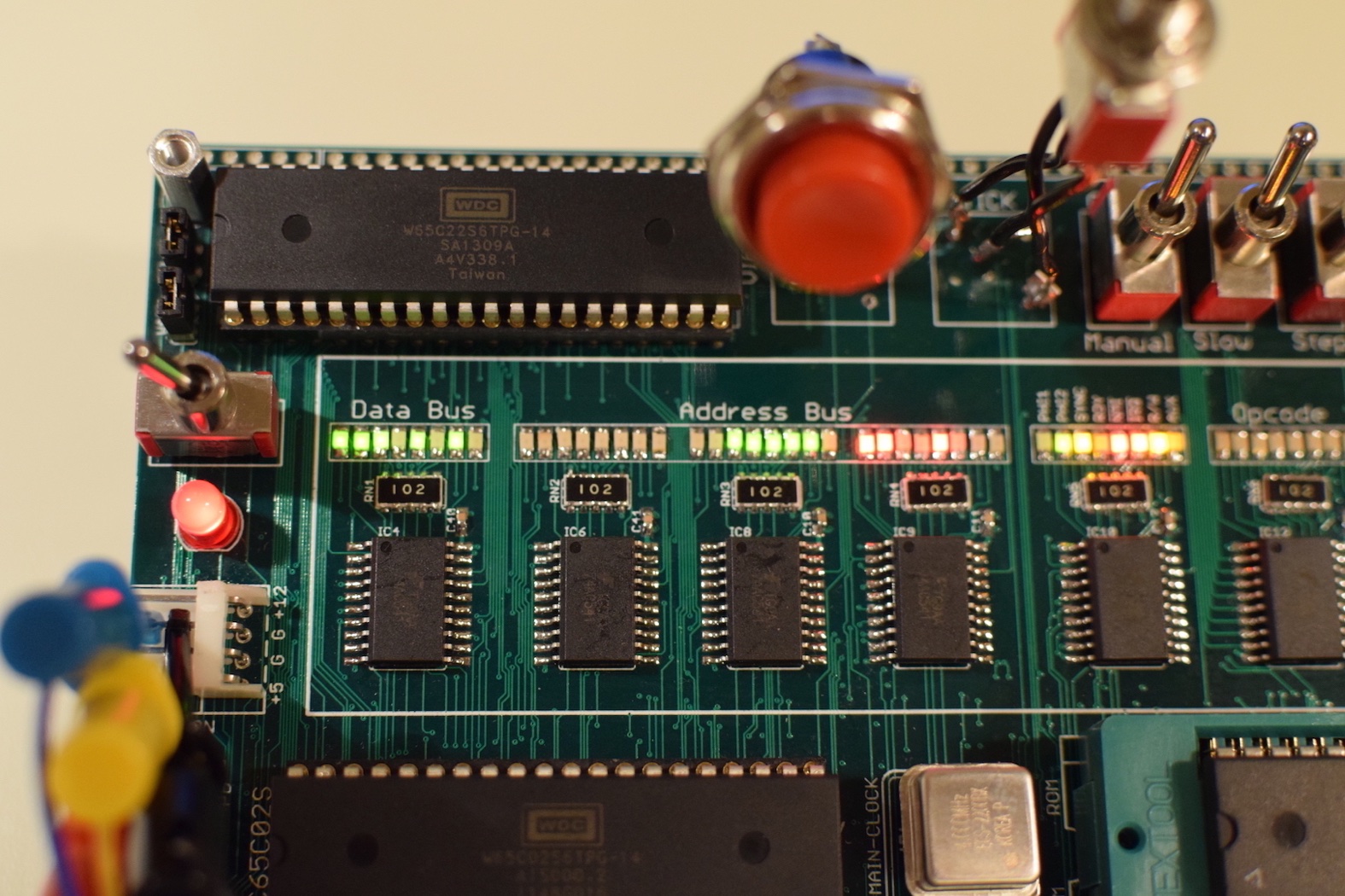

It's alive!
Well, barely ... I did get something assembled though, and It feels great to be building and not just drawing schematics, finally. Actually I'm thrilled - only about 1,000 things had to work out just to get this far, and it's a joy to see the thing execute a simple NOP test. If you look closely, you can see that the Data Bus has an $EA value in the pic below:
I'm also pretty happy with how the soldering went. I even managed to install only one IC backwards (funny how hot these little chips can get when you do that). The trickiest parts so far were those resistor arrays, but I've yet to solder the J-lead packages for RAM and the UART. I had trouble with them in the first go around so I've left them out for now.
I installed a 4MHz oscillator to start (which is generating a 1MHz PHI2 signal after going through a couple of flip-flops). I'm able to stop the clock on the fly and switch to "Manual" mode, at which point I can step the machine and watch the address bus increment - wonderful.
Still, there were lots of issues with the PCB:
1) Drill holes for the RESET and clock TICK push-buttons are too small (hence the rather gangly switches I installed instead)
2) Drill holes for toggle switches are too small ... I had to file down the pins to make them fit :shock:
3) Toggle switches are wired upside down :roll: :oops: what a newbie mistake! Well, they work, as long as you remember that up really means down :)
4) I'm missing a few LEDs and the RDY LED seems to be burned out (who doesn't order plenty of spare LEDs? Me, that's who)
5) The FAST clock is not working ... I think this one is a mis-wired inverter. I'm going to have some fun cutting a trace and running a jumper to fix this ... can't wait to see how that turns out!
Once I get this sorted out, I'll have a go at some firmware and see if I can get the VIA to work, and then maybe install the RAM and the UART. With some luck, I can get things going with the current PCB. I'll have to order a new one at some point, but I would sure like to fix all the issues at once.
