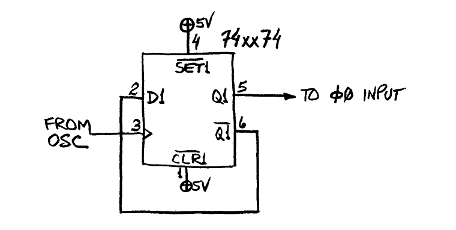

An asymmetrical clock may keep your 6502 system from running as fast as it otherwise could. Connecting a crystal or RC directly to the pins of most 65c02's works for non-critical applications; but to improve the timing margins for higher speeds, use an external clock oscillator running at twice the final speed, and use one flip-flop in a 74HC74 or 74AC74 to divide the frequency by two, making the waveform symmetrical in the process. Connect the Q\ output back to the D input, and the oscillator to the flip-flop's clock input. The flip-flop's Q output becomes your new clock source. Here's the connection:
There's more about clock generation in the chapter by that name in the 6502 primer, at http://wilsonminesco.com/6502primer/ClkGen.html .

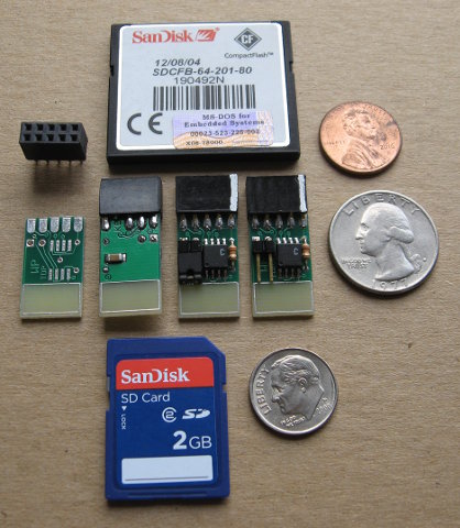

For easy, compact mass storage, use flash memory with a single power supply voltage and a serial interface. Two large ones I know of are the Atmel AT45D161 2Mx8 (which I've used, and was about $15 in Dec '00), and the AT45DB642 8Mx8 (about $40 in Dec '00). 8Mx8 is about as much as 50 Commodore 64 discs held. This one uses a supply voltage of 2.7 to 3.6 volts; but if you run it on a standard 3.3V, it will be fully compatible with your 5V 6502 system without any level-translation parts because it can tolerate 6V input signals and can output at least 3.1V with a 3.3V supply. These serial flash memories only need four wires for interfacing: clock, serial in, serial out, and chip select. Each additional flash adds one more wire for chip select. There is a write-protect pin for the lowest 128K so you can for example, keep your operating system there so you won't accidentally overwrite it.
Edit, 16 years later: I'm now using the much cheaper 25VF032 4Mx8 SPI flash memory in a tiny SO-8, mounted to tiny PCBs I had made with the SPI-10 interface and am offering for hobbyists. See the front page of my website. There are several other pin-compatible SPI flash ICs that also work on the same tiny board, shown here compared to SD Card and CF card for relative size:

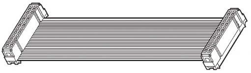

For interfacing your home-made computer's I/O to the outside world, it is often practical to use dual-row pin headers (.025" square posts on .100" centers). Female insulation-displacement connectors (IDC's) on ribbon cable plug onto the headers. These are the ones commonly used in PC's for connecting the disc drives. The pin headers fit the .100" perfboard grid, unlike DB-25's. IDC's are quick to connect to ribbon cable, commonly available, and pretty reliable (although not quite as reliable as wires soldered onto connector pins). You don't need to buy the special press to press the ribbon cable onto the IDC. Just use any bench vise. The common IDC sizes are 10, 16, 20, 26, 34, 40, and 50 contacts. Even Radio Shack has DB-9's and -25's that go onto the ribbon cables the same way.

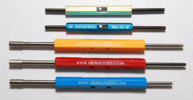

Many projects seen on 6502.org have wires soldered to solder-tail IC sockets. I like certain solder-type breadboards for analog work with all its discrete components; but digital work is almost all IC's, and wire-wrap generally works much better. The tool, tightly wrapping clean wire onto clean posts, makes the corners of the posts bite into the wire, producing a chemical weld. If you unwrap, you can sometimes feel the microscopic welds breaking. Since you don't need to get a soldering iron in between pins, the IC sockets can go right together with no board space between. The shorter wires improve operation with high-speed parts. In my 20 years of using WW, it has proven to be 100.00% reliable. I use the OK Industries WSU 30-M manual wrap tool (the blue one near the top in the picture below). To avoid wire breakage at the end of the insulation, the WSU 30-M wraps a couple of turns of insulated wire first. This insulated part can go over a previous WW since it doesn't need to touch the actual post. This way, you can always get 3 wraps on a 2-level post. Individual turns of bare wire should go against each other with no space between and no overlapping. Practice makes perfect. Do not solder them!

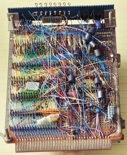

The little blue one near the top is the tool I used to WW my workbench computer whose bottom is shown here:
This 4.5 x 6.5" board has 19 ICs plus connectors, keypad, LEDs, DIP headers for discretes, and the piezoelectric beeper, all of which take room. As you can see, you can put parts shoulder to shoulder with no gaps between them, and in most cases, have the wires straight (meaning as short as possible) and without risk of breakage from movement, unlike the situation with soldering wires. Although I've added to it over the years, I used it regularly since originally making it 28+ years ago (as of the time of this edit, Nov 2021), and never had any trouble with it.
The dark-gray drums are ferrite beads put over twisted pairs of wires to reduce unwanted high-frequency digital common-mode signals, forcing them to be differencial. Six of them are in the analog inputs and outputs for the A/D and D/A converters which are very well behaved as a result, in spite of not having a ground plane.
Wire-wrap questions and doubts are answered at http://wilsonminesco.com/6502primer/WireWrap.html .
