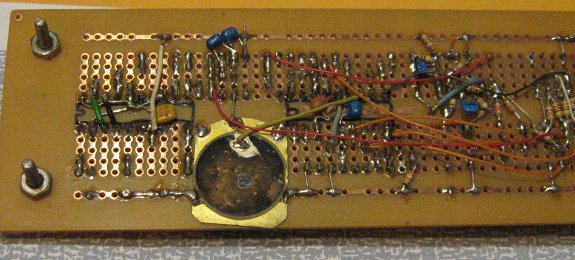

Debugging. Part II. Software. A simple effective debugging tool is a piezoelectric beeper, the kind that's .010"-.020" thick and needs an AC signal in order to sound.
The one at the top is in a black plastic housing that's about 3/8" thick and improves the volume if there's no sounding board. The small one is 3/4" diameter and .012" thick. The bigger one that's tarnished from skin oils and soldering at four points around the edge (but would still work perfectly fine) is 1-3/8" diameter and about .020" thick.
They can be taped or soldered onto the breaboard, so the entire breadboard acts as a sounding board. I've even used scissors to cut them down to fit a tight space, like this one on the back of a mostly analog breadboard with a microcontroller on it:
Very simple beep and delay routines should run on the first try. Write about 3 beep routines of different frequencies and maybe different durations so you can tell them apart. These should save the processor registers like an ISR does. Once these work, call them at appropriate places in your next routine. Put delays between the beeps to make them easier to separate when you hear them. Does it make it to point A before crashing? How about point B? Does the loop that point C is in get run the right number of times? Keep re-assembling and trying your code, each time narrowing down the problem area. LEDs can also be used to monitor the progress; but the software-driven beeper's sound "signature" assures you that the output is not a random effect of a crash. As code development advances, you might incorporate other debugging routines; but in the absence of expensive debugging tools, the lowly beep is indispensable as a "crash-finder".
Without a digital-storage oscilloscope, you can still study a pulse train output by making the software repeat in a loop for an analog scope. For real-time, things that cannot be slowed down to deliver a beep can be watched on the scope with probes on various I/O lines. Sometimes it can be a challenge to get the triggering and sweep rate just right, but it's usually doable. (to be continued)

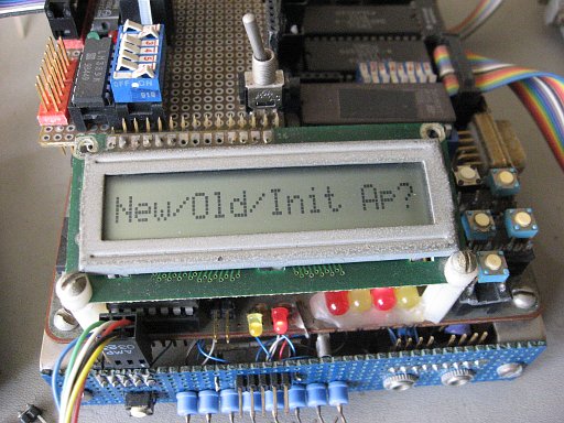

Crashing is common during development and the reset button gets used. Most crashes do not make the computer write garbage all over your program so it's not usually necessary to re-load a RAM-resident program to get it going again. Instead of having your ROMed reset routine start over new every time, put in a choice to either
A. start new,
B. keep the old program but don't run it yet, or
C. keep the old and even set it up again and run it so you don't have to re-issue instructions and parameters for the program to process to get things going again.
You may not need choice B if you're only doing assembly language unless the target computer itself is doing the assembling and you need for it to keep the old pointers, tables, etc..
My workbench computer has the LCD ask "New/Old/Init-Ap?" The choice is made using the first 3 keys of the 5-key keypad. Init-Ap executes a routine at the address I stored in the Init-Ap variable when I loaded the program. (The variable is initialized to point to a do-nothing routine if you choose option A above.) Without fixing the cause of the crash, 2 seconds may be all that's needed to reset and restart the program to try a different condition to see how it behaves. (Don't you wish Windoze were so considerate of your time?!)
Here's the display of choices on mine. The three correspond to the three keys in the left column in the keypad.
