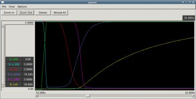

Hello everyone, long time no see )
Please help me to analyse this circuit :
And logic representation :
The problem is following: as you know, PHI1/PHI2 is lag a little over input PHI0. But 6502 documentation says PHI1/PHI2 also have a slighty extended low period, to ensure that PHI1 and PHI2 are never high at the same time.
Can someone simulate this circuit and check for PHI1/PHI2 timing diagram ?
It should be someting like that :

Hi Org
please check against this circuit, which looks more plausible: viewtopic.php?f=1&t=2412#p24074
I followed the instructions at viewtopic.php?p=13550#p13550 and was able to capture these images of a simulation of the 6502 netlist (as found in Peter Monta's github project):
The nodenames & numbers are from the visual6502 netlist.

My friend, more enlightened in the hardware stuff said it is "asymmetric cascade inverter", which delays the rising edge, so it seems that the lower level of PHI1/PHI2 is longer than the upper.
This mean Balazs clock envelopes are slighty incorrect.
