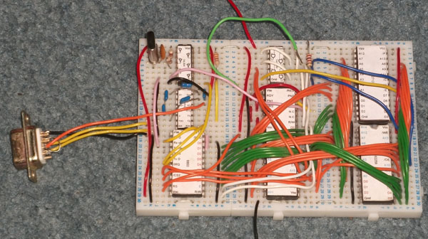

Hi.
Sorry to resurrect an old-ish thread, but thought you may be interested in my new minimal 6502 computer. This also runs Microsoft BASIC but only needs 7 chips.
http://searle.hostei.com/grant/6502/Simple6502.html
In the same style as my other minimal computers - intended to be as simple as it possibly can be, but still expandable. This is to allow you to see what is really needed to make a computer without the peripheral circuitry complicating the design.
Anyway, as always, have fun
Check out my other projects here... http://searle.hostei.com/grant/index.html

I have the same problem on my 6502 machine I am building. It seems like line numbers are lost somehow even though memory is being used up and I can see tokens and so on being stored in RAM (although I have seen some corruption in strings). I am using the OSI version of BASIC.
I am busy trying to go through and understand the code myself but any help would be much appreciated!

One thing I don't understand is the following in the INLIN code:
What does the .BYTE $2C do and what is it for?
Simon

Re: Micro UK101 Build
This is an obscure programming trick. Its effect is to Branch forward to the JSR, as if you had coded this:
It works because $2C is the opcode for BIT abs, an instruction that has two operand bytes following the opcode. But in this case the programmer's goal is not to do a BIT. Instead, the goal is to swallow (skip over) the two operand bytes but otherwise accomplish nothing. The two bytes swallowed are the lda #$07 instruction; that instruction does not get executed. Instead those two bytes -- $A9 $07 -- get interpreted as the operand of the BIT instruction.
This is weird to wrap your brain around. But the CPU doesn't find it difficult at all! From its POV, (and with the $2C restored) it just sees...
Certain factors make this trick undesirable. Yes, it saves a byte or two (compared with an actual BRA or JMP). But -- besides any human confusion it may cause! -- there will also be an access to location $07A9, and that can disrupt operation of certain I/O chips should they happen to be mapped there.
