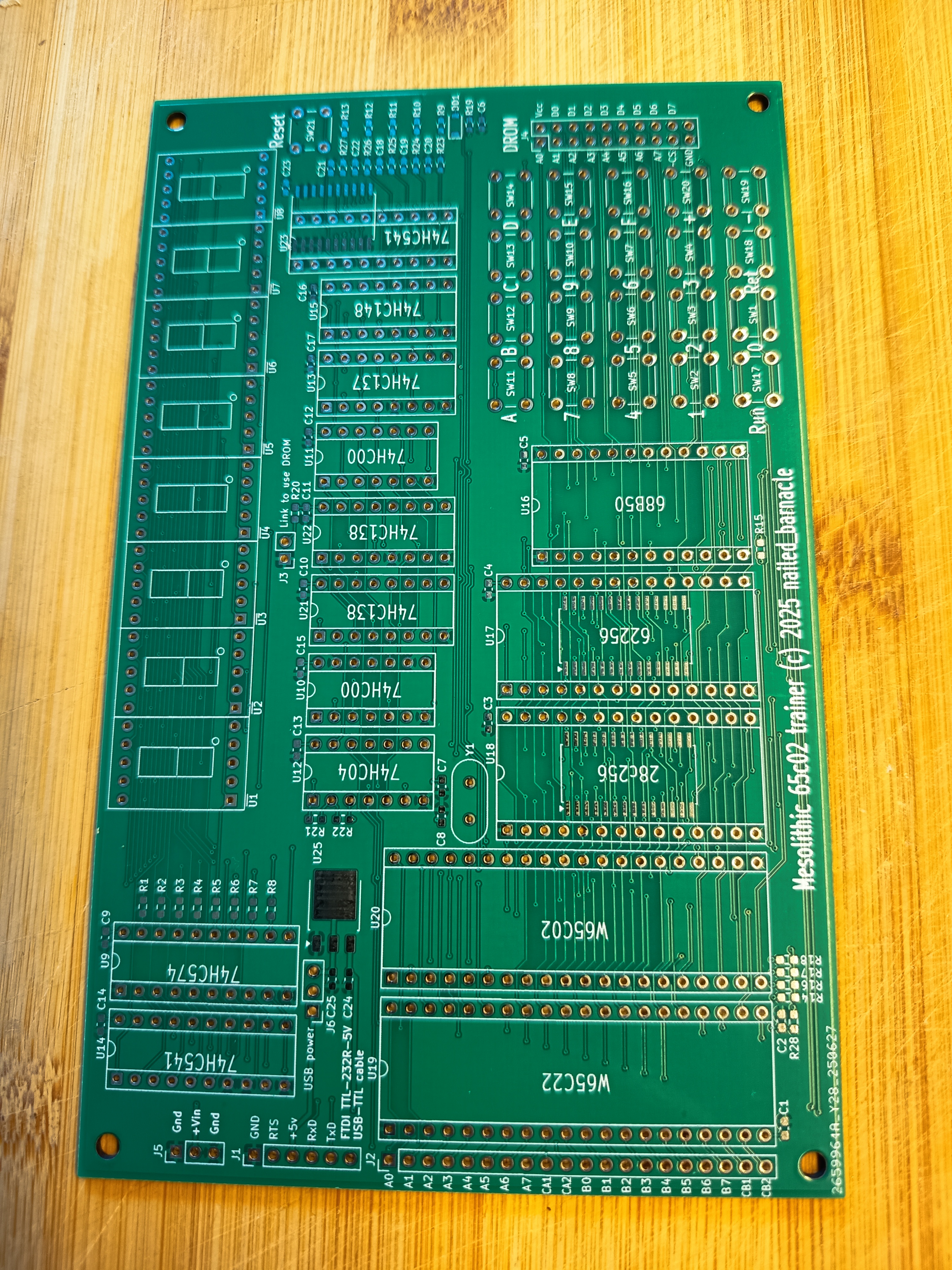

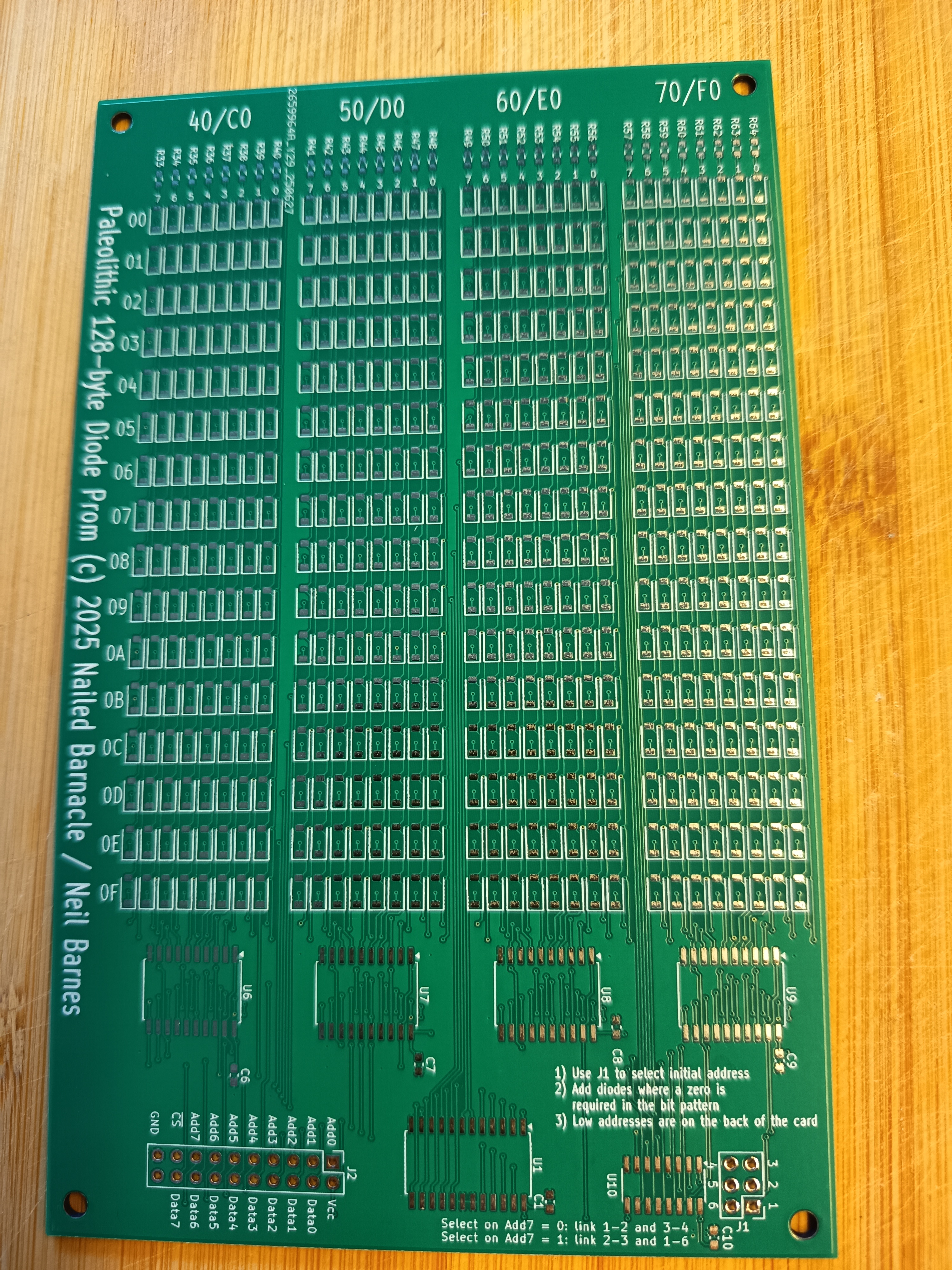

Well, the PCBs for Meso and Paleo arrived. The parts order is on its way, but sadly without the '154 of which they kindly advised me of after posting the rest of the order, so I couldn't substitute, so that's coming from Reichelt.
There's a distressing amount of soldering to be done on Paleo!

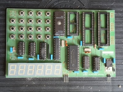

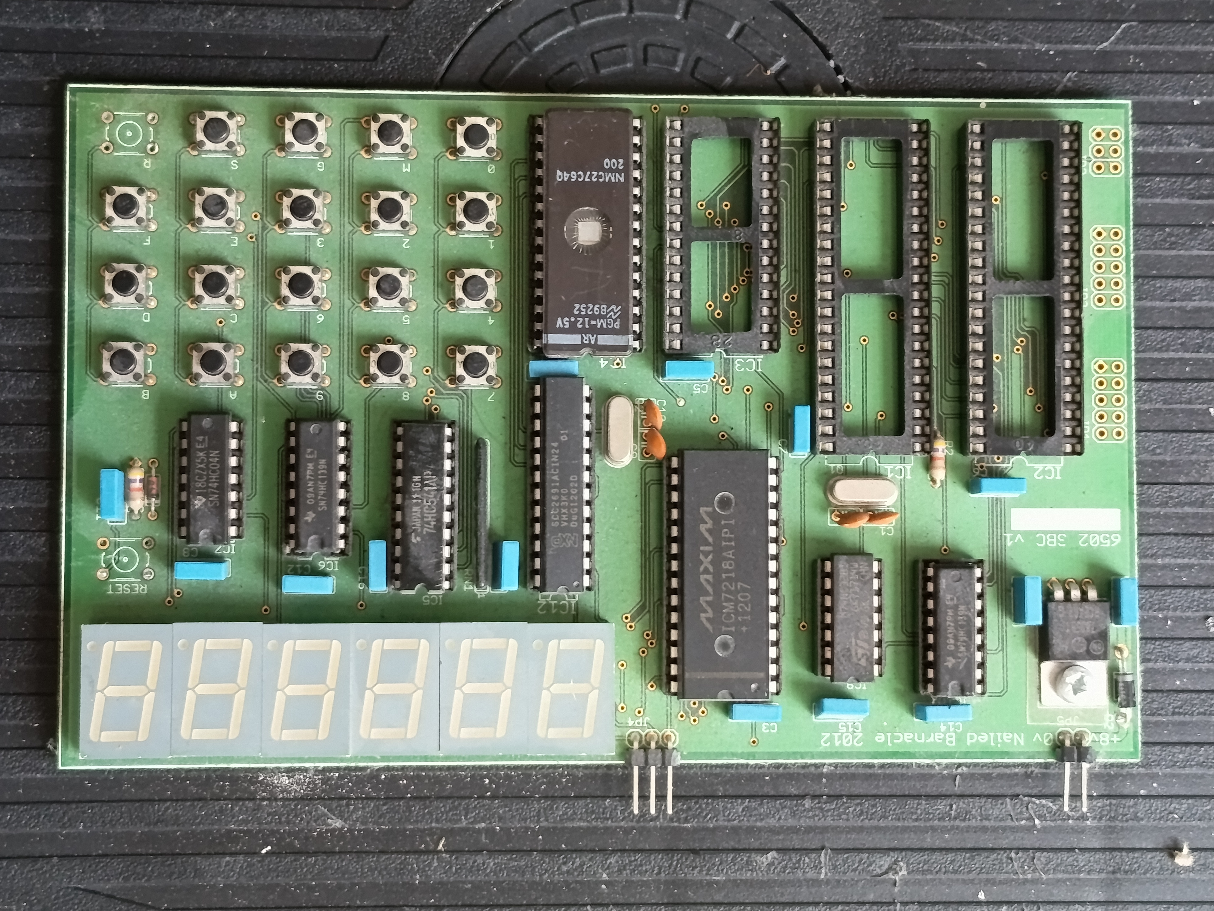

And something I came across in the back of a cupboard from over a decade ago... it's remarkable how similar it looks :mrgreen:

No, it was never completed. It got me the job designing pet feeders; I took it and a couple of other boards along to the interview, the CE liked it and hired me on the spot. I discovered later he had dozens of BBC micros in his attic... :mrgreen:
It's nothing exciting; it used a (now non-available) LED driver and a (now non-available) UART, but - as always - the problem was how to fill the EPROM.
I believe I have now solved that issue, for some values of 'solved'.

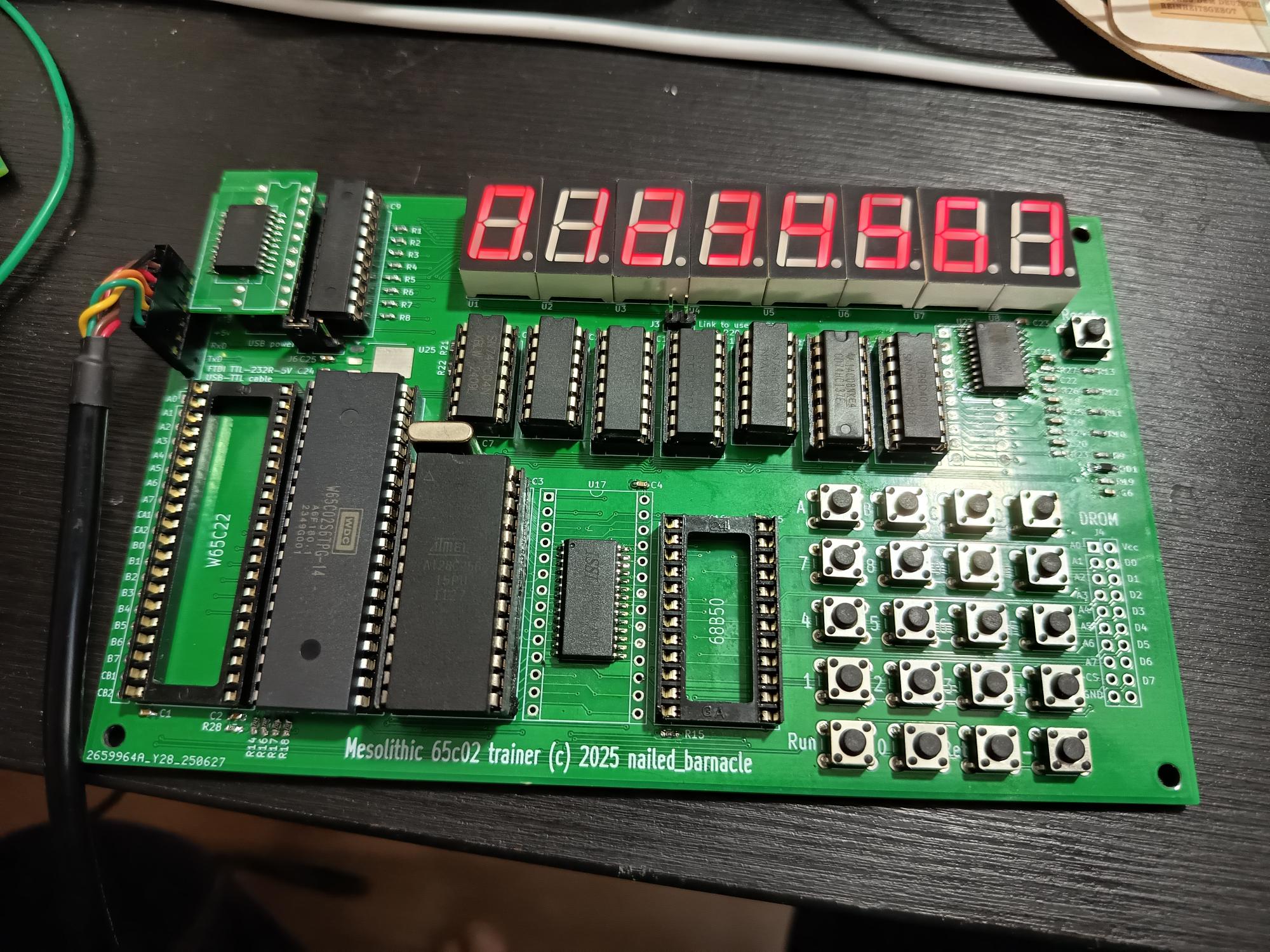

Well, the parts have arrived; the processor board is built, and all the sockets have power at the right places.
I haven't put any silicon on it yet, though :) Maybe tomorrow.

Well, there's good news and there's bad news... the LEDs light up and are multiplexing (different each time I power it) but no changes when I reset it, and no response to any keys. It's running from the EEPROM, and taking a healthy 20-40mA depending how many segments light. Which seems fair...
So now I need to do a little investigation, but first I need to do some more work on the electric paraglider winch (the winch is electric, not the paraglider).

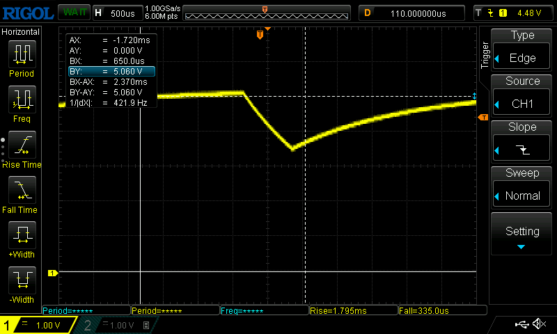

It's up, it's running the original code, though from an EEPROM, not the diode collection yet. The lack of key response was the size of the anti-bounce capacitor; it didn't have time to get down anywhere near a low so for the time being I've nuked them all; there doesn't seem to be any obvious bounce and a final version needs to be a bit smarter anyway.
(this needs to get close to ground, or at least below half rail!)
The lack of general operation looks as it it were a dodgy solder joint in the RAM - remember, I struggled to fit an SOP part on a (narrower) SOIC footprint.
