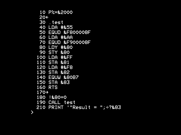

I did a small test on Beeb816, captured a trace using a cheap logic analyzer, and fed this through my 65816 Bus Cycle Decoder.
Here is the test program:
Apologies for not using a proper 65816 assembler:
- 8F cc bb aa is STA aabbcc
- B8 aa is LDA [aa], Y

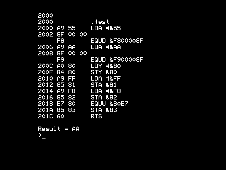

Here's it running:
And here's the cycle by cycle output of the 65816 Bus Cycle Decoder on the captured logic analyzer trace:

LDA [80],Y really does only take 6 cycles, even when crossing bank boundaries.
The 65815 must be handling the increment of the bank address "on the fly" in the data setup time window at the end of cycle 5.
Dave

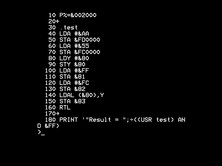

Here's the same test, in BBC Basic 816, which has a full 65816 Assembler built in and runs in native mode:
Same result:

0 b7 O 1 1
1 80 P 1 1
2 80 D 1 1
3 ff D 1 1
4 fc D 1 1
5 aa D 1 1
002018 : B7 80       : LDA [80],Y     : 6 : A=00AA X=4ECB Y=0080 SP=01C9 N=1 V=0 M=1 X=1 D=0 I=0 Z=0 C=0 E=0 PB=00 DB=00 DP=1900
