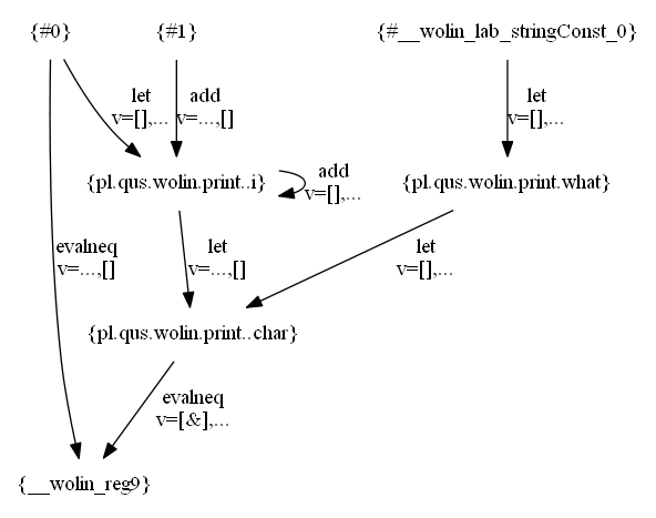

And here's a neat chart I was able to generate for print function with the new optimizer.

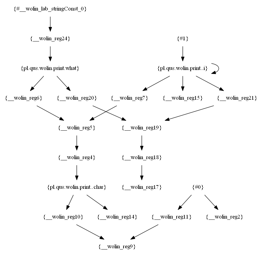

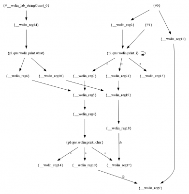

Re: Wolin - a minimal Kotlin-like language compiler for 65xx
Post by qus »
With improved flow diagram now the optimizer is able to find long chains of optimizable registers (compare with attached diagram):
#0 -> __wolin_reg2 -> pl.qus.wolin.print..i
#0 -> __wolin_reg11 -> __wolin_reg9
__wolin_reg5 -> __wolin_reg4 -> pl.qus.wolin.print..char -> __wolin_reg10 -> __wolin_reg9
__wolin_reg5 -> __wolin_reg4 -> pl.qus.wolin.print..char -> __wolin_reg14
__wolin_reg5 -> __wolin_reg4 -> pl.qus.wolin.print..char -> __wolin_reg17
pl.qus.wolin.print.what -> __wolin_reg6 -> __wolin_reg5
pl.qus.wolin.print.what -> __wolin_reg20 -> __wolin_reg19
#__wolin_lab_stringConst_0 -> __wolin_reg24 -> pl.qus.wolin.print.what
Each line means: "each occurence of the penultimate element should be replaced with the first element". Those "chains" also handle reference/dereference gracefully (i.e. keeping them or cancelling them out like in case of *char -> reg10 -> &reg9). That also allows setting redundancy flags:
Redundant:__wolin_reg2
Redundant:__wolin_reg4
Redundant:__wolin_reg6
Redundant:pl.qus.wolin.print..char
Redundant:__wolin_reg10
Redundant:__wolin_reg11
Redundant:__wolin_reg20
Redundant:__wolin_reg24
Note - the chains containing "char" are, of course, wrong, as the char variable should be mutable, but this is only for testing. If I change val to var, the chains won't be as nice.
I guess now I am ready to go with refactoring the old code applying above chains/flow graphs.

And this is the optimizer output when "char" is mutable, as it should be:

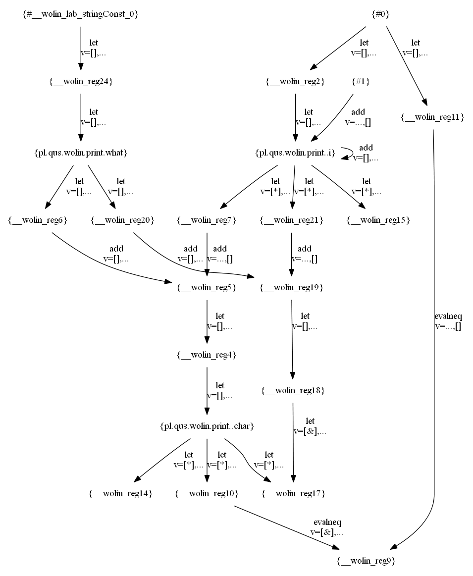

Heh, after playing with long register chains for a few days I discovered that nothing beats my "naive" replacement by pairs. But at least I've learned some logic in reference flow... Anyway - here you can see source and optimized diagram of the very same print function.
Optimized diagram
Optimized diagram
Source diagram
Source diagram
