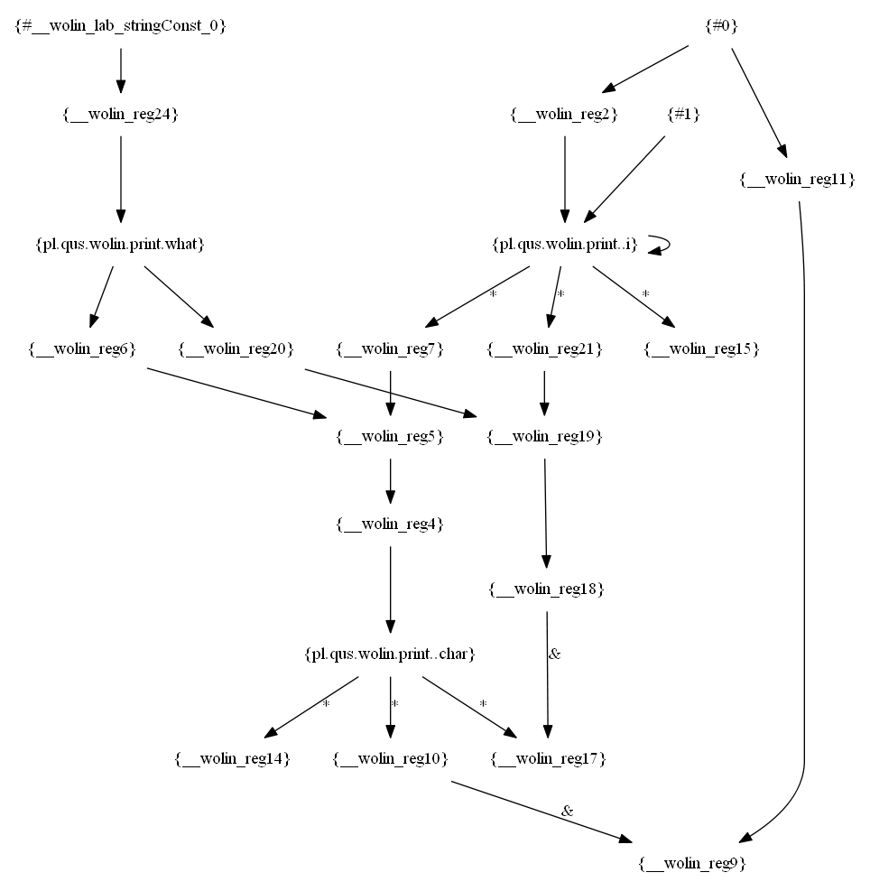

And here's a neat chart I was able to generate for print function with the new optimizer.

With improved flow diagram now the optimizer is able to find long chains of optimizable registers (compare with attached diagram):
#0 -> __wolin_reg2 -> pl.qus.wolin.print..i
#0 -> __wolin_reg11 -> __wolin_reg9
__wolin_reg5 -> __wolin_reg4 -> pl.qus.wolin.print..char -> __wolin_reg10 -> __wolin_reg9
__wolin_reg5 -> __wolin_reg4 -> pl.qus.wolin.print..char -> __wolin_reg14
__wolin_reg5 -> __wolin_reg4 -> pl.qus.wolin.print..char -> __wolin_reg17
pl.qus.wolin.print.what -> __wolin_reg6 -> __wolin_reg5
pl.qus.wolin.print.what -> __wolin_reg20 -> __wolin_reg19
#__wolin_lab_stringConst_0 -> __wolin_reg24 -> pl.qus.wolin.print.what
Each line means: "each occurence of the penultimate element should be replaced with the first element". Those "chains" also handle reference/dereference gracefully (i.e. keeping them or cancelling them out like in case of *char -> reg10 -> &reg9). That also allows setting redundancy flags:
Redundant:__wolin_reg2
Redundant:__wolin_reg4
Redundant:__wolin_reg6
Redundant:pl.qus.wolin.print..char
Redundant:__wolin_reg10
Redundant:__wolin_reg11
Redundant:__wolin_reg20
Redundant:__wolin_reg24
Note - the chains containing "char" are, of course, wrong, as the char variable should be mutable, but this is only for testing. If I change val to var, the chains won't be as nice.
I guess now I am ready to go with refactoring the old code applying above chains/flow graphs.

And this is the optimizer output when "char" is mutable, as it should be:
