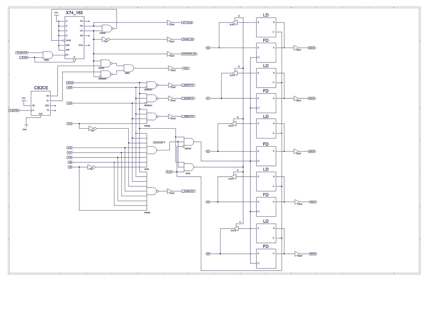

I have taken Leeeeee's suggestion to mirror the write-only register with a zero page register. The loop reads and writes to the zero page reg and then writes to the register inside the CPLD too, Doesn't work. In fact the 5 bit flip flop inside the CPLD is not being written to correctly, ever. I'm focusing now on this issue. The divider clocks in the CPLD are working fine... I've got the display to do a reset and clear. The bank circuit is not working. The previous schematic has only the flip flop (output/write to only), and phase 2 is also being used earlier in the logic path, instead of where it should be, at the very last stage of decoding. I've taken care of that as well in the next schematic, but it still isn't working. Before I start banging my head against the wall, I am going to start the latest schematic from scratch. I went through this process before and all of a sudden the circuit worked... A Xilinx software issue or maybe I'm closing down the software incorrectly...
8BIT wrote:
From the schematic, it looks like a write to DExx loads the upper address bytes. Is this the "bank" variable referenced in your code?
Daryl
The 5 bit bank Reg is @ $DE00 and is mirrored through $DEFF. The 16K window the 65C02 sees (into 512K) is from $8000-$BFFF. In order for this part of my software to work correctly the bank Reg has to be #$00. I have the character fonts and character string data there (They used to be from $F000-$FFF9 on the 8K OS EEPROM.)
Here's the updated schematic (I am trying to use a new (.emf) format so the pic will fit into whatever size screen or CRT you are using).
Edit: The .emf format is not supported by photobucket, sorry for the large pic, but I am tired, soon off to bed. Thanks for the sugg's. I'll work on the pic size... In the schematic below "FD" is a D-type flip flop (like a 74374), and "LD" is a D-type latch (like a 74373), except the clock on "FD" latches the data on the rising edge, and the data on "LD" is transparent on a high "G". Also the tri-state BUFE's on the output of the "LD" latches are active high...

Ok, I was actually wanting a schematic that shows the rest of the circuit - including the CPU, RAM, EEPROM, and CPLD.
As I understand, you want to run the CPU slowly, read an EEPROM and copy it into RAM, using banking to control a window to allow access to >64k. Once done, you want to up the speed and run purely from RAM.
I understand your gating inside the CPLD. It seems as if the LD's can be replaced with a simple tri-state buffer, as the Q outputs of the FD's will always be stable during a read.
I am interested in how exactly the CPU address lines connect to the SRAM.
Is there a multiplexer connected between them to gate the bank register only during accesses to the window ($8000-BFFF)?
If the bank register shown is connected directly to the RAM upper address pins, them I see a huge problem with access to RAM outside the window with the bank register non-zero.
I can explain more if my assumptions are correct.
Daryl

Yes, that is exactly what I am trying to do. Copy the EEPROM to SRAM when running @3.5 MHz, then (for now) running @7Mhz directly from the SRAMs, and your assumption is correct. My A0-A13 address lines are connected from the CPU to the 512K SRAM/EEPROMs, addressing the 16K window. Which window is controlled by the 5 bit flip-flop and has lone control over A14-A18. How would there be a problem when these upper address lines are stable way before the others? (And thanks for your insight into not needing the latches)
I have the schematic posted in this link: viewtopic.php?t=1503&start=75 (it's the last schematic posted, some of the clock signals have changed, but the basic addressing is the same). I tried to put the data and address lines on the same horizontal level, so you can infer that they are connected. I plan on using the Eagle CAM software others have mentioned here, when I am closer to having boards made, which hopefully won't be much longer. Again, thanks for your help 8bit!

So, if it's agreed the concept is solid, I am going to assume it's something with the Xilinx software. I ran into this before, where I had to re-input the whole schematic fresh. The netlists or something else in ISE gets screwy after many modifications to the schematic in between shutting the program down. I'll try it tonight after work and report back..

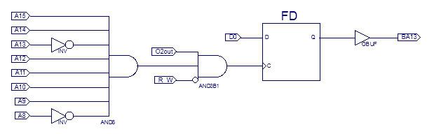

I re-inputted the schematic with the same non-working result... So, to test my wiring and software, I removed the flip-flop and internally grounded all the banked adress lines instead of using the flip-flops, and it worked great, which proves my wiring and software to be working.
So I am thinking it's not as easy as it looks to program a CPLD, even using just schematics. To program a data latch or flip-flop I suspect ISE needs a proper constraints file to group circutis together for a register. Even so, all the flip-flops are set to have an initial 'start-up' output of logic '0', but they're not which is another question mark. I've been working with the constraints editor, but there are so many options, I'm trying to get some headway by posting in the Xilinx forums. I'll have to be persistent, heh :wink: It's probably like asking where my ass is supposed to be.

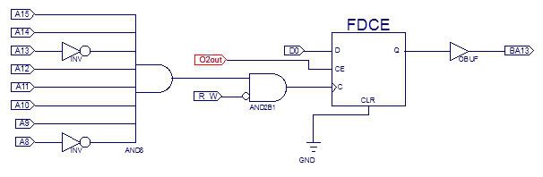

No need to worry about constraint files yet, looks like a can of worms. Turns out I was not using the correct flip-flop.
Got a quick response from Xilinx forums here: http://forums.xilinx.com/xlnx/board/mes ... ad.id=1467
I was having a problem with addressing a flip-flop, actually 5 flip-flops for the banked address. I thought the logic was good, but 2 guys on the forum pointed out I was using a gated clock, apparently not a good idea. To simplify, using 1 flip-flop, this is what I was trying to do:
They suggested I do this, which does work (WOOO!)
Logically I think my original circuit should have worked in the real world using discrete TTL. What do you all think about this?

I'm not so sure that it would normally be accepted by TTL; it would all depend upon the setup and hold times. In general, using the internal logic element's clock enable is always preferable; it is designed to deal with jitter better than the logic elements clock pin.
If you must employ clock gating without the device's support, it is recommended that you always synchronize the stopping and starting phase, to avoid any too-short clock pulses.
By the way, are you sure you're supposed to be running the clock to the clock enable pin, and the enable to the clock pin?
