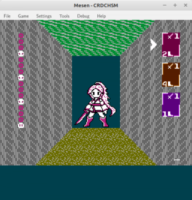

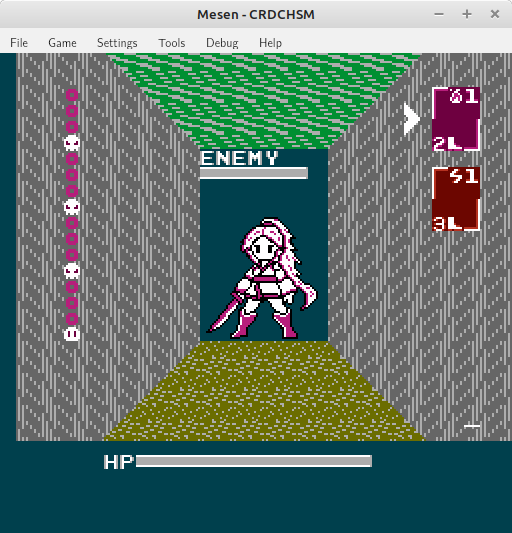

Alright! I'm back on track at this point. The game-state concept is in full roll-out and working better than ever! See attached pics.
You have already seen what I am doing differently above, but there are some particulars I'll share. I have "game_state" which determines which sub-routines I'm running, but I also have "game_delay" which is used on some of the game states to literally delay going to the next state. This is useful for special task game states. For example, "shift cards upward" game state isn't something I'm going to stay in for long, but I want to wait for it to complete. Thing is, I'd rather use the game_delay whenever possible so that I that I have a universal method of calling for delays. The *only* time I'm using a different variable to check to move to another state is the walking effect, because it's variable and changes depending on which card is selected.
tl;dr I'm using a universal delay system alongside the game state to insure uniformity.
At this point I have only the "titles" left to implement from old code to new code. However, I am debating if I will even use them again! I have a lot of space in the bottom HUD, and it might be better putting info down there instead. Castlevania and even Kirby did something like that, where the enemy health bar was actually in the HUD space, not above the enemy's head or something (though for different purposes perhaps).

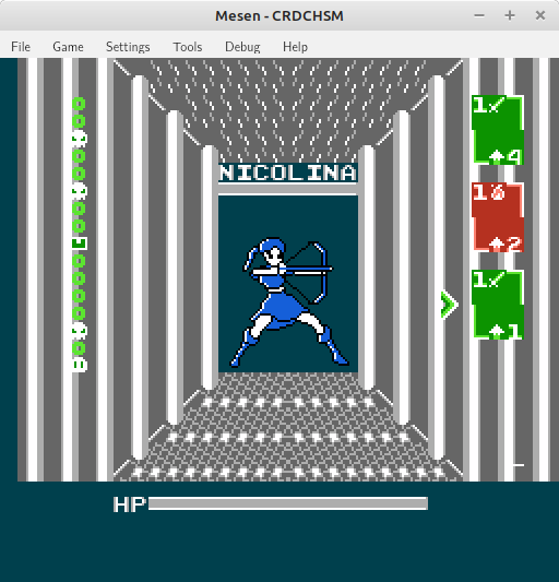

I spent a LOT of time this morning reorganizing my pattern tables. I really wanted it to look more organized, especially my sprites. What I have now is very beautiful on the backend, though you won't ever see that from the user side.
Next up is more attack animations, such as fire, electric, etc, but also healing effects. I need to eventually put in the health bar too, which I think I'm going to use a sprite along with the name table to get a cool 'seamless' effect. Then there are little things like *actually* shuffling the deck, enemy positions, and then the 'campsite' which is kind of like the main menu.
Thanks for the advice earlier, the results are very nice :)

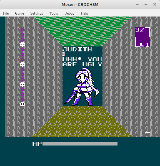

This morning I was able to add some small battle mechanics such as elemental weaknesses, guarding against attacks, healing, and then phrases. In the original game, the enemies sometimes don't attack but say something silly. This helps indicate where they are in their attack pattern and adds some flavor. Not sure how I want to use it, but it's there. See attached.
Two things coming up next:
1) I need to figure out randomizing cards and enemies positions. My random function is not great and it shows: Current = 5 * Previous + 17. I was thinking of making a 256-byte table, but not sure how to use it efficiently. Any moderately simple suggestions are welcome!
2) More enemies. I was able to make it so that I can import new enemy portraits and battle stats very easily, but I need to actually make a dozen or so of them now. And without AI!
After these, the 'main game' is nearing the finish state. I need to make the 'campsite' which is where you switch out cards from your deck and functions as a level select menu. Then different tunnel backgrounds, and save/load features. Getting closer!

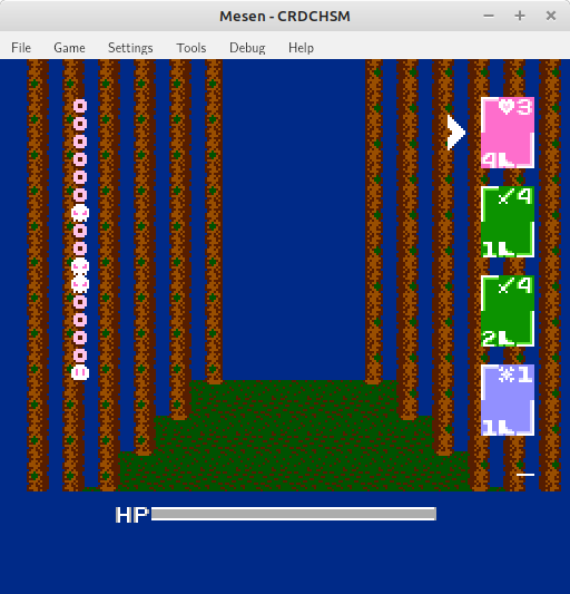

I think I'm learning some techniques on this pixel art. First I go to a Perchance AI Image Generator https://perchance.org/1b4m3f1dvk. I find something I like, then scale it from 512x512 down to 64x64. I add a layer on top and set the original image's opacity to 50%. I then trace with black the outline, adjusting to what I want. Flood-fill white and grey, and red background (transparent). Then lots of cleanup and adjustments to make it look a little better. I definitely can tell I have a style going on here, so at least they all look the same, even if not the greatest.
I'll be working on a new tunnel background now. I'm thinking "trees" as the theme, since I can draw it with or without a ceiling. I also need to redo the randomization again. Instead of the theoretical 25% chance of enemy on a tile, I need to say "1 to 4 tiles between enemies", making it more consistent.
Here in Texas the winter blast is in full effect right now, and we are all very under prepared here, so everyone is staying home and cancelling plans. I suppose it's a good time to code :)
Thanks everyone, for the initial encouragement to do my own pixel art.

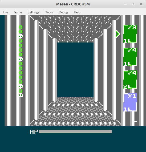

Been doing a lot of artwork! Lots of learning going on :) See attached. I wanted some new levels before I move on to the next thing. My wife helped me with the perspective and little things here and there, but I think I have the hang of it now. I still feel I can alter these a bit to make them even better, but overall the feeling is there and that's what matters.
It's a snow day here in Texas, no school, so I'm at home doing this I guess. The cats beside me look cold since I'm keeping the ambient temperature pretty low, but it's better for the electric grid and I feel like I aught to feel cold if it's actually cold outside :) [ Weird? ]
Thanks everyone!

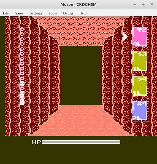

Well, it's been a couple of weeks. This project isn't finished! I just had a different 'project' come up that was time sensitive, and today is the first day back at this :) I have to admit it was a bit hard to get started again this morning, but after an hour or so of fiddling with some code I am starting to feel more engaged.
First I wanted to set up an actual deck of cards, and not just randomized values all the time. After some time I implemented a way to use the cartridge RAM to save whatever cards you have in your deck. But then I realized my card shuffling function was definitely not working, so I fixed that. I also redid the randomization for the enemies on the path, and it is a whole lot better! After all of this I started making pixel art again, see attached. I'm not terribly happy with my 'archer' enemy, but I think the point is getting across. At this point I will just have to come back and touch up on stuff I don't like later.
I want to make 2 more enemies, to total up to 7. I already have 3 levels so I'm good there for now. Then I need to work on the 'campsite' (aka main menu / level select) and finally being able to swap out cards between your deck and sideboard. The original game has a fixed deck of 15 cards and then 5 'booster' cards of your choice, but in my opinion it is just meh because it doesn't allow much customization. Here the player will have a 40 card deck and (right now) up to 64 cards in the sideboard that you can swap in and out. IDK what will happen when the players fill up their sideboard, but we'll come to that later :)
There's the update! Mostly just saying, "This project is still alive!" Thanks everyone :)
