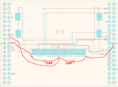

Very strange: things which worked yesterday work only very intermittently today. I'm suspicious of the hardware...
Posts: 3525
Re: Compact flash pinout?
Can you post photos and a schematic of what you're doing? It's a common refrain, I know...
In particular, supply bypassing and the routing of Gnd/Vcc connections may merit special attention. The unstable nature of the behavior you report is consistent with (though not proof of) a signal integrity problem. And I've heard that compact flash devices are challenging in this regard, given the fast switching speeds and the large number of simultaneously changing outputs on the parallel interface...
barnacle
Posts: 1831
Joined: 19 Jan 2004
Post by barnacle »

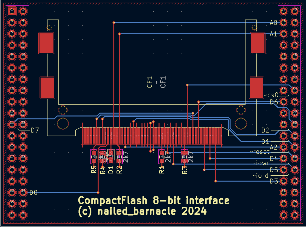

There's a pdf of the circuit diagram of the interface card between a Nucleo and the CF card in an earlier post, Jeff.
I'm not sure how helpful a photo will be: here's the PCB, absent the ground plane where all those red ground connections stick out.
Usual JLCPCB circuit board, double sided, nothing fancy, perched on top of the Nucleo.
I am starting to wonder if the Nucleo is just too slow to drive it; the edges are fast enough, but the access time is coming out around five microseconds. Seems unlikely though.

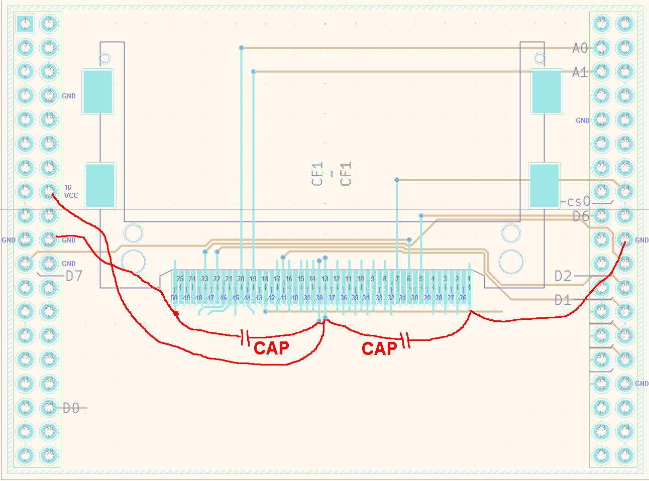

Posts: 3525
That's a thought; perhaps I should slow down the edges!
Hmm. Slowing down the edges output by the ARM pio ports might reduce the symptoms somewhat, but (going in the other direction) you'll still be left with the fast edge rates output by the CF card. :| I like the series resistors plasmo mentioned, but before trying that useful suggestion I myself would begin by bolstering the Gnd/Vcc network.
Neil. you mentioned a ground plane, but -- because it's only a two-layer board -- I suspect your "plane" is what I'd call a pour or a fill. Electrons don't care what it's called, of course. Also, I'm sure the Gnd connections on the CF card do ultimately find their way to the Gnd connections on the headers going to the Neo (and likewise the Vcc pins do ultimately connect). But the route taken by the current flow is important, and a two-layer board can be unsatisfactory unless special attention is given.
As an experiment, if I were in your place I'd just add some wiring (as shown below) to provide additional -- and probably less circuitous -- paths for the current to follow. Also shown are a coupla bypass caps, because IMO that CF card needs to be treated like a big, noisy 74AC Series chip. :!:

barnacle
Posts: 1831
Joined: 19 Jan 2004
Post by barnacle »
Floods, of course, not planes. But the ground is pretty low impedance and direct to both earths (though of course I have no control at the Nucleo side). I don't think the 3v3 is bad, but I wonder whether the 3v3 from the Nucleo can keep up with things; I'll hang a scope on that tomorrow. And the caps aren't a bad idea (though all I have are SM parts, oh well, that's what 26awg wire is for!)

Having added Jeff's suggested extra capacitance, no great change though it _may_ be slightly more reliable than it was; hard to say as it's certainly not 100% working. The 3v3 rail and the ground both show high frequency noise of about 100mV pk-pk, including what looks like a DC-DC converter switching; don't know where that's coming from but perhaps the USB expander power supply? The CF-USB adaptor may be negotiating a higher current availability; I don't expect the Nucleo to do so, but it measures only 50mA or so when idle.
Still no joy for the two cards that didn't previously work, but at least when the SanDisk works it is grabbing the whole of the first sector, matching byte-for-byte the same data extracted via (linux) dd and viewed with hexedit.
Got to go to the UK for a couple of days tomorrow to sort some stuff out, probably will have the IDE adaptors when I return to play with.

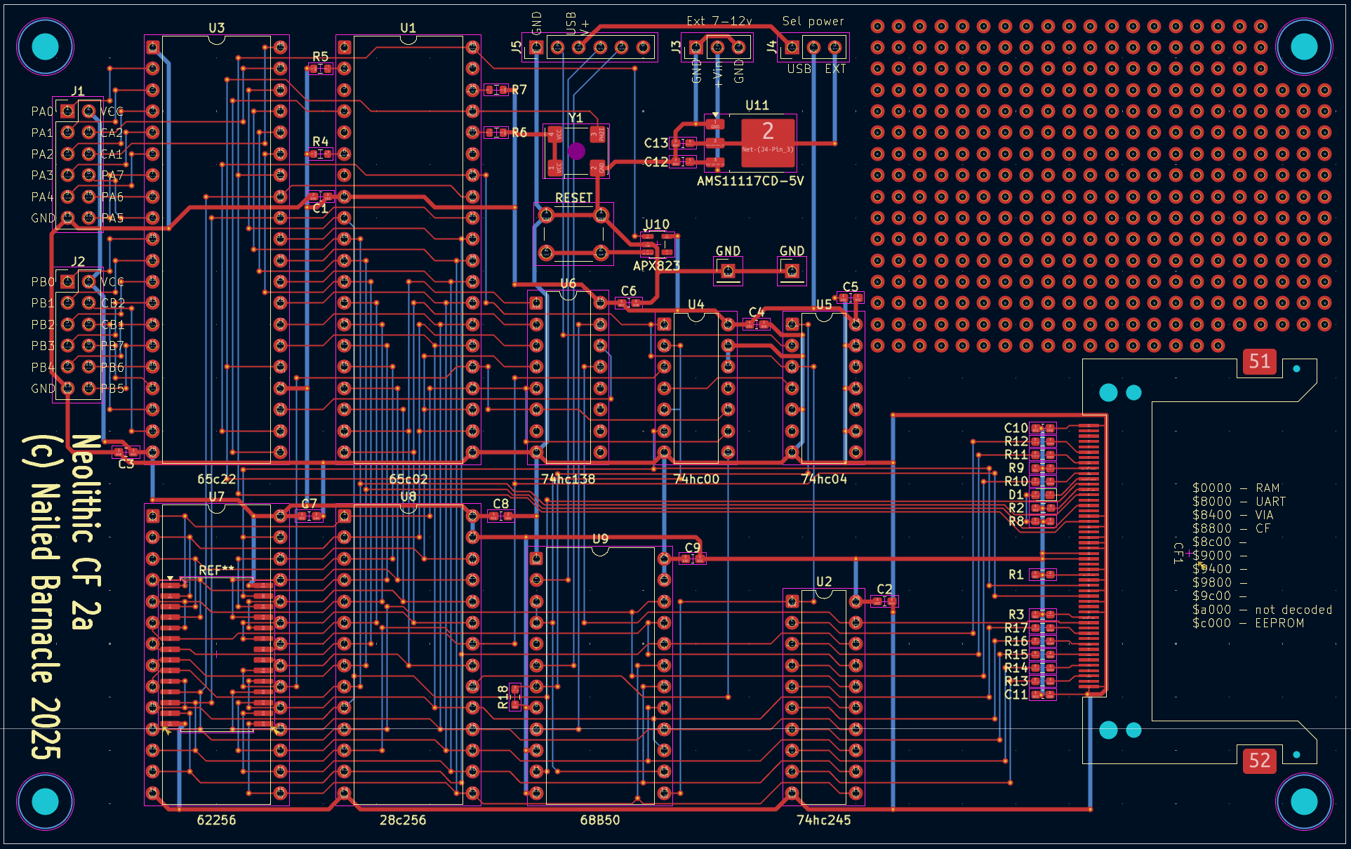

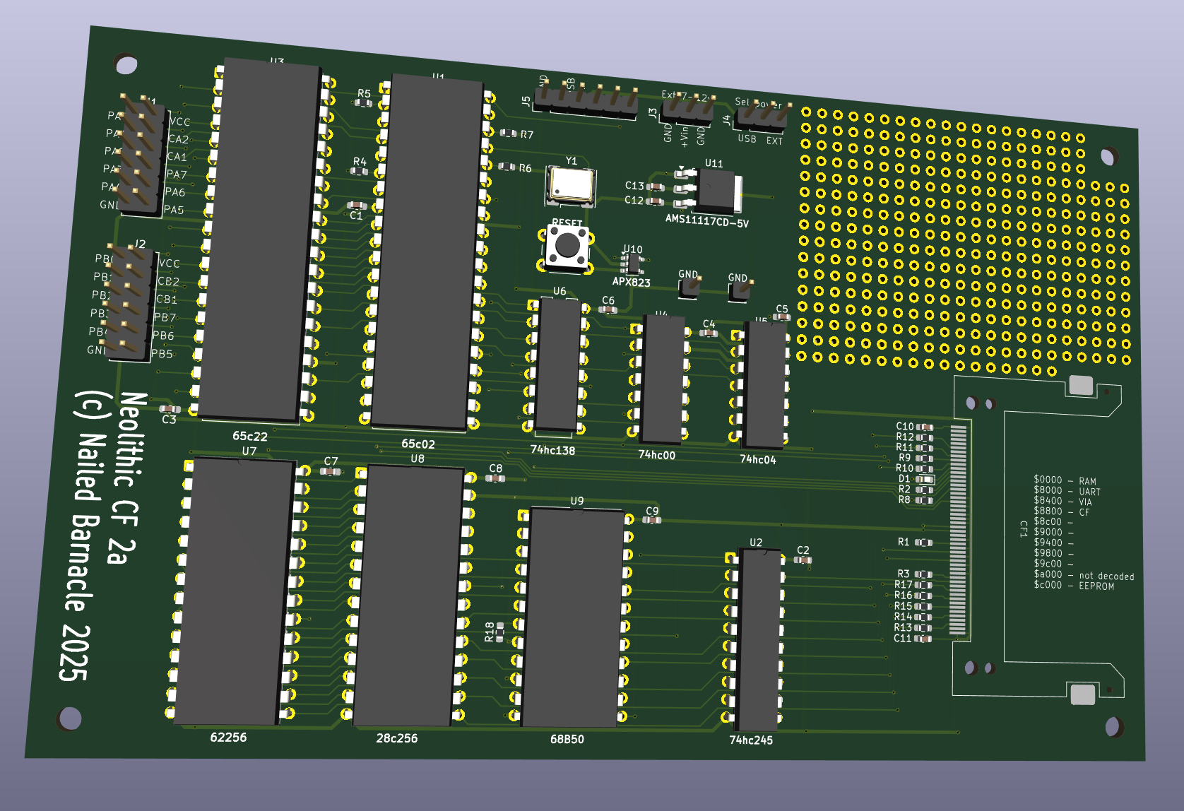

Always the optimist, I've just sent this off to JLC...
6502_cf_2_a.pdf
(584.75 KiB) Downloaded 39 times
Let's see how it goes with a real data bus and address decoding. It runs at 1.8MHz, might run at 3.6 (I will have oscillators at both rates) but that's way over spec for the 68B50. We'll see. There's plenty of room for a few more chips if required.
