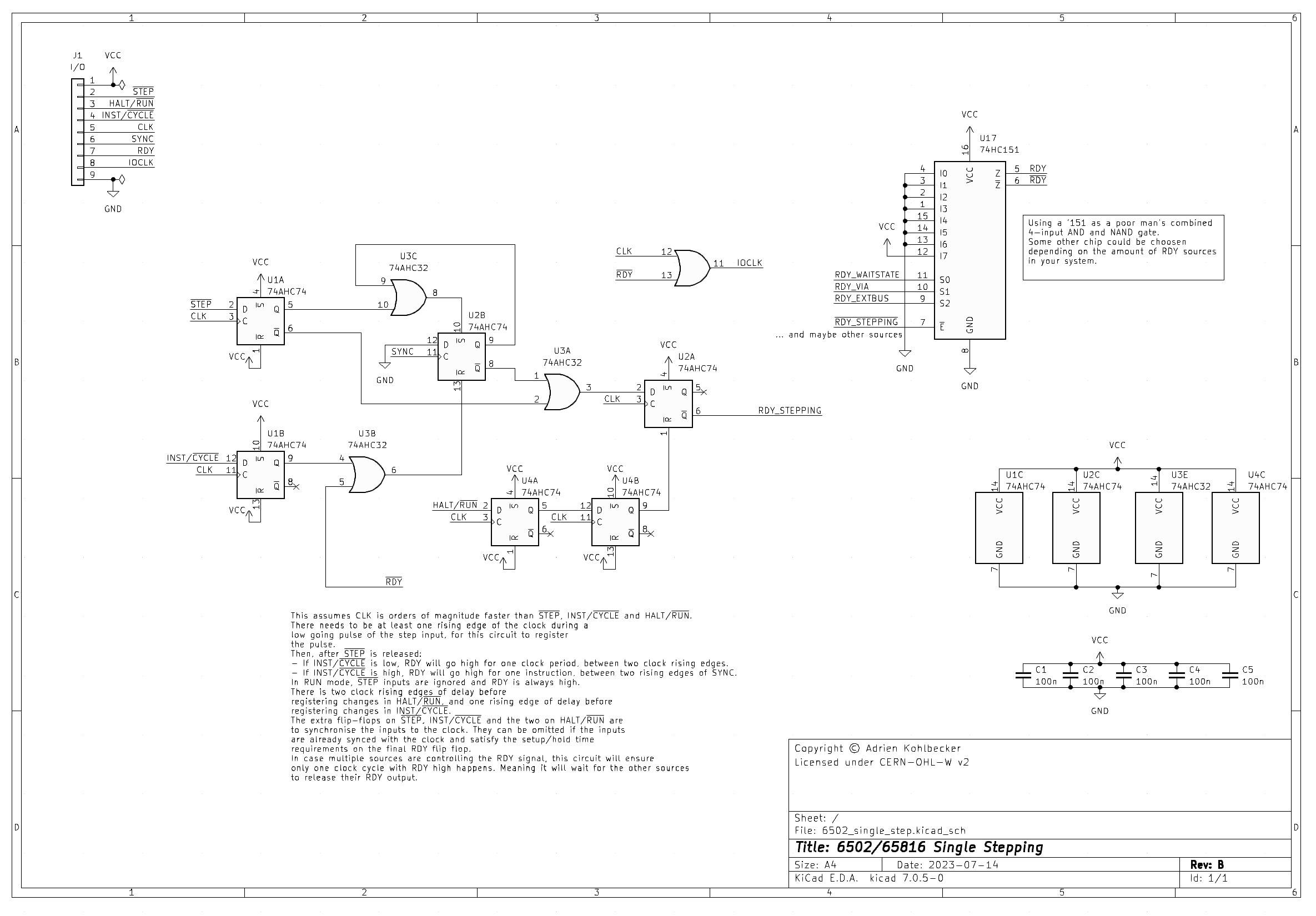

Thinking about how to request an additional RDY cycle for writes led me to consider how to merge multiple RDY sources. The single stepping circuit shown in this thread needs to be updated, because at the moment it takes its feedback input directly from its output.
However, if there are other sources holding RDY low, then they could prevent the single stepped cycle from happening. The circuit should instead wait for all other sources to release RDY, so a valid clock cycle can happen, before activating again.
So, we need update the feedback from U2A to U3B to be the combined /RDY signal, and find a way to AND together multiple RDY sources. Here I've used a '151 to do that.
In instruction stepping mode, the use of SYNC already ensures it reaches a new instruction, so this concern doesn't apply.

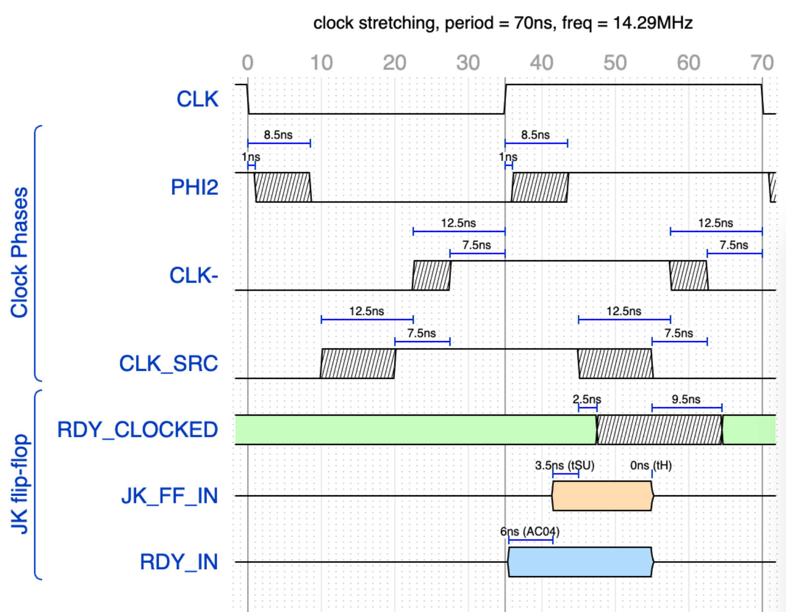

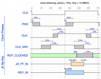

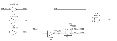

I've been inspired by George's ideas and decided to toy with another way to stretch the clock. The idea would be to have a similar input to RDY, sampled around the falling edge of the clock, but which stretches the clock fed to the CPU instead of going to its RDY input. Thus circumventing the bi-directional nature of RDY and the difficulty to have multiple consumers agree on its state.
So, I came up with the following
On the left, there is my habitual delay line arrangement, generating 3 additional phases of the clock (CLK_SRC is -20±5ns, CLK- is -10±2.5ns and CLK+ is +10±2.5ns, using a DS1035M-10).
On the right, PHI2 is generated from a combination of the input CLK and RDY_IN sampled on the falling edge of CLK_SRC (so 20ns early). The sampling needs to be advanced to give time to the flip flop to propagate. Unfortunately, because the '112 is the only available logic IC I know capable of triggering on the falling edge of the clock, RDY_IN also needs to be inverted, which adds a bit of delay.
All in all, this gives the following timings at 14MHz:

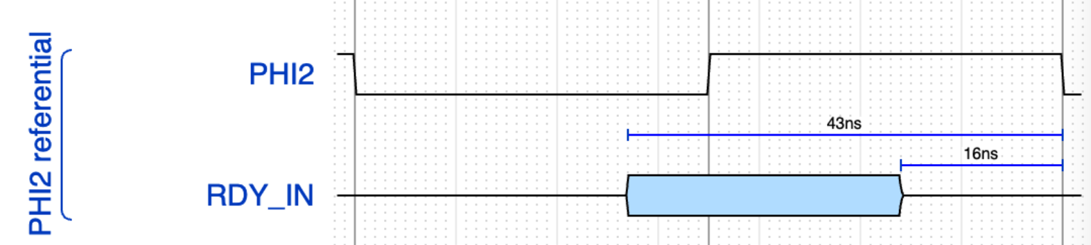

As you can see, all this logic adds quite a bit of delay. If I shift the diagram to the point of view of PHI2, which is what the CPU and the user will see, we get the following
So, my goal of sampling this signal around the falling edge of the clock is clearly not reached :mrgreen: Still, maybe this will inspire other ideas!
