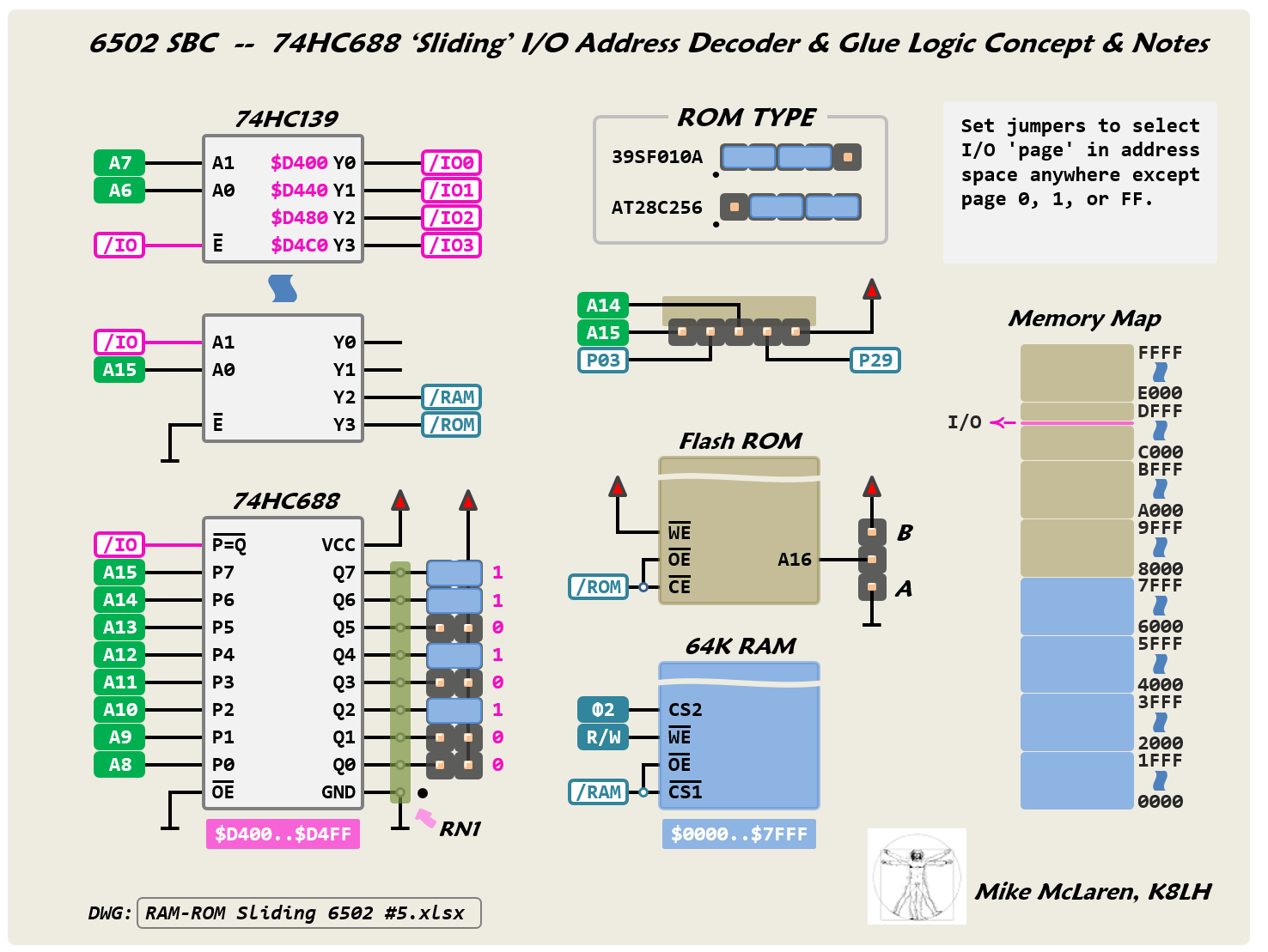

How do you recommend mapping the hole?
Another decoder & glue logic method, if I may, specifically for those 32K/32K RAM/ROM configurations. Note the use of a 64K RAM and its active high CS2 input used to qualify RAM read and write operations.

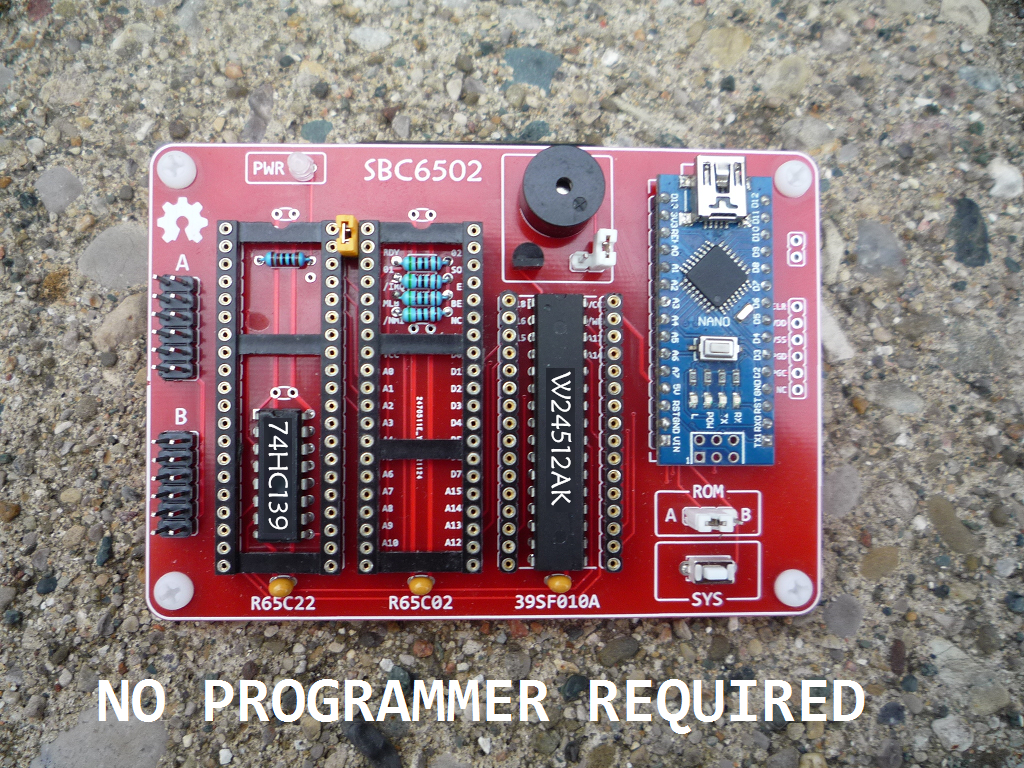

As for programming ROMs, I have an arduino and a raspberry pi. Googling for "arduino eeprom programmer" turns up a lot of results, so I think we're fine there.
May I ask which Arduino you have, please? An Uno R3 or Nano perhaps?
It's a Seeeduino v3, which is pretty much pin compatible with Uno for all intents and purposes. It does have an onboard switch to select 5v or 3.3v operation, which is nice.

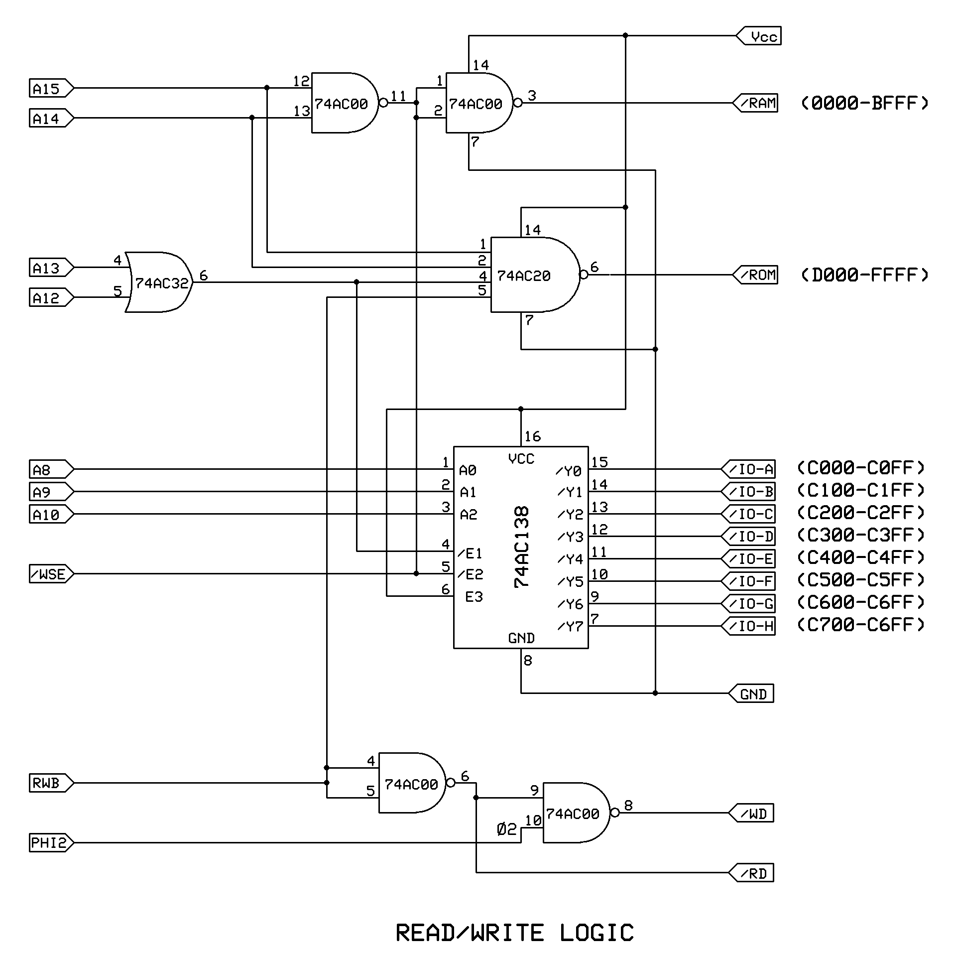

Posts: 9428
Re: shopping list
As designed, your circuit will not work as expected.
You are using Ø2 to qualify chip selects, which is not good design practice. In a 65xx system, chip selection and read/write gating are two separate operations, with the former occurring during Ø2 low and the latter occurring during Ø2 high. Note that everything that occurs during a 65xx bus cycle starts with the fall of the clock.
The MPU drives A0-A15 with a valid address tADS nanoseconds after the fall of Ø2. At that time, the glue logic should decode the address and select the device to be accessed. In particular, chip select and address pins of 65xx peripherals must be valid and stable before the rise of the clock. In your circuit, your 65C22 will not see a chip select until Ø2 goes high and hence will fail to respond.
What does need to be qualified by Ø2 is the write input of non-65xx peripherals, in this case, the SRAM. The data bus cannot be considered valid during Ø2 low and furthermore, the address bus will be briefly unsettled prior to the elapse of tADS. Asserting /WE during that time may result in corruption of RAM contents due to a potential timing race.
Attached is an example of how RAM/ROM and I/O can be controlled in a 65C02 system with three gates and a 3-of-8 decoder. The result is a maximum of 48K of RAM and 12 K of ROM, plus up to 8 I/O devices. This circuit has been tested at 20 MHz.

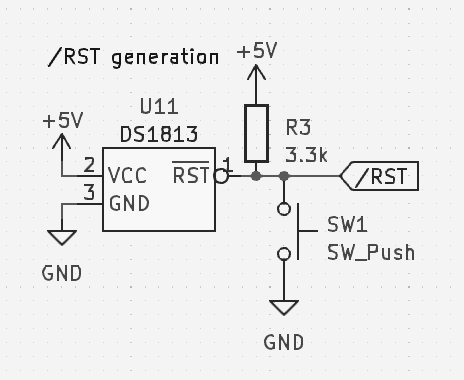

  3. Add a 3.3K pullup resistor to your reset circuit. The DS1813’s internal pullup is weak and relying only on it to keep reset high may make your reset circuit noise-sensitive.
Does that go here?

Posts: 9428
Re: shopping list
Does that go here?
Can you please post that in monochrome? I’m partially colorblind and can’t make out all of what is in your graphic.
allisonlastname
Posts: 88
Joined: 06 Mar 2023
Location: UK
Re: shopping list
Post by allisonlastname »
This better?
