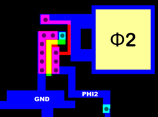

Thank you for this, Dieter. A few questions/comments....
ttlworks wrote:
In NMOS, input protection breaks down to having a resistor on diffusion layer
between the pad and a NMOS FET which switches to GND in case of a negative signal voltage,
before said signal enters the first inverter.
Alright, an NMOS input is protected against an incoming signal that tries to go excessively negative (ie, below Gnd). But is there no protection against a signal that tries to go excessively positive (ie, above VCC)? I guess maybe there isn't, but I wonder if I'm missing something. It seems to me that would still be a significant hazard. (And as you say, a CMOS input does have both protections.)

Hi Jeff, thanks for dropping by.
For NMOS input protection, Frank and me only have seen a NMOS FET
in our previous chip dissections, which was wired up to work as a diode
for clobbering negative voltages to GND.
NMOS input protection conceptually allways had looked more or less
like the PHI2 input pad protection in the 6520:
Never by 90° ??? I wonder, could this be because their CAD tool was simply too primitive? How quaint! :P (But they still managed to get the job done, which is what matters.)
Never by 90°, and I don't know why.
But it made identifying the logic gates quite fast...
...except that I initially had mistaken the two NOR gates as NAND gates.
One has to zoom in quite close to spot the little difference between
CMOS NAND and CMOS NOR in the metal layer.
