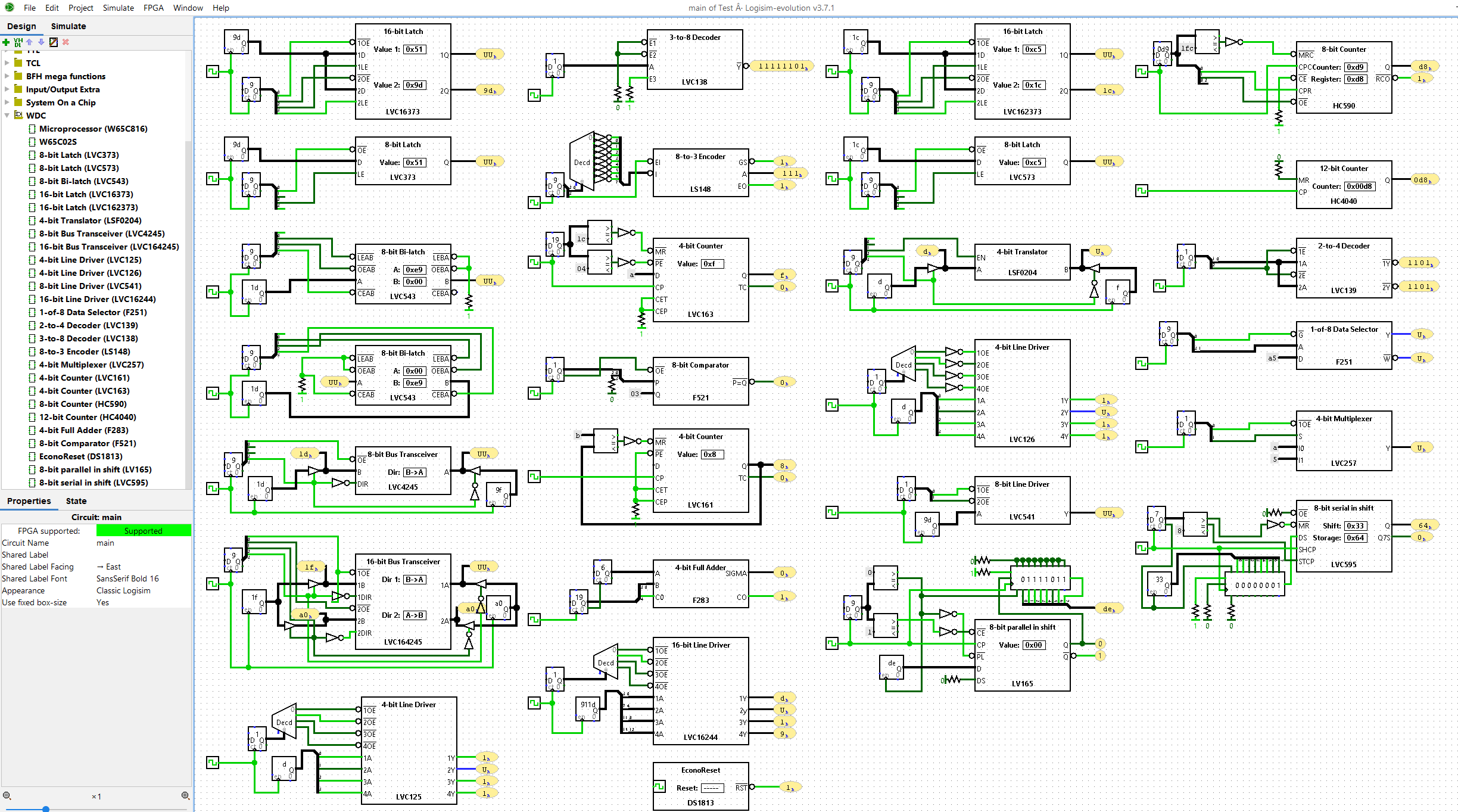

A quick update on this project.
My pull request was accepted (after a bit of back and forth). I still don't believe I can be the first person to run into the propagation/timing issue I had and that means there must be a better (besterest practices) way of simulation MCUs. For now everything works and seems quite stable so I'm going to call the 65C816 part of the simulation complete.
I'll do a general public release when the next version of Logisim Evolution is released (it should have my changes in it).
I've also coded up all the other ICs I think I'm likely to use (greyscale link).
Unfortunately due to the way Logisim's libraries are laid out everything has to go into a single folder and that will be forevermore 'WDC'.
If anyone has any suggestions for ICs I should add (or useful chips I should be using) feel free to post them here.

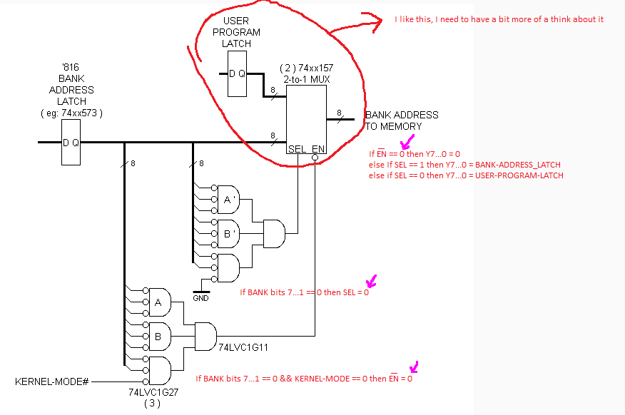

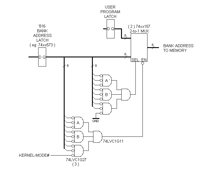

I'm a little puzzled as to the nature of this decoding that'll supposedly take so long.
More handwaverey! Although in this case the answer is: 'kinda virtual memory'. And this is also a problem that will need it's own thread sometime...

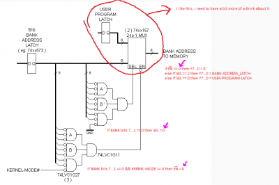

Basically I want to allow user programs to have their own stacks entirely transparent to each other. To do this I remap accesses to bank zero based on the currently set user program latch. For example user program $FF bank zero might map to bank $02 so when address 00:801B appears on the bus it will be dispatched to memory address 02:801B instead. Whereas user program $FE maps to bank $04 so address 00a:801B is dispatched to 04:801B.

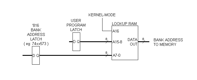

A more general solution is to take a 16bit number, say $FF00 with the upper 8 bits being the user program number and the lower 8 bits being the bank, and then use that as an address read into a memory location that contains $02 and then slip that into the actual bank address going out to main memory. This means I could remap $FF01 to main memory bank 03 et cetera...
And now I've way over explained that I'm basically treating the first bank of kernal RAM (funnily enough that is 128KB of private RAM per 65816) as a 16bit to 8bit map. For every memory access I have I have to do an additional memory access and, well, that makes for pretty slow decoding. It does seem to work in the simulation but the proof will be once I've built the thing. If it doesn't work then I'm chocking it up to experience and an interesting tangent that I didn't really mean to follow.
An interesting problem is that kernal mode can only be entered via interrupt - it's VPB going low that sets the kernal mode flip-flip. And once in kernal mode bank zero is the real bank zero which means that the interrupt stack has been left in another different bank, a bit of a problem for RTI. The solution (so far) is to ensure that every bank that contains program code contains the interrupt handler routine. Jjust last few bytes of it at the same location in the user bank so that when the kernal mode flip-fop is cleared and memory addresses get remapped into that user bank then the final RTS is still called. More problems occur when IRQs happen in kernal mode - I need to keep track of how many IRQs deep I am to ensure I RTI from the right stack. And I have an NMI problem that I haven't solved yet; I intend to drive the process scheduler using NMIs and all hell breaks loose if that occurs whilst any other interrupt is occurring or being returned from...
Hmmm, alright... But it doesn't sound too terribly time consuming. If I'm understanding properly then the circuit below is one possible way to manage the matter.

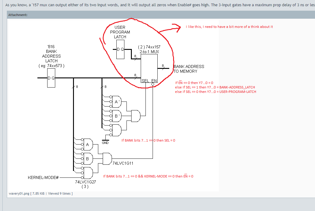

As you know, a '157 mux can output either of its two input words, and it will output all zeros when Enable# goes high. The 3-input gates have a maximum prop delay of 3 ns or less. And the circuit can be simplified slightly, as gates A and B do the same as A' and B'.
And you mentioned 128KB of private RAM per 65816 -- not 64K.
So, I assume it's the Kernal Mode signal that provides the additional address bit, like this:
This approach takes good advantage of the cheap, fast RAMs that are available nowadays. What's missing in the diagram is circuitry for writing to the RAM. Dual-port RAMs are not so cheap; but, with some clever glue applied, a conventional RAM would suffice.
What I'm wondering is why you feel so many CPUs are required. I understand your explanation of the staggered clock phases. But to me it'd seem preferable to have one very busy CPU (and perhaps a DMA unit). If the decode delays truly were as bad as you supposed then multiple CPUs would start to make sense. But I'm not convinced the decode delays are so terribly severe. Just my two cents worth!
Okay, and of course VPB doesn't go low until after PB, PC, and P have been pushed to stack.

Okay, and of course VPB doesn't go low until after PB, PC, and P have been pushed to stack. ... Would it help your cause if the circuitry could be made aware of the interrupt before
Absolutely! I think, without a redesign of the simulation yet, that that would be good solution to all my interrupt problems.
Kinda but I also want to be able to read and write to it as normal memory when in Kernal mode. And that makes things complicated. I'm not sure it's worth the complexity yet so I'll quote your schematic when I post a thread on the private memory workings. On that, the reason I'm using 128K private SRAM is because I have a bunch of IS63WV1288DBLL-10TLIs knocking about. Quite fortunate as that gives me 64K for the kernal and 64K for the User-Bank map.

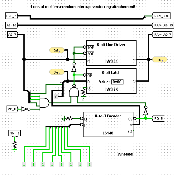

Would it be helpful to also detect software interrupts -- ie, BRK and COP? To detect these, you need to actually snoop the opcodes ingested by the processor. In fact you can detect any opcode you like, and respond with all sorts of shenanigans, including the simple and the sophisticated!

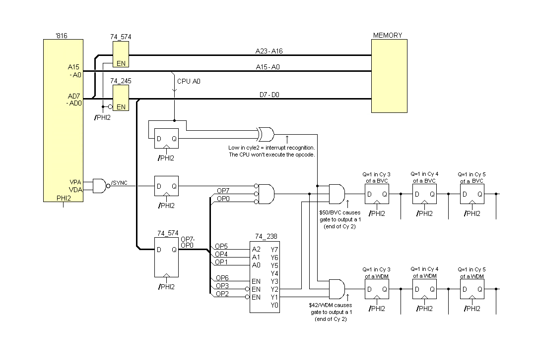

I've marked a few typos in the diagram below.
Thanks! ... and I even drew the bar on EN, you'd think I would have twigged that something was a bit off :?
Again absolutely! I'm assuming it's going to something along the lines VPA & VDA & PHI2-is-about-to-go-low & (D == 0 | D == 2). If you could give me a few pointers on how to practically do that that'd be great. I get the feeling there may be timing gremlins in there. (Actually I had a walk after typing this and realised I only need to detect the BRK or COP before the stack manipulation cycles start so the timing might not be that tricky).
Alright, to explain I've adapted a schematic excerpt from another project. This logic watches for opcodes $50 (BVC) and $42 (WDM) being executed, but minor changes would allow you to look for BRK and COP instead. And because we need to be sure the opcode really is executing, we mustn't get fooled by the beginning of an interrupt sequence, in which case an opcode will be fetched but ignored. Therefore we keep a lookout for the beginning of an interrupt sequence by monitoring A0 as explained upthread. If A0 fails to toggle following an opcode fetch then we know an interrupt is about to be recognized.
What we have is a pipeline which advances on the falling edge of Phi2.
  • In cycle 1 the opcode is being fetched from memory.
  • In cycle 2 the opcode appears on output of the 574 and is decoded by the '238 and the gates.
  • The output of the gates moves down the pipeline on the following cycles, appearing successively on the outputs of the individual flipflops.
Variations are possible, of course, but this explains how hardware interrupts can be detected prior to the vector fetch. It also explains how execution of any specific opcode can be detected.
