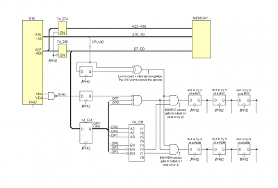

An interesting problem is that kernal mode can only be entered via interrupt - it's VPB going low that sets the kernal mode flip-flip. And once in kernal mode bank zero is the real bank zero which means that the interrupt stack has been left in another different bank, a bit of a problem for RTI. The solution (so far) is to ensure that every bank that contains program code contains the interrupt handler routine. Jjust last few bytes of it at the same location in the user bank so that when the kernal mode flip-fop is cleared and memory addresses get remapped into that user bank then the final RTS is still called. More problems occur when IRQs happen in kernal mode - I need to keep track of how many IRQs deep I am to ensure I RTI from the right stack. And I have an NMI problem that I haven't solved yet; I intend to drive the process scheduler using NMIs and all hell breaks loose if that occurs whilst any other interrupt is occurring or being returned from...
Okay, and of course VPB doesn't go low until after PB, PC, and P have been pushed to stack.
Would it help your cause if the circuitry could be made aware of the interrupt before the pushes to stack occur? This is possible for both hardware and software interrupts, hardware interrupts being easier to detect. The tipoff for hardware interrupts is the failure of PC to advance as it usually does following an opcode fetch cycle (VPA=VDA=1). If PC doesn't advance then A0 will fail to toggle, and this is easily detected. It tells you the opcode will be discarded and instead an interrupt sequence is about to commence.

Okay, and of course VPB doesn't go low until after PB, PC, and P have been pushed to stack. ... Would it help your cause if the circuitry could be made aware of the interrupt before
Absolutely! I think, without a redesign of the simulation yet, that that would be good solution to all my interrupt problems.
Would it be helpful to also detect software interrupts -- ie, BRK and COP? To detect these, you need to actually snoop the opcodes ingested by the processor. In fact you can detect any opcode you like, and respond with all sorts of shenanigans, including the simple and the sophisticated!

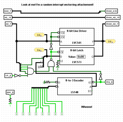

I've marked a few typos in the diagram below.
Thanks! ... and I even drew the bar on EN, you'd think I would have twigged that something was a bit off :?
please attach images with your post, rather than using a third party site like Imgur.
Can do. And this is kinda why I'm posting to this thread... I'm trying to work out how to make attached images appear in the text rather than at the bottom.
Hmnmm, I'm going have to play a bit more to make things look pretty. Is there anyway to not have the attachment preview itself? Oo! Maybe [EDIT: Right click and open image in a new tab - it's now hosted on this forum] [MORE EDIT: Nope the forum software didn't like hosting the image without it being an attachment in this post.]
Again absolutely! I'm assuming it's going to something along the lines VPA & VDA & PHI2-is-about-to-go-low & (D == 0 | D == 2). If you could give me a few pointers on how to practically do that that'd be great. I get the feeling there may be timing gremlins in there. (Actually I had a walk after typing this and realised I only need to detect the BRK or COP before the stack manipulation cycles start so the timing might not be that tricky).
Alright, to explain I've adapted a schematic excerpt from another project. This logic watches for opcodes $50 (BVC) and $42 (WDM) being executed, but minor changes would allow you to look for BRK and COP instead. And because we need to be sure the opcode really is executing, we mustn't get fooled by the beginning of an interrupt sequence, in which case an opcode will be fetched but ignored. Therefore we keep a lookout for the beginning of an interrupt sequence by monitoring A0 as explained upthread. If A0 fails to toggle following an opcode fetch then we know an interrupt is about to be recognized.
What we have is a pipeline which advances on the falling edge of Phi2.
  • In cycle 1 the opcode is being fetched from memory.
  • In cycle 2 the opcode appears on output of the 574 and is decoded by the '238 and the gates.
  • The output of the gates moves down the pipeline on the following cycles, appearing successively on the outputs of the individual flipflops.
Variations are possible, of course, but this explains how hardware interrupts can be detected prior to the vector fetch. It also explains how execution of any specific opcode can be detected.
