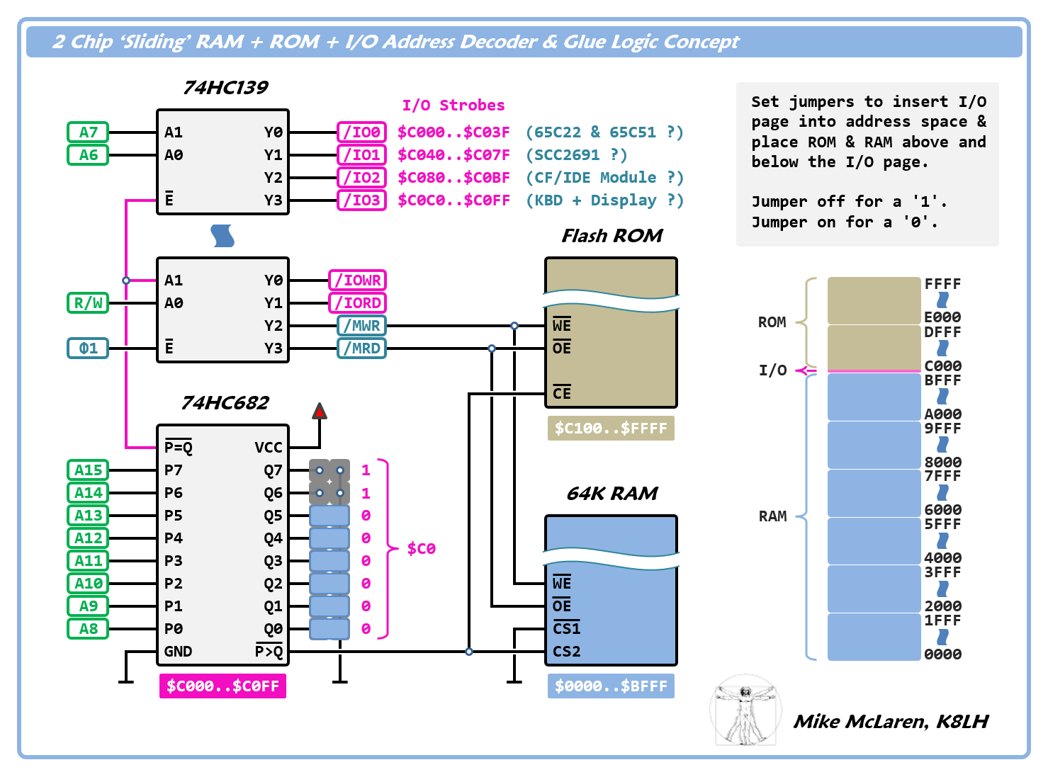

I've been lookin' at the 74HC682 as part of a 2-chip jumper configurable decoder + glue logic solution (including four I/O device select outputs)... Compared to the 74HC688 it has an additional active low P>Q output that I use to drive both the active low FLASH ROM /CE input and the active high SRAM CS2 input. While RAM or ROM is selected every clock cycle, half of a 74HC139 decoder is used to route PHI2 qualified /MRD and /MWR signals to memory only during clock cycles with an address above or below the I/O page address. The other half of the 74HC139 is used to provide four I/O strobes spanning the I/O page for peripheral ICs.
Good luck on your project.
Cheerful regards, Mike, K8LH

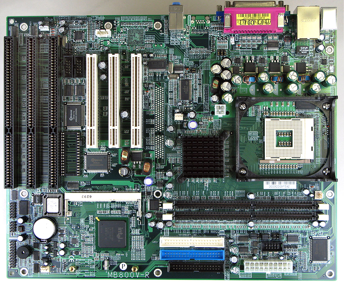

Serial port... yup, no modern PC uses them anymore
https://adek.com/product/MB-800V
They're making brand-new motherboards with RS-232 ports, a parallel printer port, onboard VGA, 3 ISA slots, 3 PCI slots, Ethernet, two IDE controllers, a floppy-disc drive controller, plus USB and all the modern stuff. I want the ISA slots for my EPROM programmer, and for a Trident 8900 video board for hi-res in DOS if the onboard video chip set isn't Trident-8900-compatible. My DOS machine's motherboard went down, and I replaced the computer with another old one I had here but I don't have all the functionality back. If I get this new one, it should be good for as many years as I continue dong this stuff.
Re: Single 6522 for a few applications
I think I'll get one of these:
If you do get it, I may ask that you to perform a test to determine whether the floppy controller can handle single density formats.
