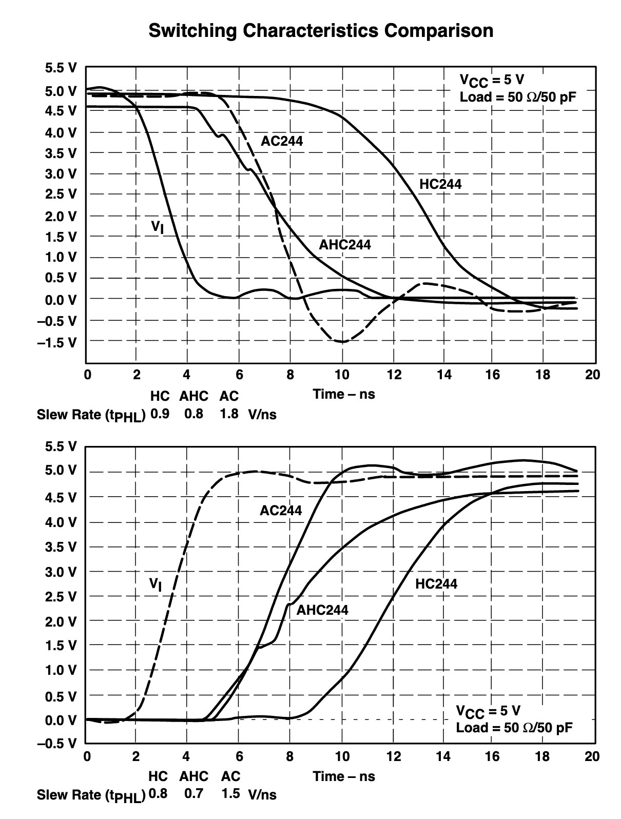

WDC specifies that the rise/fall time for the Ø2 clock should not exceed 5ns. That's generally not achievable with 74HC logic.

akohlbecker wrote:
This is what the clock looks like now
Based on these numbers and assuming a 10% to 90% rise I'm getting the following rise/fall times, which shows HC being ≤ 5ns.
Do you have another source I could look at that point to the contrary?

They seem to be tunnel-visioned on the '244 and '245. If you look at their data sheet for the 74HC74 (which you're using in your clock circuit), table 6.6, you'll see a max transition time of 13ns @ 6V and 25°C, up to 22ns @ 4.5V and -55°C to 125°C, both with a load capacitance of 50pF which is probably in the ballpark for what you'll be driving with it. It might work, but it's definitely not guaranteed to.
As Garth said, TI used a single piece of logic (the '244) as an (atypical) example. The slew rates they tabulate in that graphic don't agree with the curves and in the case of 74HC, I know from observation and experience that a slew rate of ~5ns rail-to-rail not attainable in a practical application.
Although I mostly recommend the use of 74AHC logic with new builds—the prop times are comparable to 74AC, but slew rates are less aggressive, the clock generator flip-flop is an exception—74AC continues to be my choice there. Some series resistance between the flop's outputs and the rest of the circuit can mitigate ringing, which may be a significant problem on a breadboard. I've found 100-120 ohms is usually sufficient. A pair of fast Schottky diodes on the outputs may also help suppress ringing, although resorting to that technique usually isn't necessary on a well-designed PCB.
Interesting point about that transition time. I've since then switched to a 74HC151 as output driver but the figure is comparable. I might have to go to a 74AC151 then, even though that one doesn't have a published transition time figure...

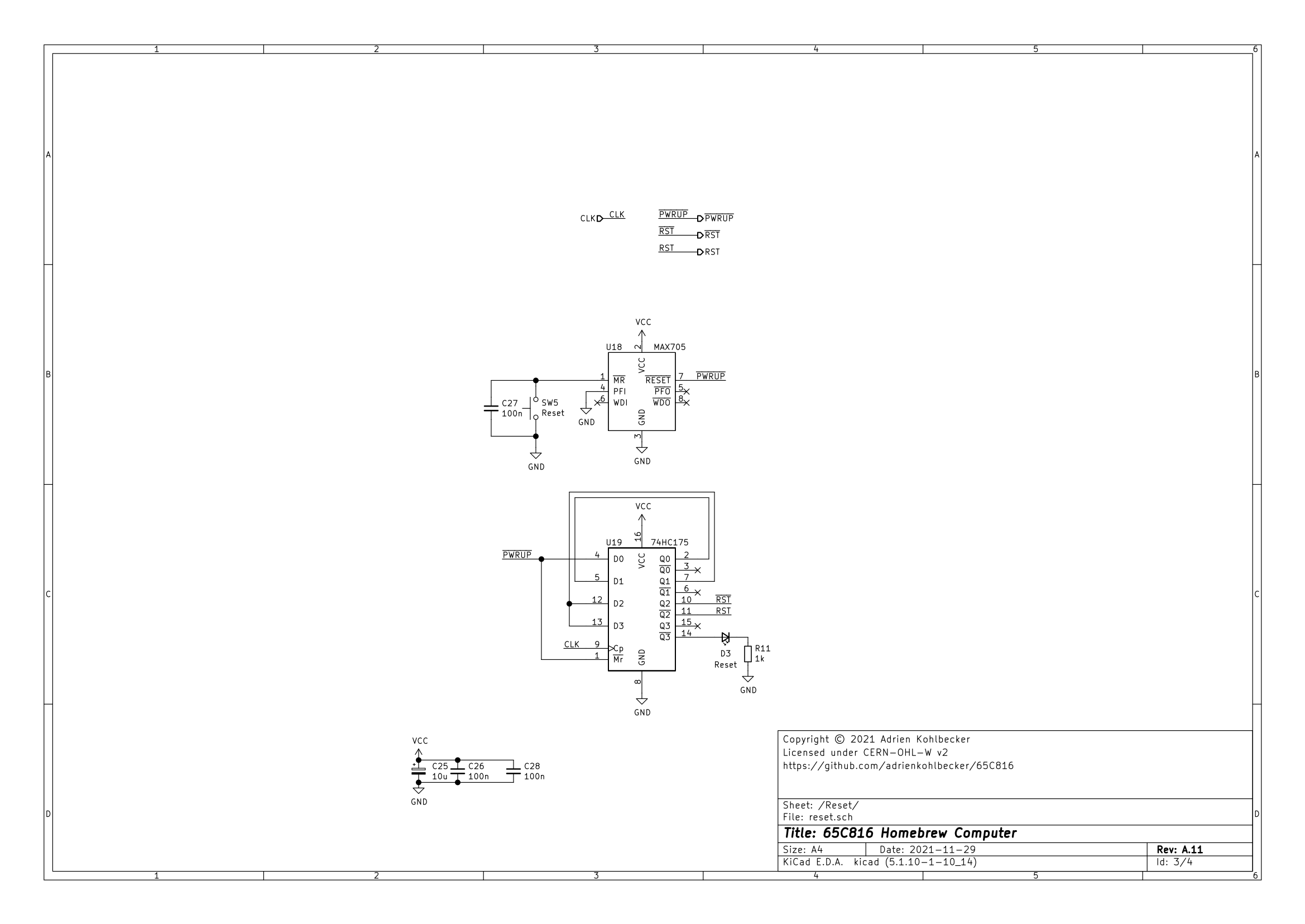

Ok, I need to be more diligent about posting updates here as I publish my videos, I'm two episodes behind.
In Episode 10 - Power-up Reset I build a power-up circuit using a MAX705. Even though I used a DS1813 in my 6502 build, I like the MAX705 here for its watchdog, and separate manual reset input.
I also had to make sure that reset pulses would be registered by the CPU even if I'm running with a slow or manual clock. For that I chained the reset through 3 flip flops, to ensure it stays low for at least 2 full clock cycles.
Here is the final reset circuit:

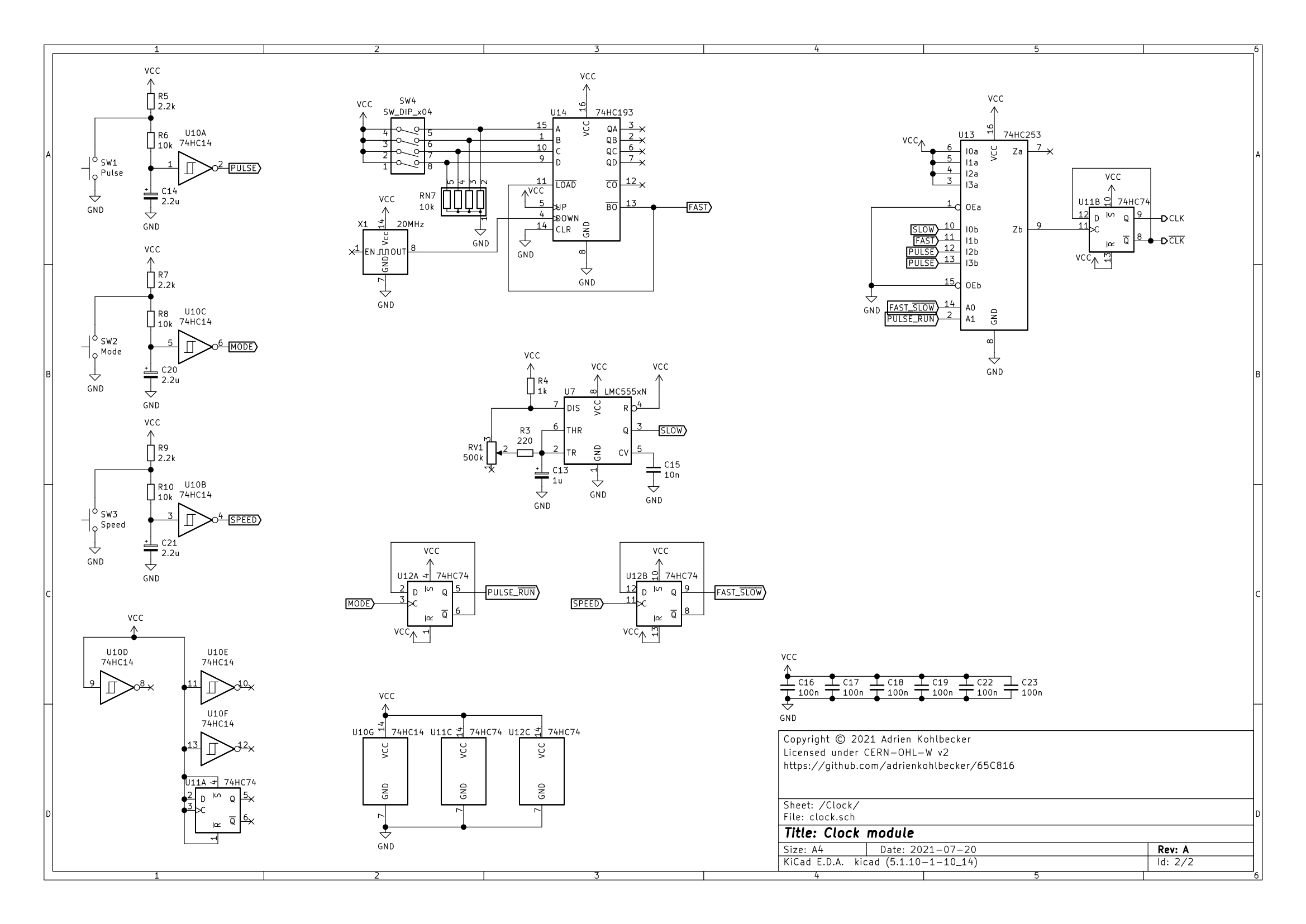

Next, in Episode 11 - Clock Module #3, I went back to the clock circuit and added glitch-free clock switching. By relying on the property that my clocks have vastly different frequencies, I'm able to ensure I always switch when a low-cycle of the destination clock begins and overlaps with a low cycle of the active clock. For that, I used a chain of negative edge triggered JK flip flops. I also had to change my output stage to a 74HC151 multiplexer, which is nice because it keeps the inverted output I had on the 74HC74
I also added a dip switch to select which clock mode and speed the circuit boots in on power up, so I can change it based on what I'm doing (hardware, software...)
Here is the current clock circuit

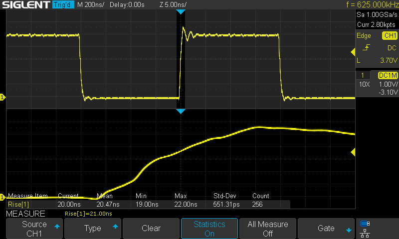

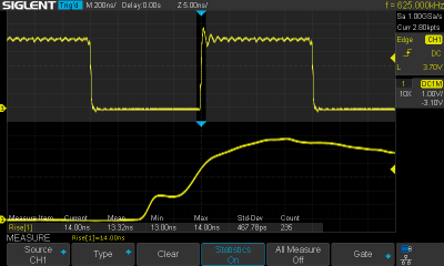

I have done some measurements on rise times, to compare a 74HCT151, 74AC151 and 74AC151 + 100 ohms series termination. My oscilloscope might not be good enough for this measurement (100MHz bandwidth), so take this with a grain of salt:
Looks like switching to AC reduces the rise time a bit (14ns->10ns) but then adding termination increases it (10ns->20ns).
How much should I trust these measurements? Probably not much based on the bandwidth of my oscilloscope and the fact that this is on the breadboard?
