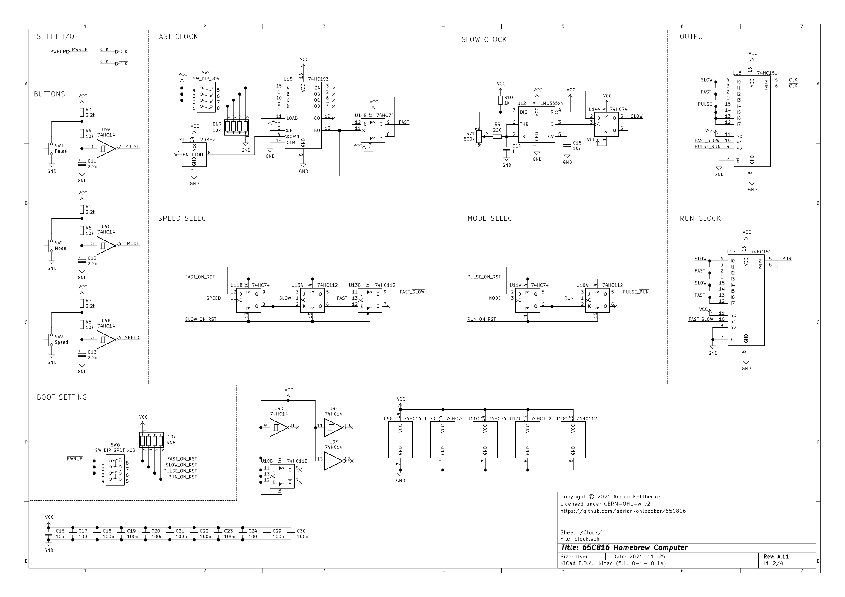

Episode 8 is online!
In this episode, I start building the clock module. I have bigger goals for this module than just running my 65C816 as I plan to re-use this design elsewhere, so you could say this will be a mini-series within the series:
  • 3 clocks: fast, slow, pulse
    • Fast: from ~1MHz to 14MHz via DIP switch (progressively ramp up the speed and reach 14Mhz)
    • Slow: from 0.5Hz to 500Hz via potentiometer (for blinking lights!)
    • Pulse: one clock pulse per button press (for single stepping)
  • 2 selection buttons: mode (free running / pulse), speed (fast / slow)
  • Clean clock switching (no switching in the middle of a cycle)
  • HALT line (stops the clock until RESET)
  • BRK line (switches to pulse mode)
  • Power up behaviour configurable via DIP switch (=which mode and speed on power up)
  • Output stage is a flip flop
    • Clean 50/50 duty cycle
    • Synchronised ~CLK
In this episode I also discuss logic family choice (between HC, AC, AHC as a clock driver specifically), and talk a bit about hardware switch de-bouncing.
As always, hopeful that you find this interesting!
BB816 Computer YouTube series

In the meantime, I released Episode 9 last week, which goes further into the clock module. I added a multiplexer to select between the clocks (not in a clean way yet), and implemented the fast clock divider. Had some issues with the fast clock when trying to go to 14MHz (and running my counter at 28MHz, which was a bit too high), so I'll need to go back to the drawing board and I stayed at 10Mhz for now.
This is what the clock looks like now

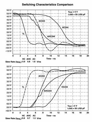

WDC specifies that the rise/fall time for the Ø2 clock should not exceed 5ns. That's generally not achievable with 74HC logic.
PostPosted: Thu Nov 25, 2021 10:13 am

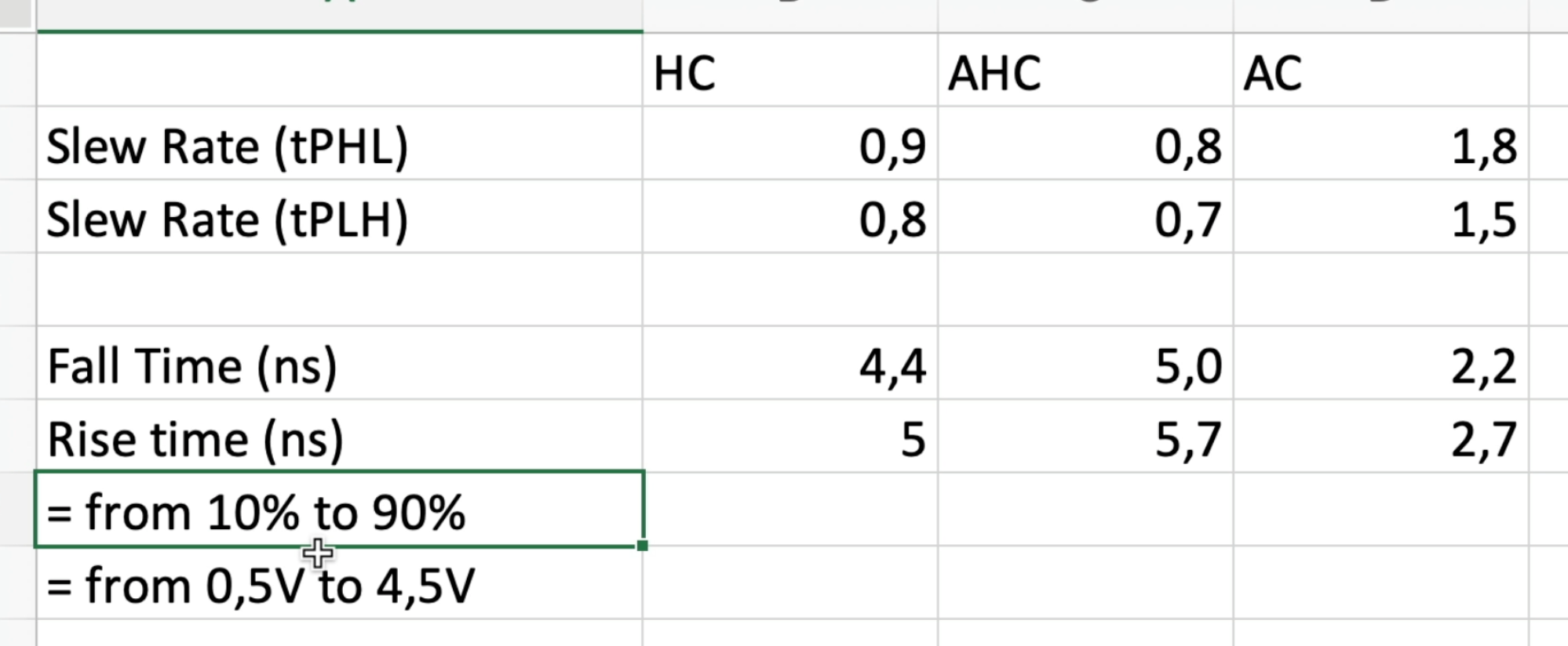

Interesting, I was investigating this number and found this AHC/AHCT Designer’s Guide from TI that shows the slew rates of HC, AC and AHC gates:
Based on these numbers and assuming a 10% to 90% rise I'm getting the following rise/fall times, which shows HC being ≤ 5ns.
Do you have another source I could look at that point to the contrary?

They seem to be tunnel-visioned on the '244 and '245. If you look at their data sheet for the 74HC74 (which you're using in your clock circuit), table 6.6, you'll see a max transition time of 13ns @ 6V and 25°C, up to 22ns @ 4.5V and -55°C to 125°C, both with a load capacitance of 50pF which is probably in the ballpark for what you'll be driving with it. It might work, but it's definitely not guaranteed to.

As Garth said, TI used a single piece of logic (the '244) as an (atypical) example. The slew rates they tabulate in that graphic don't agree with the curves and in the case of 74HC, I know from observation and experience that a slew rate of ~5ns rail-to-rail not attainable in a practical application.
Although I mostly recommend the use of 74AHC logic with new builds—the prop times are comparable to 74AC, but slew rates are less aggressive, the clock generator flip-flop is an exception—74AC continues to be my choice there. Some series resistance between the flop's outputs and the rest of the circuit can mitigate ringing, which may be a significant problem on a breadboard. I've found 100-120 ohms is usually sufficient. A pair of fast Schottky diodes on the outputs may also help suppress ringing, although resorting to that technique usually isn't necessary on a well-designed PCB.
Do you think different gates in the same family can have varying output characteristics? I was assuming they didn't.
Interesting point about that transition time. I've since then switched to a 74HC151 as output driver but the figure is comparable. I might have to go to a 74AC151 then, even though that one doesn't have a published transition time figure...

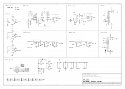

Next, in Episode 11 - Clock Module #3, I went back to the clock circuit and added glitch-free clock switching. By relying on the property that my clocks have vastly different frequencies, I'm able to ensure I always switch when a low-cycle of the destination clock begins and overlaps with a low cycle of the active clock. For that, I used a chain of negative edge triggered JK flip flops. I also had to change my output stage to a 74HC151 multiplexer, which is nice because it keeps the inverted output I had on the 74HC74
I also added a dip switch to select which clock mode and speed the circuit boots in on power up, so I can change it based on what I'm doing (hardware, software...)
Here is the current clock circuit
Next episode will be about starting up the CPU (finally, yay!) using a NOP generator.

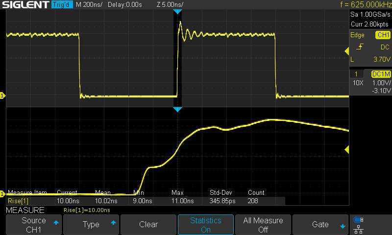

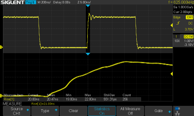

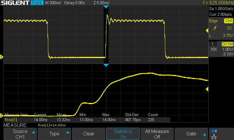

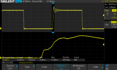

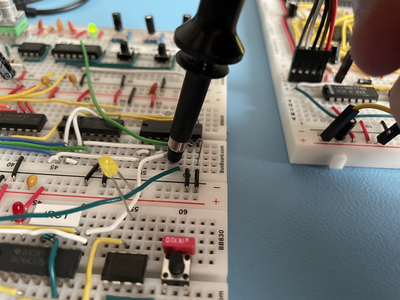

I have done some measurements on rise times, to compare a 74HCT151, 74AC151 and 74AC151 + 100 ohms series termination. My oscilloscope might not be good enough for this measurement (100MHz bandwidth), so take this with a grain of salt:
File comment: 74HCT151
File comment: 74AC151
File comment: 74AC151 + 100 ohms termination
Looks like switching to AC reduces the rise time a bit (14ns->10ns) but then adding termination increases it (10ns->20ns).
How much should I trust these measurements? Probably not much based on the bandwidth of my oscilloscope and the fact that this is on the breadboard?
