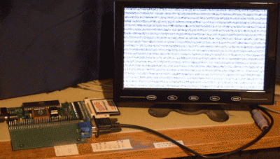

Returning to this topic because I've learned a few tricks in the last few years and it is slowly dawned on me that I can trade speed for hardware complexity. W65C02 can run reliably at 25MHz so it is time to take advantage of that capability to reduce the complexity of hardware.
In my first attempt with VGA beam racing, I wanted a capable serial port but had to sacrifice the CF function to fit the logic in the small CPLD. The idea now is to simplify the serial function to the simplest bit-bang implementation and keep the CF function. In fact, the plan is to expand the memory to 2 banks and find a way to have PS2 keyboard function as well. I can have it all if I keep it simple but paid with degraded performance and more memory.
Enough about ideas, here is what's possible: CF interface, 640x480 VGA, bit-bang 115200N82 serial and possible PS2 keyboard. The modifications to the existing CRC65 is minimum, most of the changes are in the CPLD which is 77% utilized and there is one spare pin to drive 2nd bank of memory.
It still takes 90% of CPU and 40K memory to paint the 640x480 screen. Swapping in 2nd bank of 40K should alleviate the memory shortage. I have to work with the remaining 10% of 25MHz 6502, or a 2.5MHz 6502.
CF can supply the graphic files instead of uploading them serially. I'm exploring different fonts right now. It seems to me 30 rows, 80 columns of 8x16 fonts is a good fit.

I have a nasty tendency of juggling too many balls, so I'll document what I've done before it got dropped. The VGA65Rev1 design is based on CRC65 with slight pcb modifications to add a VGA connector. The modifications are repurposing the 2-wire I2C interface plus address-11 for VGA's VSync, HSync, and pixel outputs. The pixel output drives VGA's R/G/B inputs through 330 ohms resistors. HSync output is also tied to 6502's interrupt.
CPLD design changes are more radical, but the design actually becomes simpler. It is designed in schematic and easy to understand. The hardware serial receiver is replaced with bit-bang serial receive to free up resources for VGA logic. VGA logic is a shift register that loads data in address ranges $4000-$EFFF; a HSync generator that's a modulo-800 counter and assert HSync for 100 clocks every 800 clocks. HSync is connected to 6502's interrupt and also suppresses the pixel generator output when active. The latest addition is a semi-automatic VSync generator that's triggered by software at the end of active 640x480 scan. This frees up software from counting HSync and generating VSync during the vertical retrace period. The VSync generator also has a modulo-45 counter output that's readable by software to see how much time is left.
The "displaying an ASCII spiral" software is a good template for VGA controller software. It loads standard.F16 fonts in memory $800-$FFF. The main program set up HSync interrupt handler and initialize some common variables then sit in an endless WAI loop waiting for 31.5KHz HSync interrupts. Interrupt handler is splitted into active displaying of 640x480 video from memory $4000-$EFFF or vertical retrace phase where task can be processed without worrying about every 31.5KHz interrupt. There is a 3-second delay before any video activities because my VGA monitor takes about 2 seconds of stable video signals to turn on the display.

Built up another CRC65_prototype modified as a VGA controller. I managed to find another spare I/O pin by externally derive compact flash chip select using a 7474 flip flop. So now I have enough pin for PS2 keyboard as well as 2nd 44K memory bank ($4000-$EFFF). This is a barebone standalone 25MHz 6502 computer with serial port, CF interface, PS2 keyboard, and 640x480 monochrome VGA. It is not a pampered hardware with I/O data nicely formatted and presented to it on a silver platter; it has to bit bang serial, PS2, and chase VGA beam to display data on screen. The poor thing is working 90% all the time just to keep up with the regular housekeeping functions dealing with display and basic I/O.
Currently it can serially load and run programs via TeraTerm and display image on VGA display with data from memory or CF disk. I'm testing the PS2 keyboard function now. My immediate plan is a monitor that receives input from keyboard and displays it on VGA. I want to find out what it can do with the 10% of leftover throughput.
