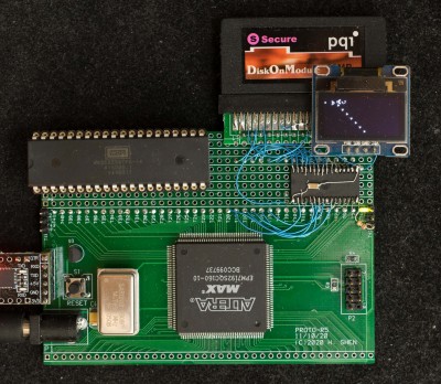

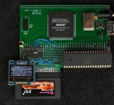

There are two spare I/O pins remained on the prototype area, just enough to make an I2C interface. I still want to reserve most of my remaining CPLD resources for video, so I created an new I/O address, 0xEFF0 and added two flip flops, one drives the SDA signal and other drives SCL signal of I2C bus. Another word, a minimalistic bit-bang I2C interface.
Physically, I added a 4-pin header with pin assignments match that of 128x64 OLED display widely available on eBay.
Algorithmically I've done 128x64 OLED display with Z80 assembly, so it is a matter of porting Z80 code to 6502 which is a good exercise in learning 6502 assembly. Addressing table using a 16-bit pointer on zero page is definitely a new concept!
The attached picture is 128x64 OLED display on Proto65 rev0.1. I also want to port Conway's Life to compare the performance of 22MHz Z80 to 14.7MHz 6502. Another idea is 14.7MHz 6502 should be able to bit-bang out the 1/3-2/3 pulse width modulation in 800KHz chip rate to drive the addressable RGB LED, WS2812B. So maybe I can have more fun playing with the RGB LED array.

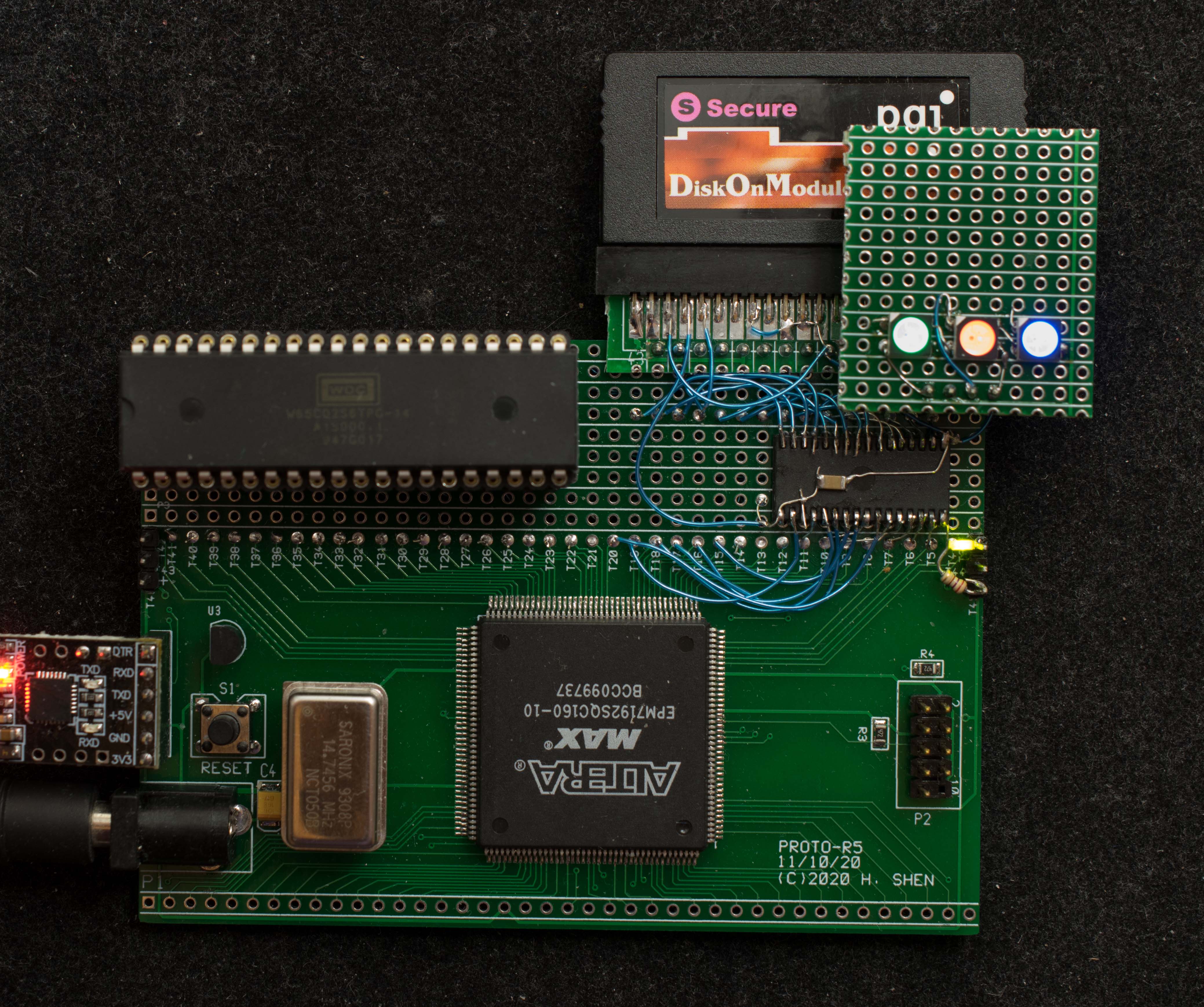

I built up a prototype board with 3 WS2812B RGB LED connected in series (Dout of LED connects to Din of next LED). The Din input of the first LED is driven with the output of bit-bang register, the same register that drives the 128x64 OLED display. The WS2812 data sheet specifies a nominal pulse width of 1/3-on, 2/3-off for a zero, and 2/3-on, 1/3-off for a one. The chip rate is nominally 800KHz. The tolerance for above spec is quite loose, so I figure I can use 6502 to bit bang out a rough approximation of the PWM codes.
6502 is running at 14.7MHz, so it is roughly 70nS per clock. Ideally each bit-loop should be 18 clocks (816KHz chip rate) where zero is represented by 6 clocks of high pulse and one is represented by 12 clocks of high pulse. I don't actually know how to write such software, but I find this little routine worked where zero is 6 clocks, one is 11 clocks and a chip is 20 clocks long. I welcome suggestion for making the timing more accurate.
In the attached picture the RGB LED are barely turned on, otherwise it will completely wash out the rest of the picture. Early on I made several coding mistakes that caused all 3 LEDs to turn full on; they were so bright, I have to close my eyes and grope around to remove the power.

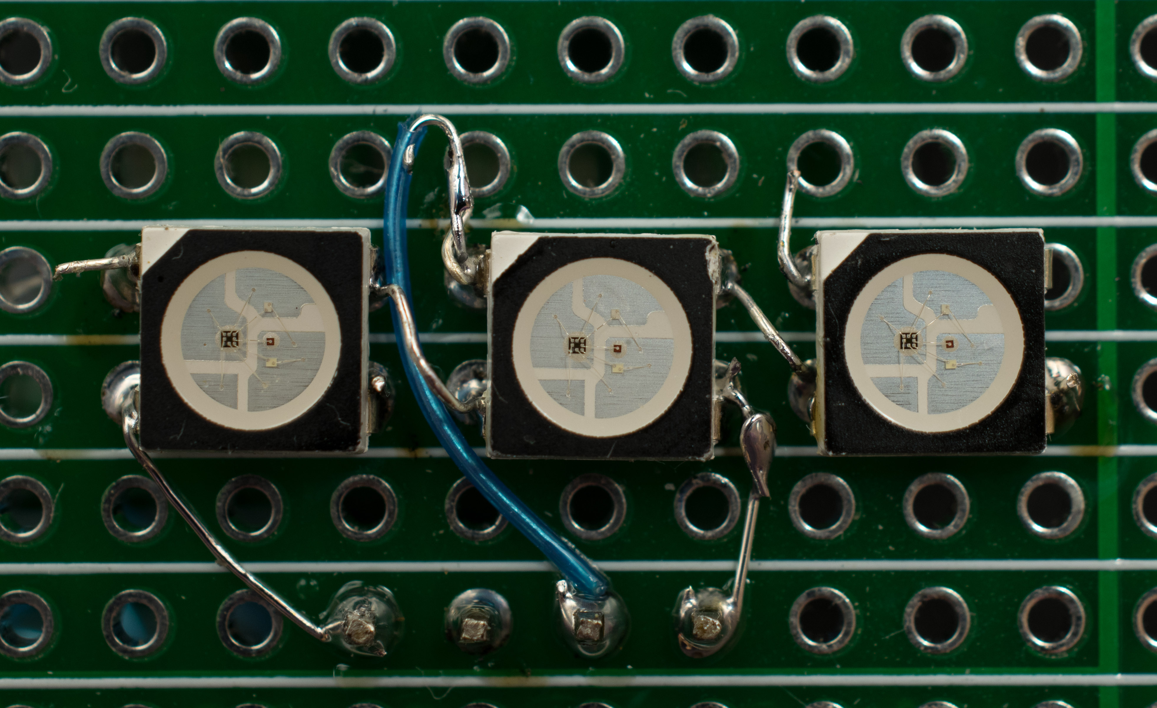

I took a close up picture of the LED and you can clearly see the 3 separate red/blue/green LEDs and the controller chip. It is quite an amazing technology and cheap--LED is about 10 cents each in quantity of 100 from eBay.

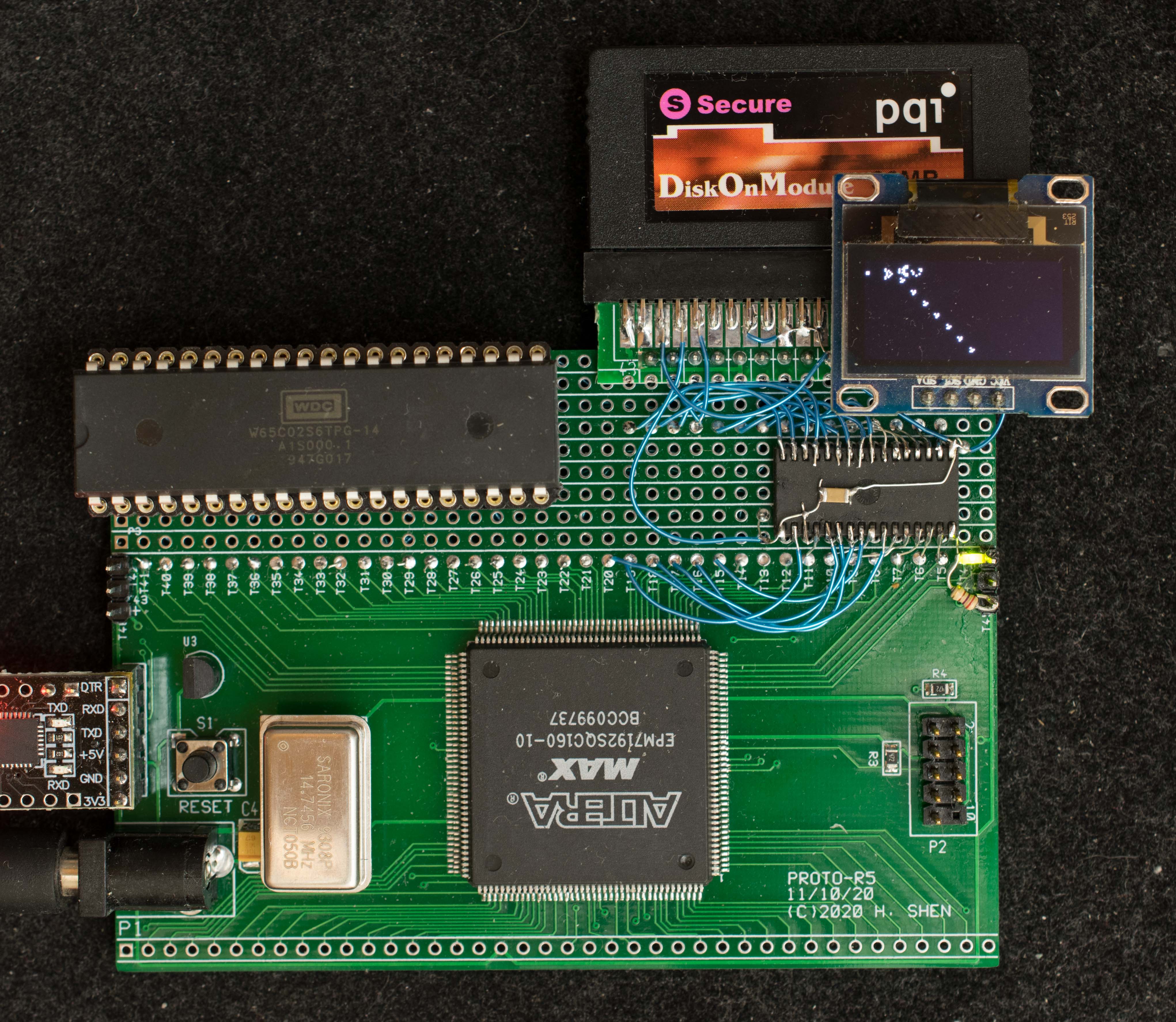

I have Conway's Life running on Proto65's 128x64 OLED display. This is a photo of Gosper glide gun reaching the edge of the screen. It takes about 39 seconds for the first glide gun to reach the edge. Similar software running on 22MHz Z80 took 48 seconds, so for this application the 14.7MHz 6502 is about 20% faster than 22MHz Z80. The 6502 software is ported from the Z80's code, but I have to work around the smaller register set and simpler instructions of 6502. I am still learning 6502 assembly so I should be able to optimize the code more. Zero page pointers are quite an interesting feature that I'm still trying to figure out how to use more effectively. I also think I have a loose pointer somewhere that is trashing my program intermittently.
