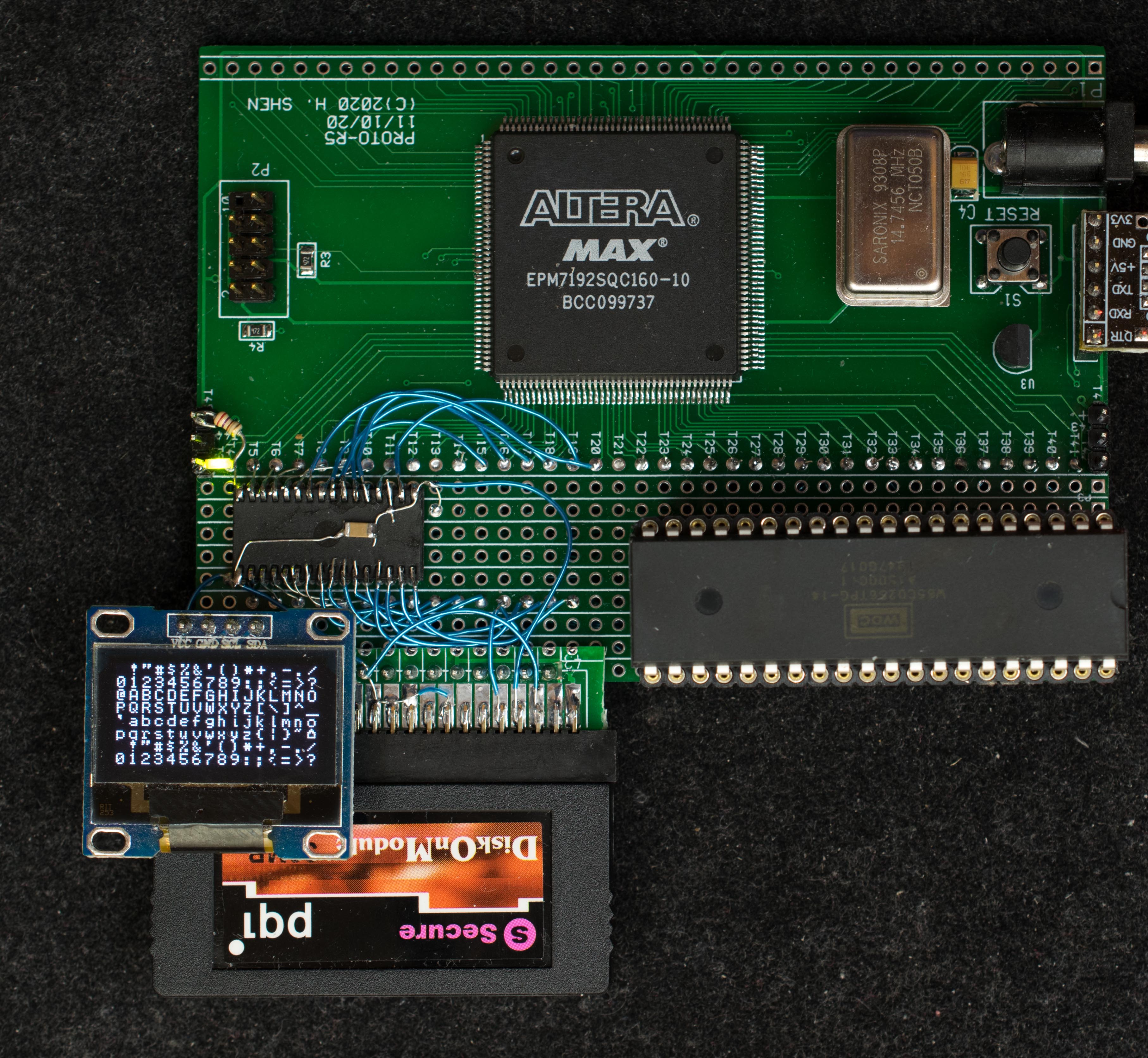

PostPosted: Sat Jan 02, 2021 2:30 pm
Posts: 1076
I'm facing with several options on this New Year Day 20201; (1), I can work on a monitor for rev0.1 to shed much needed visibility to the inner workings of rev0.1 hardware; or (2), I can plow ahead with rev0.2 development which is adding VGA/keyboard capability; or (3), I can capture the rev0.1 and the planned rev0.2 designs and layout a pc board. In a nutshell, (1) is what I SHOULD do, (2) is what I WANT to do, and (3) is INSURANCE in case I screwed up (2).
Having thought about the three options, I decided on option (4), have FUN!
There are two spare I/O pins remained on the prototype area, just enough to make an I2C interface. I still want to reserve most of my remaining CPLD resources for video, so I created an new I/O address, 0xEFF0 and added two flip flops, one drives the SDA signal and other drives SCL signal of I2C bus. Another word, a minimalistic bit-bang I2C interface.
Physically, I added a 4-pin header with pin assignments match that of 128x64 OLED display widely available on eBay.
Algorithmically I've done 128x64 OLED display with Z80 assembly, so it is a matter of porting Z80 code to 6502 which is a good exercise in learning 6502 assembly. Addressing table using a 16-bit pointer on zero page is definitely a new concept!
The attached picture is 128x64 OLED display on Proto65 rev0.1. I also want to port Conway's Life to compare the performance of 22MHz Z80 to 14.7MHz 6502. Another idea is 14.7MHz 6502 should be able to bit-bang out the 1/3-2/3 pulse width modulation in 800KHz chip rate to drive the addressable RGB LED, WS2812B. So maybe I can have more fun playing with the RGB LED array.
