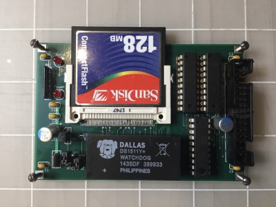

Re: CF-Card/RTC adapter
Posted: Sat Feb 20, 2021 3:05 pm
by floobydust
The new PCBs came in the other day... they look very nice. I decided to the build the first one up... and it fired right up... well, not literally, but it's working fine. I'm still working to finish up the loadable utility program for the adapter, but I have a BIOS and Monitor version that have been working very well, so that code along with the updated hardware design and description will get added to my Github account shortly.
Here's a pic of the new adapter and the Pocket SBC it cables to... using a short (around 1") 30-pin cable.
Posted: Fri May 21, 2021 3:22 am
by enso
floobydust: that looks really good!
Why did you decide on CF as opposed to say SD (basically an SPI interface vs. all those pins)? Not at al a criticism of any sort - genuine curiosity.
Posted: Fri May 21, 2021 9:50 pm
by ashtons
What parts are you using? I can just barely see the logos on the 3 smaller chips, but nothing else.
Posted: Sat May 22, 2021 2:35 am
by floobydust
The full details, schematic, PCB layout, etc. are all on my GitHub repository.
In short, there are two 74HC573 octal latches. These form the 8-bit data I/O latch for the upper 8-bits of the 16-bit data path to/from the Compact Flash card. The third chip is an Atmel ATF16V8 PLD. This is the single glue logic that decodes and logically provides the drive signals for the pair of octal latches and the chip selects for the CF Card and the RTC.
Note that there are also dedicated read and write signals which are provided from the host board, which is the C02 Pocket SBC. I would suggest you take a more detailed look at both of the projects on my GitHub page... all of the details for everything are there... full schematics, PCB layouts, etc. and all of the software to make everything go, including the code for the PLD devices.
Any questions, just ask of course... also, perhaps share your schematic. That would make it easier for me to give you some guidance on how to add this adapter to your system.
