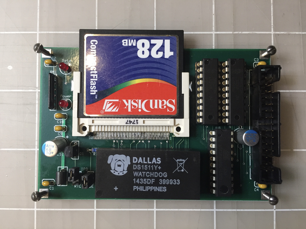

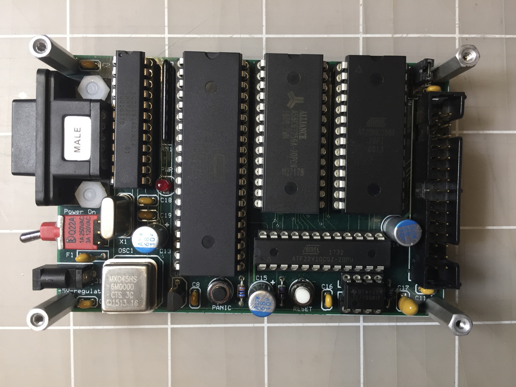

The new PCBs came in the other day... they look very nice. I decided to the build the first one up... and it fired right up... well, not literally, but it's working fine. I'm still working to finish up the loadable utility program for the adapter, but I have a BIOS and Monitor version that have been working very well, so that code along with the updated hardware design and description will get added to my Github account shortly.
Here's a pic of the new adapter and the Pocket SBC it cables to... using a short (around 1") 30-pin cable.
and the BIOS/Monitor code
Re: CF-Card/RTC adapter
floobydust: that looks really good!
Why did you decide on CF as opposed to say SD (basically an SPI interface vs. all those pins)? Not at al a criticism of any sort - genuine curiosity.

Thanks Enso,
Deciding for IDE/CF-Card... overall, it was an easier hardware implementation to interface to my C02 Pocket SBC, that's one reason. Software to make it go is another... per below.
I looked at the SD interface that Richard Leary is using with his DOS/65 implementations for the WDC W65C02SXB and Daryl Rictor's SBC2... where it attaches to a 65C22 VIA port. That would be four chips added to an adapter and somewhat more complicated. For the software, it's bit-banging and timings. If you change the CPU clock, you also need to change the VIA timer values or software timing loops, depending on which one you're using. I have Richard's source code for all of this, but the BIOS I wrote to support the CF Card in True IDE mode is smaller and is not dependent on any CPU clocking, provided of course you don't exceed the timings specifications for the interface, which is mostly limited to 8MHz (no wait states).
For the IDE interface, it's well documented, been around quite some time and IDE drives, CF Cards and Microdrives are readily available and quite inexpensive these days. I can use the same BIOS for all of them without any change. I also have a large collection of 2.5-inch IDE drives and a decent collection of CF Cards plus a 340MB IBM Microdrive.
The single PLD chip really simplifies the hardware design, but it could be simplified more if only implementing an 8-bit interface, but I just wanted the 16-bit data port... which does add a bit to the BIOS code, but overall, the BIOS is still quite small... less than 1.75KB. The BIOS supports the SCC2691 UART for interrupt-driven receive and transmit with 128-byte FIFOs, the Counter/Timer for a jiffy clock, a Maxim DS1511Y RTC for Date/Time plus the CF Card in True IDE mode. A fair amount of I/O support in a small ROM footprint. It also has a JMP table at $FF00 for all available functions, which simplifies using it from other programs, like the companion C02Monitor, EhBasic and DOS/65.
The overall performance vs CPU overheard is also very good as the data transfer timings above show. I've just completed some updates to the BIOS, now at Ver 3.04... which I'll post shortly. It fixes a couple minor things and some general source cleanup.

What parts are you using? I can just barely see the logos on the 3 smaller chips, but nothing else.

The full details, schematic, PCB layout, etc. are all on my GitHub repository.
In short, there are two 74HC573 octal latches. These form the 8-bit data I/O latch for the upper 8-bits of the 16-bit data path to/from the Compact Flash card. The third chip is an Atmel ATF16V8 PLD. This is the single glue logic that decodes and logically provides the drive signals for the pair of octal latches and the chip selects for the CF Card and the RTC.
Note that there are also dedicated read and write signals which are provided from the host board, which is the C02 Pocket SBC. I would suggest you take a more detailed look at both of the projects on my GitHub page... all of the details for everything are there... full schematics, PCB layouts, etc. and all of the software to make everything go, including the code for the PLD devices.
Any questions, just ask of course... also, perhaps share your schematic. That would make it easier for me to give you some guidance on how to add this adapter to your system.

Well, replacing a 65(C)51 with a SC28L92 should be fairly trivial from a hardware side. I replaced a 6551 with a SCC2691 (earlier NXP/Philips UART) which has the same basic hardware differences. Software is more involved, but you can easily start with my BIOS that supports the SCC2691... some minimal changes will run a single channel of the 28L92.
I suggest you configure the 28L92 for Intel mode, not Motorola mode. You will need to provide phase 2 clock qualified /Read and /Write signals, which are the same as /OE and /WR for static RAM and a positive going Reset signal. The Reset can be easily done using a TI TL7705 (or inverting your existing /Reset signal). Details on this can be found on my C02 Pocket SBC, which uses it.
Good luck as you proceed on your project... there's lots of expert help out here on the forum!
