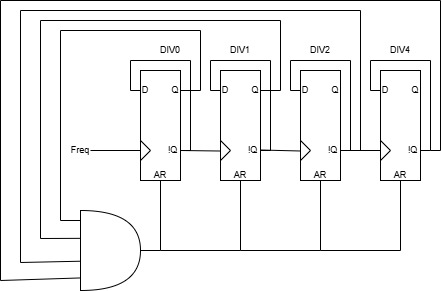

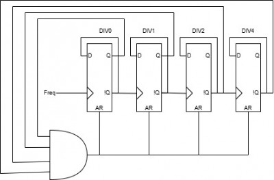

Hi guys.
Thanks for your help, I have a new issue.
I got the XGecu 76, and have programmed a V750, but it only has 1000 erase cycles, so I'm relying on the simulator first.
I was asked not to open new threads, just respond to this. So here goes...
Goal: Make a counter using D FF's, which can reset at an arbitrary value.
Problem: The AR extension doesn't work as expected.
The full size counter will be 10 bits, but to begin with, I want to do something that I can reasonably simulate, so I used 4 bits. And how high the counter reaches will be set using inputs, so a 10 bit counter would need 1024 states, so a state machine isn't an option. (I might be able to reduce it to 125 selected states, but still... :shock: )
Here is the logic diagram, using D-FF's. When the AR line is disabled (set to 0 in code - see where it's commented out) it counts 0-15 and wraps, as expected.. Note that AR is ANDed with Q from the first two FFs, and !Q from the second two FFs, so AR goes active at "3".

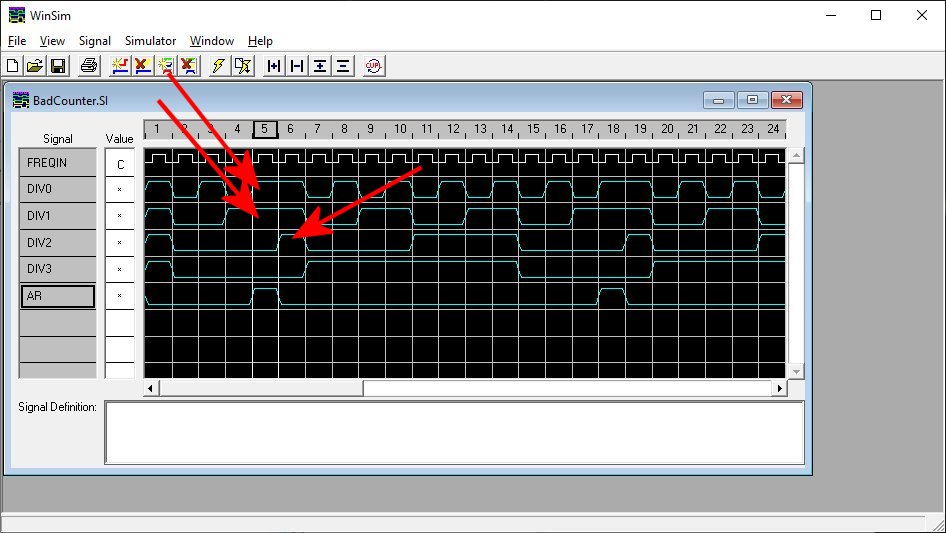

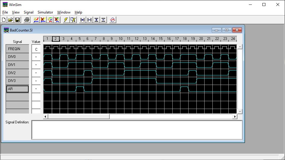

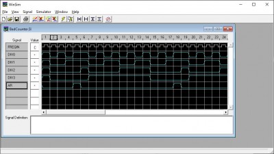

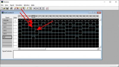

But with the AR line set to trigger when the counter reaches 3, it is not working as expected.
I would expect that all FF's would reset to Q = 0.
The simulator output, with Column 2 = Count 0, Column 3 = Count 1, ...
Note that when the count reaches 3 in column 5, the following:
DIV0 and DIV1 are high, DIV2 and DIV3 are low, so AR went high as expected.
On the NEXT column 6 (clocked) DIV0 and DIV1 are still high, and DIV2 went high.
So all is did was prevent the AR from clearing any register, so now the count jumped to 7
Then on column 7, the count is now 8
Further along, on column 15, everything is low, and it starts over again (AR is active on count=3, but the FF's do not reset)
I narrowed it down to the point where it fails to reset, it ALWAYS turns on first "DIVx" that is set to use the inverted FF output as the input to the AND gate.
( i.e.
AR = DIV0 & DIV1 & DIV2 & !DIV3;
turns on DIV3 on the 7th clock, and fails to turn off DIV0..DIV2 )
I have tried variations such as clocking the AR line with the input frequency, changing to active low, etc... I cannot figure out what it is doing, why the AR line is not actually doing a reset.
Any advice would be appreciated.

Posts: 3526
Re: sanity check - ATF16V8BQL
It might be helpful for you to reacquaint yourself with the difference between a ripple counter and a synchronous counter. Your diagram shows a ripple counter, which is called that because the various FlipFlop outputs don't change state simultaneously; instead the changes "ripple" (with a small delay) from one FF to the next.
This ripple effect can cause all sorts of glitchy problems. Work-around solutions do exist, but they're not always satisfactory. For your goal, it is probably more appropriate to construct a synchronous counter instead. All the clock inputs of all the FF's will attach together, and that's why those Q outputs which change state will do so simultaneously.
I know you don't want every FF to change state on every clock pulse, and therefore it may seem counterintuitive (uh, pun unintended :oops: ) that all the FFs would receive the same clock signal. But there are various ways to cause the FF to change state or not, as desired. Either manipulate the data presented to the D-type FF's input, or replace the D type FF with a T- or JK-type. Just some hints, but I hope you find them helpful!
- Jeff
Posts: 9428
scotty2541 wrote:
Goal: Make a counter using D FF's...
Funny coincidence!  I was going to suggest the exact same thing.  :D
Scotty, something to note in programmable logic: when you use pins as feedback nodes, as you are doing, each such node adds a maximum of tPD nanoseconds to total prop time through the chain.  This characteristic inherently makes your counter a ripple counter.  As Jeff notes, you need to clock all flops from a common source in order to make the counter synchronous.
You are encountering one of the limitations of GALs and why CPLDs and their buried logic displaced GALs from applications that have strict timing deadlines.
...the various FlipFlop outputs don't change state simultaneously; instead the changes "ripple" (with a small delay) from one FF to the next.
That is the effect of the prop delay incurred by using pins as nodes.  As I noted above, each node will cost you up to tPD ns—and that cost is not guaranteed to be consistent from node to node.
I know you don't want every FF to change state on every clock pulse, and therefore it may seem counterintuitive (uh, pun unintended :oops: )...manipulate the data presented to the D-type FF's input, or replace the D type FF with a T- or JK-type. Just some hints, but I hope you find them helpful!
Of Jeff’s two suggestions, the former will be less difficult in a GAL.  Synthesizing a JK- or T-flop is a headache, in my opinion.  You should be able to use combinatorial statements to control what each D-flop’s input sees on each clock.
