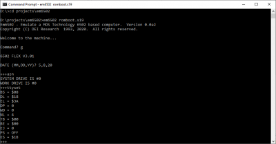

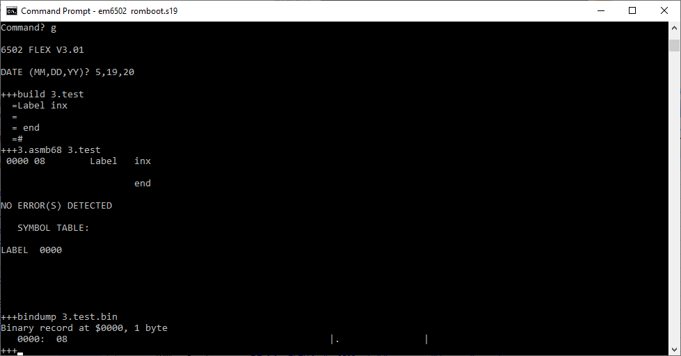

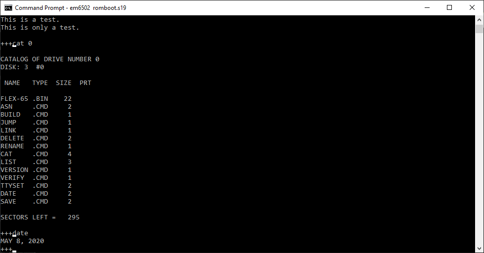

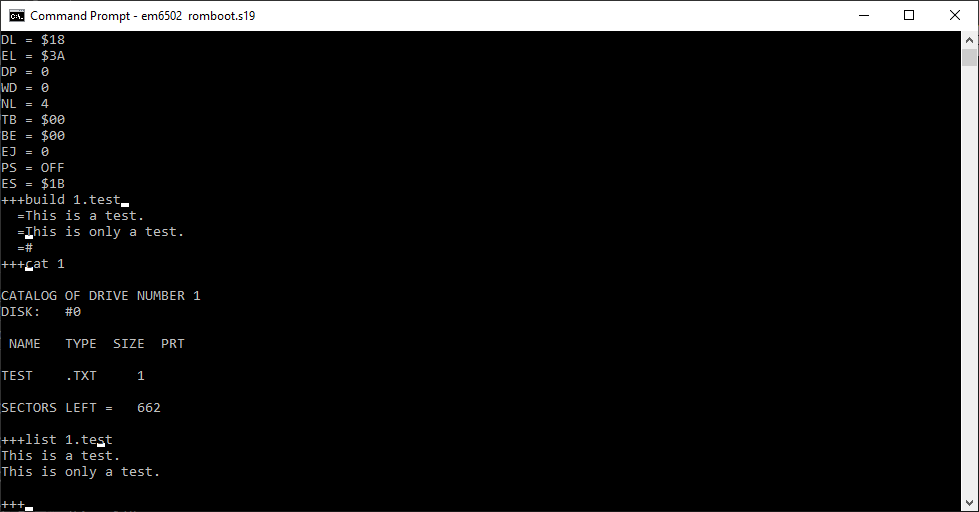

Any chance of seeing some screen shots of directory listings, etc?

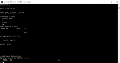

I am now able to cross assemble most inherent 6800 instructions.
While 6800 binary files currently have no value on a 6502, this means that a large part of the fundamental infrastructure of the assembler is working.

This project is now two months old.
The FLEX file system (File Management System or FMS) is still lacking the code for writing random access files until I can come up with a good way to test it. I may go ahead and write the code but leave it disconnected to get an idea how big it is likely to be.
The FLEX user interface portion is feature complete except for background printing. Again, I may write the code to find out how large it will be. The error message reporting mechanism is complete.
There was little progress on the Utility Command Set this month. The SAVE utility has been written, but not thoroughly tested.
The 6800 assembler now runs on the 6502 as a cross assembler. To help test it, I have started implementing the text editor. It can currently create a text file and make some simple edits to it. The editor is definitely more difficult code than the assembler has been.

Yes, it has been developed so far only using emulation.
The current virtual hardware is essentially a SWTPC 6800 computer with a 6502 processor instead of the 6800, 56K of RAM (though it will not require that much), an ACIA for a serial port and a WD 1771 for a disk controller.
My intent is to support the Corsham SD card system for mass storage once I figure out how to emulate it. That will likely be the first supported configuration in actual hardware. https://www.corshamtech.com/product/sd-card-system/
Maybe you can be the first?
