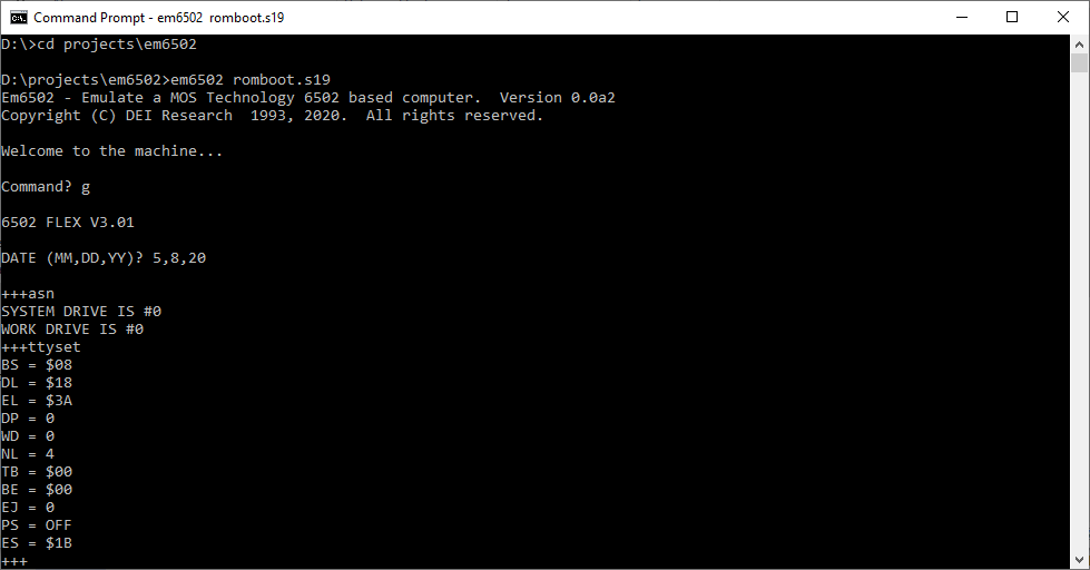

PostPosted: Fri May 08, 2020 7:16 pm
Posts: 8237
Any chance of seeing some screen shots of directory listings, etc?
PostPosted: Fri May 08, 2020 8:38 pm
Posts: 694
Location: North Tejas

I am now able to cross assemble most inherent 6800 instructions.
While 6800 binary files currently have no value on a 6502, this means that a large part of the fundamental infrastructure of the assembler is working.
Next up, evaluating expressions...
