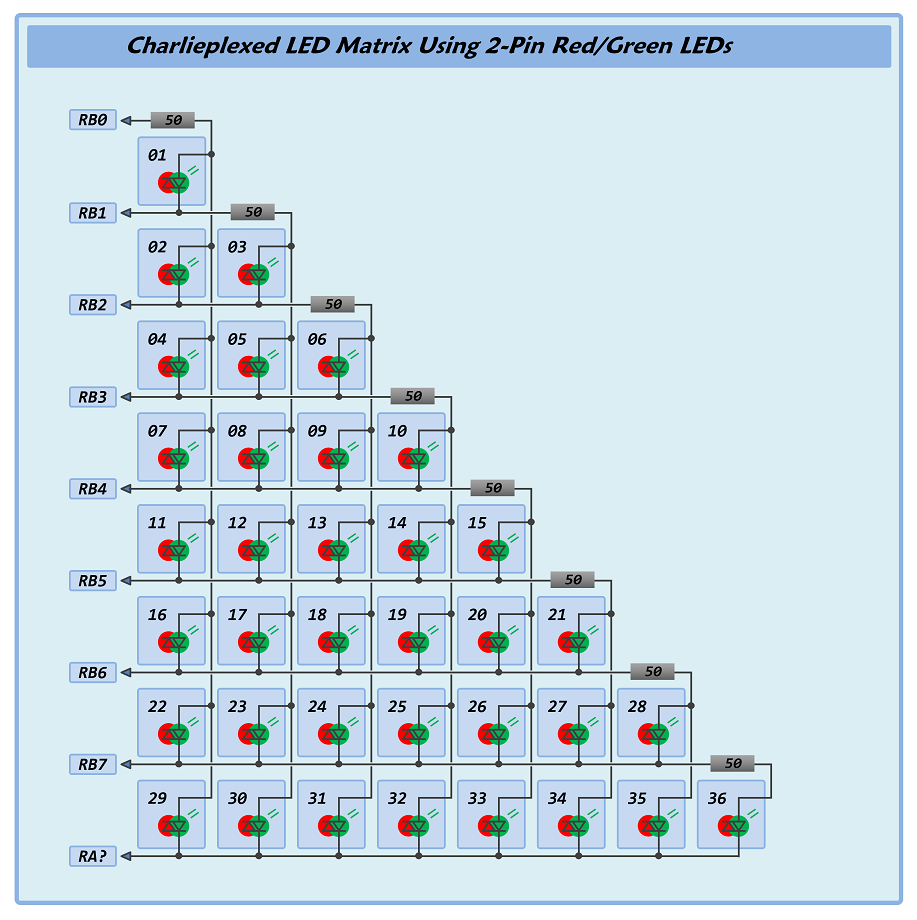

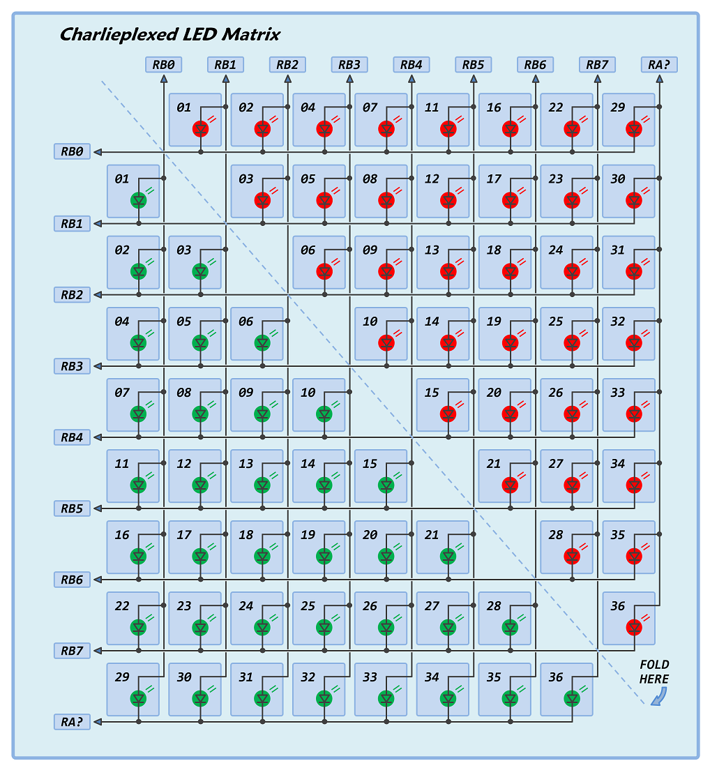

I wonder if a Charlieplexed matrix may be of any use? Plenty of info' available on the 'net so I won't take up bandwidth here (and I'm terrible at describing things). However, it does provide an interesting way to drive the 2-pin Red/Green style LEDs (red, green, yellow?)...

One of the things that LEDs don't really like is being held in reverse bias for long periods of time. Driving them directly between a '138 and a '238 would keep them in reverse bias about 7/8ths of the time.

I found a picture of those Red/Green LEDs though the colors always seem washed out on my camera.
I like Dr Jefyll's '238 + '145 suggestion. I seem to recall the 'LS145 could sink something like 40 or 80 ma current. Reminds me of the KIM-1 display, though the '145 isn't being used as a sinking column driver there...

In this case, I think it's actually easier to use the normal NxN matrix method rather than Charlieplexing. I only need one LED in each ring lit at once, and Charlieplexing requires being able to tri-state individual pins as well as driving them in either direction, which effectively requires two bits per pin, which is actually *more* data to get off-chip to the driver circuits. This also avoids the need to reverse-bias some of the unlit LEDs.
Amusingly, the Wikipedia page on Charlieplexing shows a clock with a circular array of LEDs. However, they've done it with only twelve LEDs for the hours; natural hand movement requires fitting more.
Re: [Contest] RIOT Clock
They do function as diodes, but their reverse breakdown voltage is relatively low, and apparently they degrade over time through metal migration if they spend a lot of time in reverse bias. I note that the Charlieplexing wikipedia page talks an awful lot about LED failures (both open and short circuit) and the effects it has on a Charlieplexed display, whereas my experience of LEDs is that they basically never fail when used competently; they may dim a little bit with age, but that's all.

Charlieplexing is often used in a hobby context.
I checked a few random LED datasheets from different manufacturers. They all have 5V as the absolute maximum reverse voltage. For that reason alone, I would never use this technique in a 5V system. Cree's datasheet (C503B-BCS, blue and green 5mm LEDs) went further and had a warning that continuous reverse voltage can damage the LED.
Doesn't Charlieplexing rely on the LED forward voltage being more than half the supply? If you're running at 5V, that rules out red, yellow, and some green LEDs.

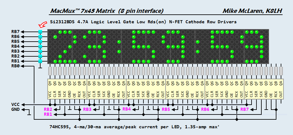

Gosh, there's so many ways to drive a bunch of LEDs. With only 3 LEDs on at one time you could easily mux' a small matrix at a nice leisurely 33% duty cycle using inexpensive serial-to-parallel ICs (and you might not need column or row driver transistors???). My MacMux method (example below) would re-task the row driver pins for use as a CLK and DAT lines to load the shift registers in parallel (a 6 channel SPI of sorts) during a short blanking interval at the beginning of each mux' interval (when PWM on RB0 goes high). The driver code was relatively small and fast, using only 24 PIC instruction cycles to load the shift-registers from an 8-byte mux' array, and a bit more code after updating the display (a 'data bender') to prep' the mux' array for the next mux' interval. With a MacMux driver and 8-pin interface you would only need three (3) shift-registers to drive 120 LEDs but I'm not sure how you might implement PWM brightness control on the 6507/6532.
Anyway, food for thought. Good luck on your project. Cheerful regards, Mike

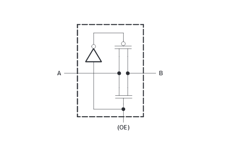

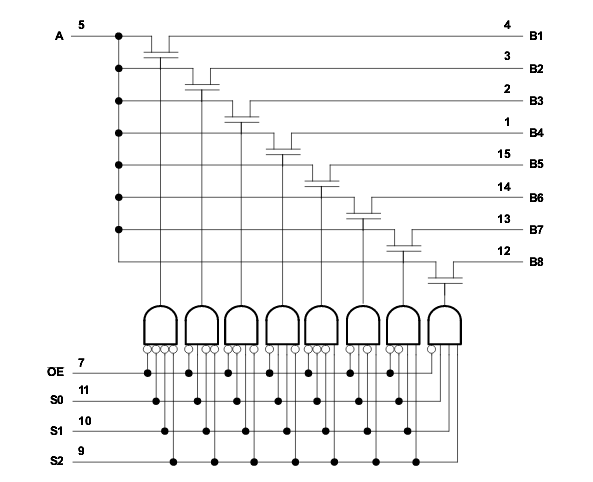

Best of all, you can attach the common node ("A", pin 5) to an intermediate voltage of your own choice -- IOW it's not an all-or-nothing decision of 0 volts or +5. (AIUI this version can't quite pull all the way to Vcc anyway, only to one threshold voltage below; but for driving LEDs that shouldn't be a problem.) You'd attach the common node to whatever supply you deem appropriate. Besides limiting current, you could also limit voltage, thus granting a safety margin in regard to the worrisome LED reverse-voltage spec mentioned upthread.
This device might also deserve consideration as the "6 switchable sources per ring" mentioned in the quote above.
-- Jeff PS- FWIW, the other version, 74CBTLV3251, can pull all the way high or low, thanks to the use of complementary FET's. But the LV version is not rated for 5V operation.

Ah yes, I'd forgotten about the analogue versions of the multiplexer chips. But rather than the 3251, I'm thinking of the 4x51 series, which is available in the 74HC(T) series and is thus 5V compatible. I think one of these can also replace most of the discrete transistors in the chime circuit, and I might be able to replace the remaining one with a Schottky diode.
A particularly interesting member is the 74HCT4351, which has latched address lines. This eliminates the need to introduce extra ICs just to latch the select data. The digital-mux equivalent with latching is the '137.
So now I think I can hang both the chime circuits and the high-side display drivers off Port B of the RIOT, bit-banging a small parallel data bus to these latched multiplexers. This leaves Port A free to run the low-side and character display drivers on a serial bus, and receive button-press data.
