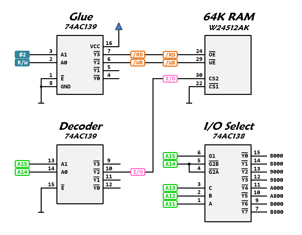

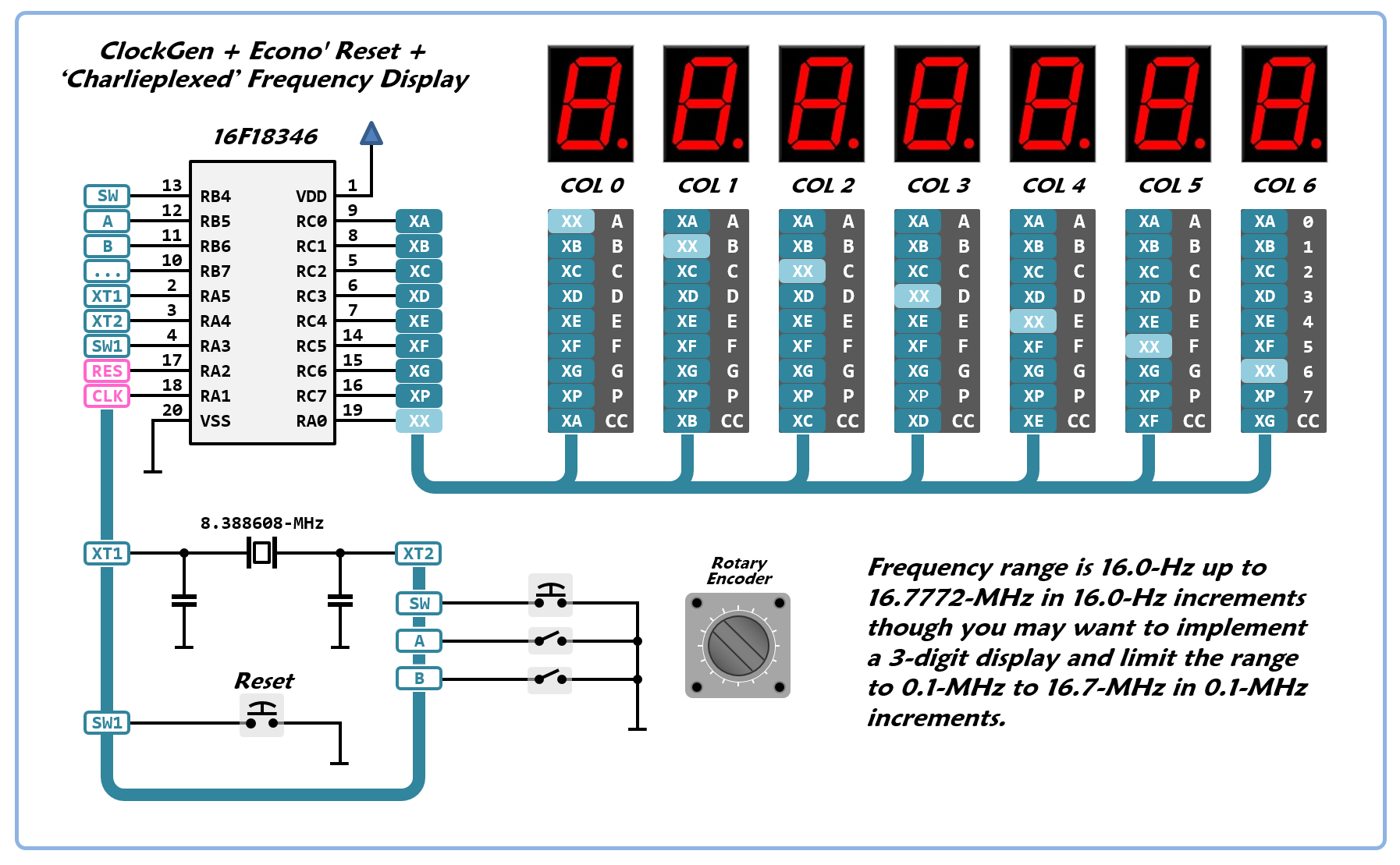

Oh my goodness... Just spotted a big blunder thanks to BDD's comments. Replacing U10a with a pair of 74AC00 gates doesn't really shave anything off the propagation delay, however, driving the 74AC138 directly with the A15 and A14 lines provides a big gain...

dani, I just noticed your PIC 16F628A Frequency Counter in the updated schematics in post #2. If I had known you were familiar with PIC microcontrollers I would have suggested using a PIC for your Adjustable Clock circuit and display early on. Gosh, there are so many different ways you can generate, control, and display an adjustable clock. May I provide an example if your head hasn't exploded yet (grin)? This example would replace the 16F628A frequency counter and eliminate the 74ABT74 and the 74AC14 chips... The crystal is an Epson CA-301 8.388608M-C (DigiKey part # SER3415-ND, $0.83 each) which is used to provide a nice round 16.0-Hz increment for the PIC 20-bit NCO (Numerically Controlled Oscillator) module. If you order one of these crystals, would you get an extra for me, please? Also, I'd be happy to help with the PIC program (and programming if you don't have a PICKIT3 programmer).

Jikes! You've been busy tonight!
It's important, as I want to go as high as possible. Being my first take at an SBC, I won't it to reach too far. Moreover, once I connect my 74HCT6526, I'm pretty sure it will be the limiting factor. Anyway, as Michael pointed out later, going with an 'AC00 may not provide too much benefit. One of my first desings had 3 NAND gates to generate the /CS for the Ram.
Yes, it's active high. Also, I was just going through the datasheet for the LCD and don't think it can go very fast... don't really think it can even do 1 MHz! I may end driving it up with the peripheral ports in the 6522 or the '6526, so I can control its timing via software.
Agreed. All parts should be AC. I didn't pay too much attention at first to the logic family of the ICs and just focused on the logic. I have some early screenshots where I still have some LS ICs

I'm not sure how important performance is to you, but if it were me I'd be using a 74AC00 in place of the 74AC139 (U10). The average prop time of one section of an 'AC00 is about half of the 'AC139. This isn't too important a consideration with U10b, but could matter with U10a.
DrJefyll wrote:
ETA: the output of U9a as wired is an active-high signal. Is that what the LCD module requires? Just checking...
I see a 74ABT74 is being used as the source for /PHI2 and PHI2. That flop should be a 74AC74

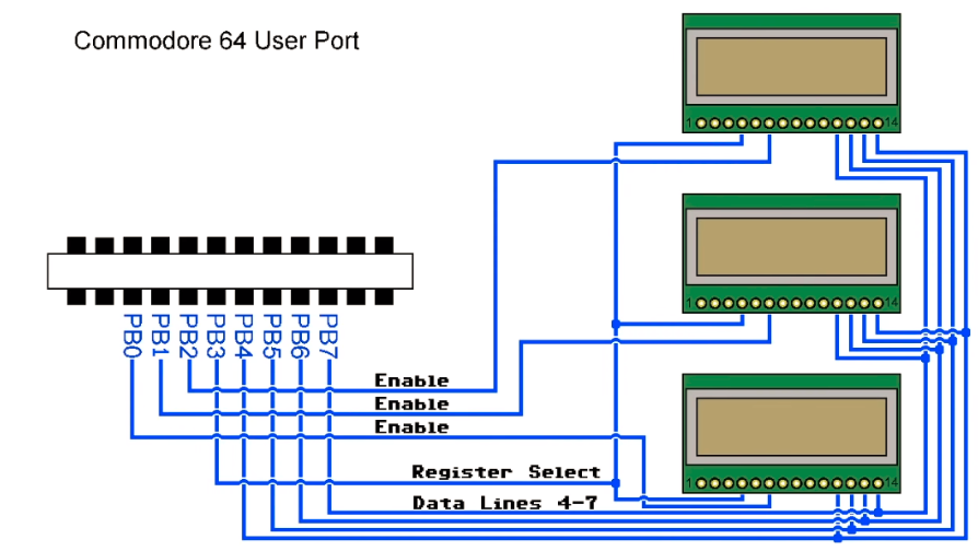

I've seen a video from the 8-bit guy on which he connected an LCD to a C64. First, via the user port (So, driving it with the CIA) then via the expansion port, directly attached to the computer bus. Some glue logic was needed to make it work. He didn't go into details, but I'm guessing some latches maybe?
Anyway, I've attached the LCD to the 6526 PortA. I just feel like a real hardware engineer now. Just passed the issue to a poor software engineer

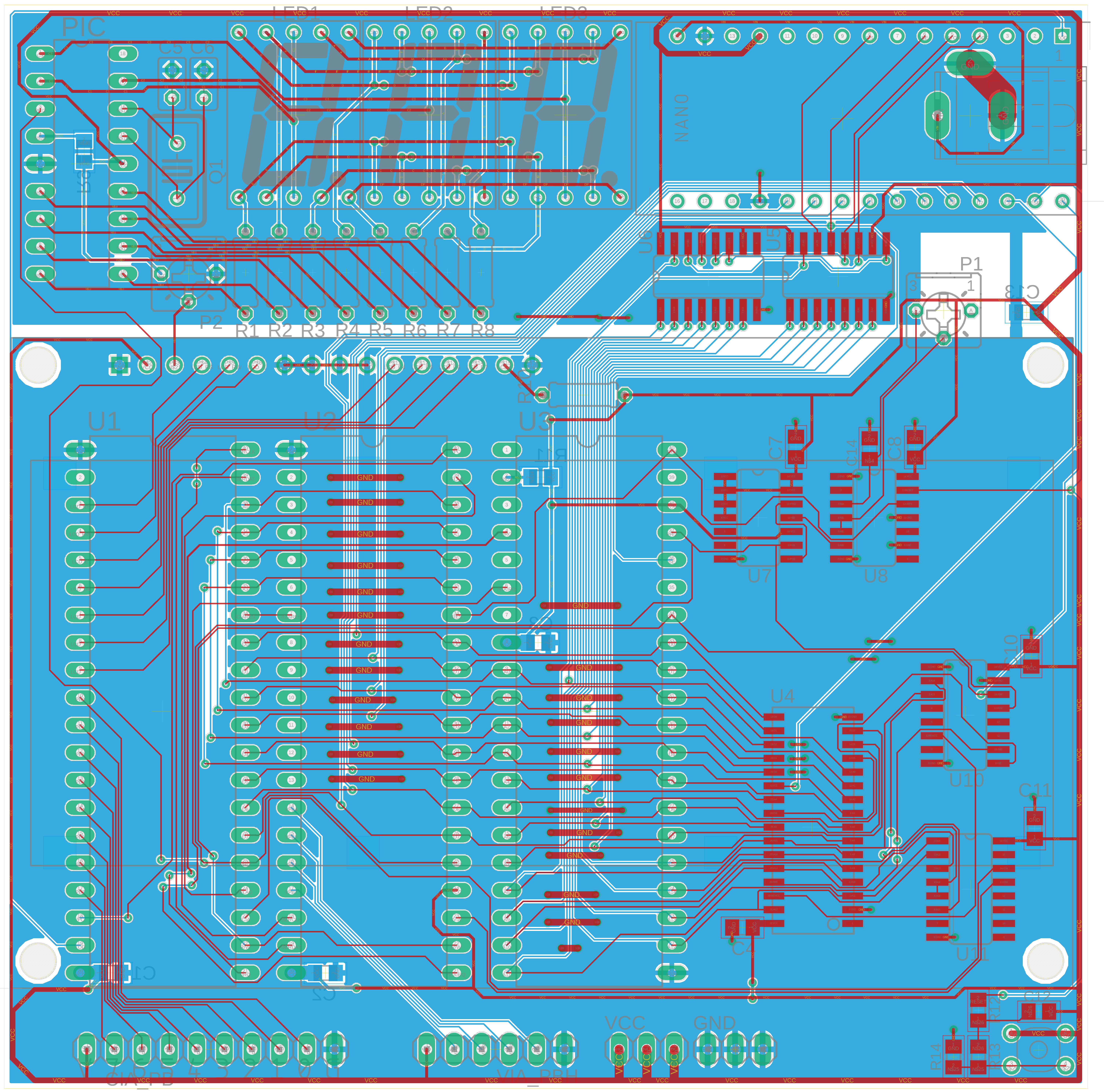

As a bonus, I'm posting my first attempt at the PCB. As usual, 10cm x 10 cm, 2layer board. The cheapest I can have manufactured. If I find it to work at low speeds, I'll probably get a 4-layer version afterwards.

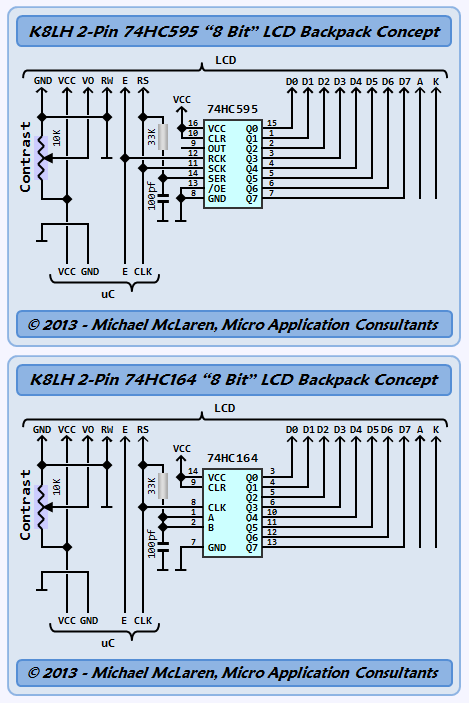

Have you considered using an LCD 'Backpack' of some sort? Serial, I2C, and various shift-register designs have been popular for years. I've even contributed a few designs. I'd like to think I came up with the first 2-pin shift-register backpack design that used 8-bit LCD interface mode (below).

A solution very similar to this is shown, at least an schematic, in the 8-Bit Guy series on LCD screens part 2.
Again, I think this makes for simpler hardware, more complicated software. Everything in this world is a compromise between different variables.
As the hardware is, for sure, my weakest point, at least right now, I'd rather stick with the simplest design. Don't get me wrong, I find your ideas brilliant, and I'm taking good notes of them.

Updated schematics, with just some minor tweaks. A couple of gate swaps to improve on routing, and connected 6526 PB low nibble with 6522 PA low nibble, in the hope of creating a parallel communication port between them, using CA1, CA2, /PC and /FLAG as handshaking signals.
PCB is getting some minor updates too... but I'm pretty much satified with it. Pretty solid ground plane, almost no vias on main signals... and it looks nice too. I have exposed via a header PB4-PB7 from the 6522. I'm thinking about putting 4 push buttons there so I can have minimal input too.
Beside this, I don't expect anything much to happen for the next 3-4 weeks. I'm on the hunt now for all parts, and as they arrive, I'll start some test to validate the design.
