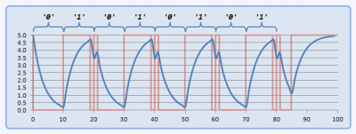

Posts: 589
Have you considered using an LCD 'Backpack' of some sort? Serial, I2C, and various shift-register designs have been popular for years. I've even contributed a few designs. I'd like to think I came up with the first 2-pin shift-register backpack design that used 8-bit LCD interface mode (below).
Cheerful regards, Mike

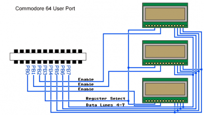

PostPosted: Tue Jan 21, 2020 8:22 pm
Posts: 193
Location: Madrid, Spain
A solution very similar to this is shown, at least an schematic, in the 8-Bit Guy series on LCD screens part 2.
Again, I think this makes for simpler hardware, more complicated software. Everything in this world is a compromise between different variables.
As the hardware is, for sure, my weakest point, at least right now, I'd rather stick with the simplest design. Don't get me wrong, I find your ideas brilliant, and I'm taking good notes of them.
Taking an optimistic note, if the LCD interface is generating the most debate here, that means the rest of my SBC is pretty much OK :lol: :lol:
