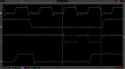

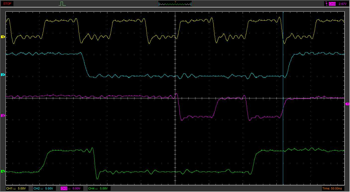

GaBuZoMeu wrote:
Well, I scanned the WDC65C02 (an old one, 2004) data sheet for "compatible" and "replacement" - no finds. Perhaps they knew better ;)
But if using PHI2out make things worse then using an oscillator can for PHI2 for the GAL and delay that PHI2_GAL by one or two buffers and fed it into the µP should make things better - I hope. The GAL signals then are slightly earlier than the "nominal" (=PHI2_µP qualified) signals.
The more I thought about this the more it made sense to me. In essence delaying the clock to the CPU by the same amount as it is delayed in gating a qualified write signal will perfectly align Phi2 and /QW. Just as though there was no timing cost to creating a Phi-2 qualified write (/QW).
Indeed doing this resolved the problem. The board will now (even with a 120ns rated EPROM) run happily at 14MHz.
So it seems that timing with the W65C02, especially in conjunction with ultra fast RAM, is very tight. Just as with the last project where a 12nS delay to the Phi-2 feeding the ACIA was enough to throw it off the rails, in this case a mere 15ns delay in the /QW line was the culprit. I guess not so mere when you compare it to the 15ns access time of the RAM. The combination fast RAM and W65c02 seems to have no 'sense of humor'.
The previous project solution ended up with only a 6ns delay and that is good up to about 17mHz under the right conditions. This solution produces a net 0ns delay between the CPU's clock and the gating of a Phi2 qualified write and will be the solution I use going forward.
Thanks GaBuZoMeu, your intuition was right on the money.
Here is a scope shot of the resulting timing at 10MHz. Please excuse the ringing in the traces - I have verified it is a scope ground issue and does not appear on the board. As before the traces are: Yellow=Phi2 (at CPU), Blue= RAM CE, Red=/QW, Green=DB
@floobydust - There was minimal ground bounce and Vcc glitching. The worst coincided with the RAM /CE signal (as expected). Much less than I have seen in some of my successful efforts. The Vcc glitch was at most about 150mV across the RAM's bypass cap.

That's really interesting: the data hold timing of the WDC65C02 (and presumably that of the 65C816) is so small that a few ns delay - the necessary gating of RWB with Phi2 - is too much. Perhaps a few pF on the data bus may help as well. This was probably not intended by the designer but with slower CMOS processes (> 0.6µ) perhaps never observed.
Glad that I could be helpful.

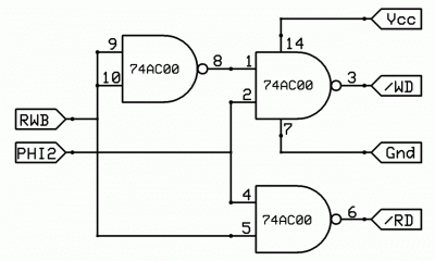

Below is a variation of what I used in POC V1 (all discrete logic). The variation is one section of the 74AC00 is being used as an inverter—an actual inverter was used in POC V1.
Read/Write Qualification
Assuming a 5 volt circuit, each section of the 74AC00 has a propagation delay that will vary from 1.9ns to 6.6ns over the full commercial temperature range. In my design, I worked off the worst-case of 6.6ns, and could boot the unit on a 15 MHz clock, despite use of a 55ns EPROM.
As can be seen, both /RD and /WD will lag Ø2 by one gate delay. This worked out well with the 65C816. The 65C02's read-write timing is like that of the '816, so I'd expect to see similar results.

Interesting.
Actually, you have a 2 gate delay on start of the qualified write which I think is not as critical, but only a single delay at the end. Your write will end 6.6ns after Phi2 goes low. It's this back end that seems to cause the problems.
I'm guessing that the combination of a W65C02 (or other ADC CPU) slower RAM will be a bit more tolerant.
It would be a useful experiment to build up a test bed that had a continually variable delay in producing a qualified write in order to flush out what the tolerances are for various clock speeds and RAM choices.

I endorse the circuit BDD posted, as it's the same arrangement I often use myself. That's assuming the node marked PHI2 is the same node that attaches to the CPU clock input (PHI2, aka pin 37 on a 40-pin WDC 65C02). It should be just fine. I'm not aware of any reason a variable delay should be added, but I haven't been closely following this topic, and may've missing something.
By the way, BDD, I suspect you posted in a hurry, or failed to proofread. I think you know /RD and /WD both lag Ø2 by one gate delay. (It's RWB which incurs two gate delays to /WD -- and the extra delay is inconsequential, since it's PHI2 which will time both the falling and rising edge of the low pulses on /RD and /WD).
As can be seen, /WD will lag Ø2 by two gate delays, whereas /RD will lag Ø2 by one gate delay
Correct assumption. Per WDC guidelines, all timing in my circuits are based solely upon the clock generated by the (earlier published) Ø2 generator. As the 65C816, has no clock outputs, that is the only way an '816 design can be clocked.
By the way, BDD, I suspect you posted in a hurry, or failed to proofread. I think you know /RD and /WD both lag Ø2 by one gate delay...
Yep! As vision in my left eye fades to unfocused blobs of light, I am finding myself making more errors of this type. I try to carefully proofread but seem to be missing a lot as of late. You can only imagine what fun it can be trying to debug a program that won't run due to nothing more than some errant typing. :evil:
The two gate delay on /WD caused by the inversion of RWB should not be a significant timing factor, since during a write cycle, RWB will be driven low before Ø2 goes high. Practically speaking, the gating of /RD and /WD is slaved to the rise and fall of the clock.
The read-write timing for the 65C02 is actually more relaxed than for the 65C816, as the latter drives D0-D7 during both clock phases. My circuit keep peripheral silicon off the data bus during the low clock phase during a read cycle, since the '816 is emitting the bank bits during that time. Here the gate delay inherent to following the rise and fall of Ø2 eliminates (in theory) a potential bus contention issue that is peculiar to the '816 during read cycles.
IIRC, your RAM is running at ~60ns, right?
The RAM in POC V1.1 is 12ns. The RAM in POC V2 is 10ns.
